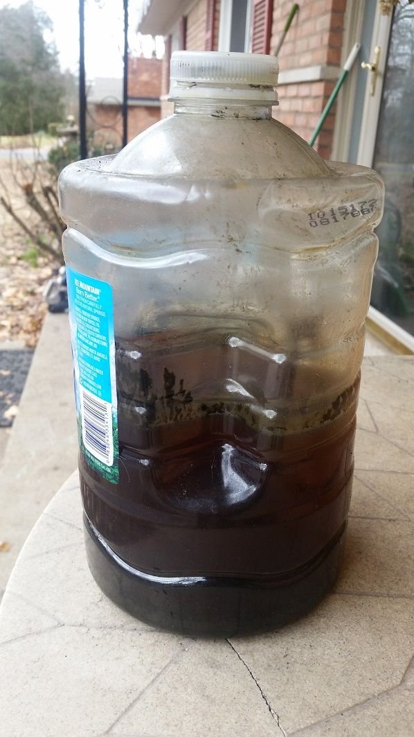

I ended up flushing/bleeding the system and it fixed the problem.
Check out this old fluid!
Thanks again
