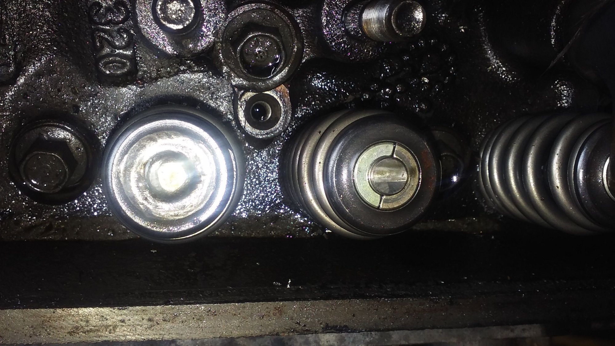

here a Picture of what I'm talking about I'm getting a set of good heads ready to swap out they are being freshen up get them Back Tuesday going to use the same spring order new retainers and locks

Those are the iron heads by the look of it. You want the aluminum heads. 374 or 643 were the better castings. 561 were ok and will get the job done. But try to find some 374 or 643 especially if you want to do port work.
