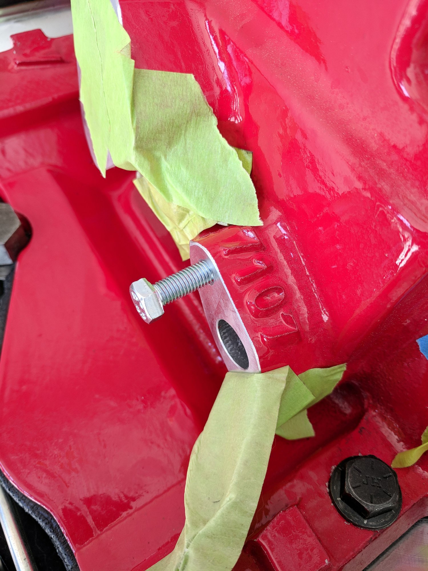

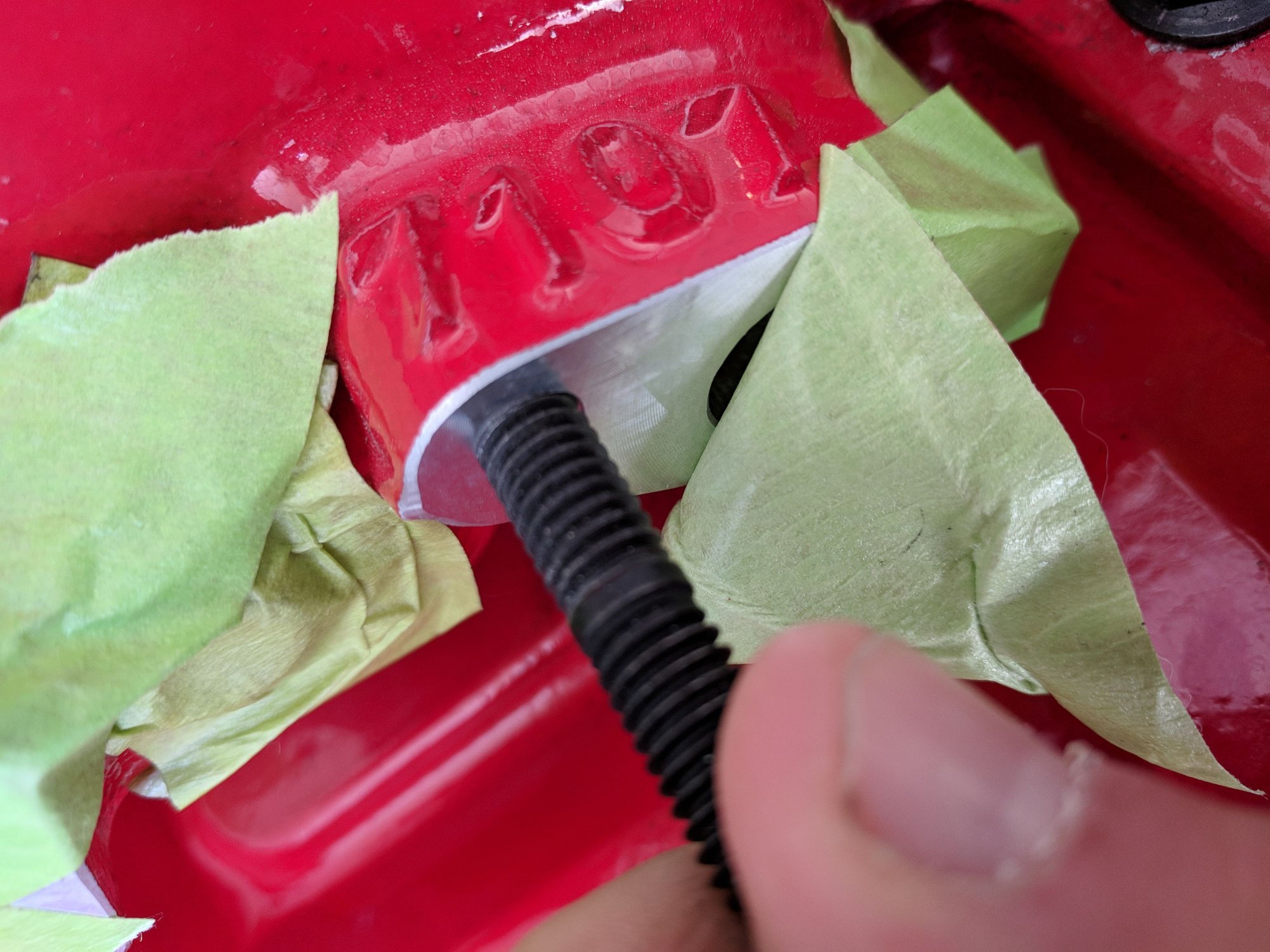

Hello everyone,
I have an lt4 Edelbrock air-gap intake. I need to install the EGR block off plates. I have the studs that went in the original LT1 intake manifold that I had used with the EGR block off plates previously. None of these original studs work with the lt4 Edelbrock air-gap intake. When I read the description in the summit catalog it says existing components of OEM intake should fit LT for Edelbrock air-gap intake. Has anyone experienced this problem? If you have any input please let me know I have been searching for the correct bolts over the past two days and cannot find anything that fits the lt4 Edelbrock air gap threads to hold the EGR block off plates on.

Well short of trial and error using various size/pitch bolts...you could tap the intake for a size you decide
ironic edelbrock could not advise WTF they did....somewhere in their files they would have the machine specs they used to make the manifold. This is not something a retailer would necessarily know as they directed you to

I know it's a real pain in the butt. I'll probably tap the intake this weekend though. I don't really want to spend the time doing it, but It looks like it's the best option in this circumstance. I'll just have to spend the time making sure it's done well.

looks like the motor is on a stand. IDK if those holes are "blind" or go through into the intake. Drilling/tap thread would leave shavings inside if the hole is not blind. not good.
May be better to pick up a few sizes (SAE & Metric) studs to see WTF size hole/thread it is if the holes go into intake

Thank you. I don't believe any of the holes are blind....I don't think any of those holes go into the intake manifold.

if the holes are not blind....then they have to go "into" the manifold. look or stick a small screwdriver in hole to see if it is a blind (closed) hole. If open you will dump metal shavings inside the intake if you drill & tap it.

Sorry guys I made a mistake. The OEM bolts actually do work with the edlebrock intake. I had to use a rachet to turn the studs into the intake. I guess the cut was so tight it literally took a rachet to drive the studs in. The studs had infact been cleaned from day one too. I was prepared to tap and heli coil the whole thing, and thought I was gonna strip the intake threads, but it worked!!!
