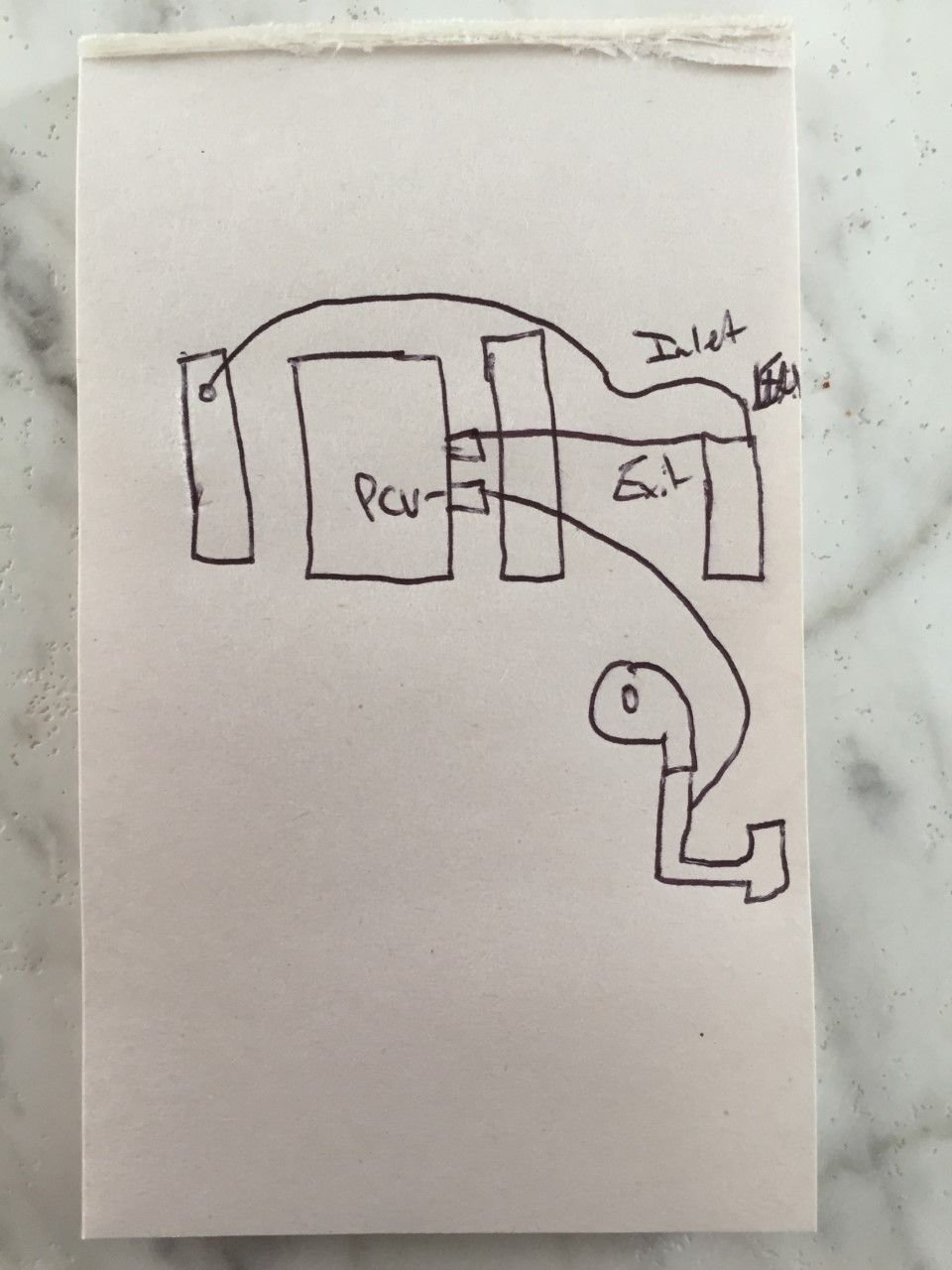

Here is a very poor picture of how I have my catch can hooked up with guidance from Mighty Mouse. I have the hose running from the pass. side valve cover to the intake of the can. The exit (PCV) side enters into a vacuum port beside the old PCV valve. The old PCV valve location has an orifice and a hose that now runs to the non pressurized side of my supercharger. I capped the port on the TB where the old hose went from the pass. side valve cover. Does this look/sound right?? The can obviously has a filter on the top not sure if this would cause a vacuum/boost leak though?

I wouldn't really worry about low idle vacuum unless you are chasing down some other gremlins. ie...Trouble tuning a MAF car due to vacuum leaks, power accessories losing vacuum during normal driving/idle, or oil/blow by issues.
Not sure if I asked before, but is your vacuum source for the gauge directly off the manifold? Some times people tap/tee five things in some funny places and get strange readings. heh..
Lot's of application specific things that can affect your readings as well depending on if it's a MAF car, (blow or draw through), are you running a blow off or bypass system, are check valves in the proper places and proper orientation...
Chad

I have it t'd into the drivers side intake manifold that runs to a solenoid. I also have my Bypass valve T'd into that as well. Im going to put my mechanical gauge directly on the intake outlet and see what it shows there.
I have the red race bypass valve if that is what you mean! is that what you mean with check valves or are you talking about the PCV system? As far as I know there is a check valve in the might mouse catch can.
