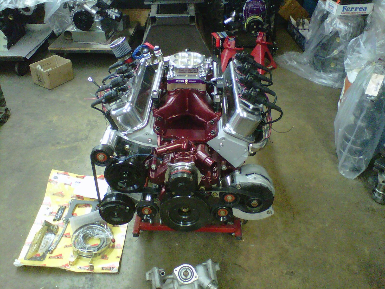

Here's my setup, it's an Edelbrock Victor E EFI intake that's been ported internally and the water neck removed it also has the LT1 bolt holes drilled. The engine isn't installed yet.not installed in the car yet.
Old Oct 29, 2018 | 05:47 PM
Free07110's Avatar
Posts: 14
Looks awesome! How much did it cost you get the water neck removed and bolt holes drilled?
