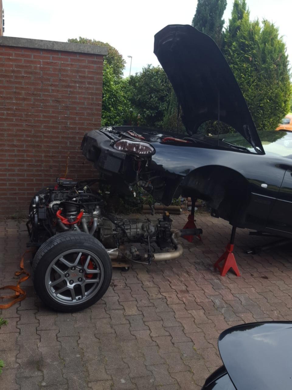

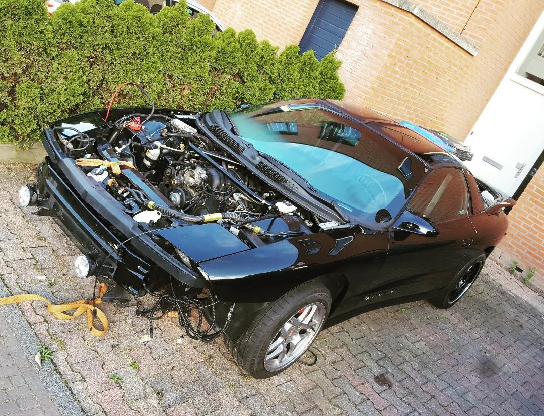

while ago decided to put an LS/M6 in my 1995 Trans/AM LT1/A4
Did all hardware engine and transmission , fuel pump assembly replaced, (not whole tank) because doner was a 1998.
since 1995 got the weird harness, i also replace whole thing even harness in doors, and before install dash back,
decided to connect every thing necessary to just fire up the engine make sure every thing work,
