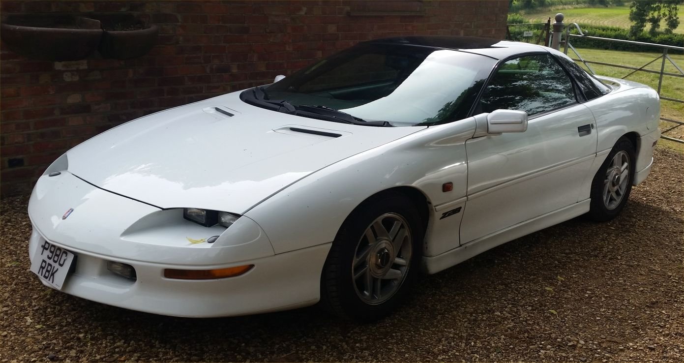

Default It's not my house, (Iwish), at sons wedding.
