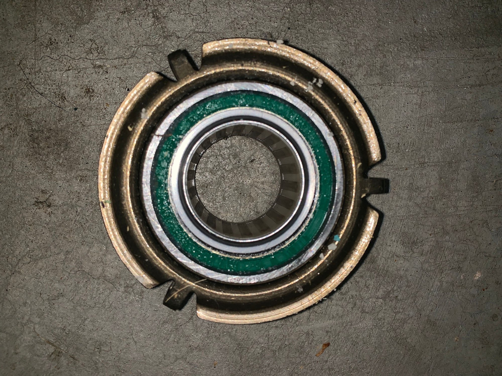

Well I dropped the whole shebang two days ago. Engine, k member and all. Got the trans off tonight and the throwout bearing is bent again. When you spin it, its wobbly like an egg. The input shaft looks straight when I spin it and when I wiggle it, there is only the smallest amount of side to side and up and down motion to it.

Sigh, I hate to say it, but you may have to tear the rotating assy apart and have the balanced checked to see exactly how, or if it was balanced correctly. Something just ain't jiving. I am not 100% positive, but I also think the trans input shaft should have absolutely no play in it whatsoever.
Agreed something isn’t jiving. I am going to have the trans looked at first. It seems more likely to me that with just the flywheel on, the engine runs smooth. Then the first day the PP is balanced it runs fine for 20 miles and then bam, the input shaft messes it all up and it goes wonky again. Either way, the whole thing has become and in the garage winter project. Be done sooner if I had $5k just lying around 😏
