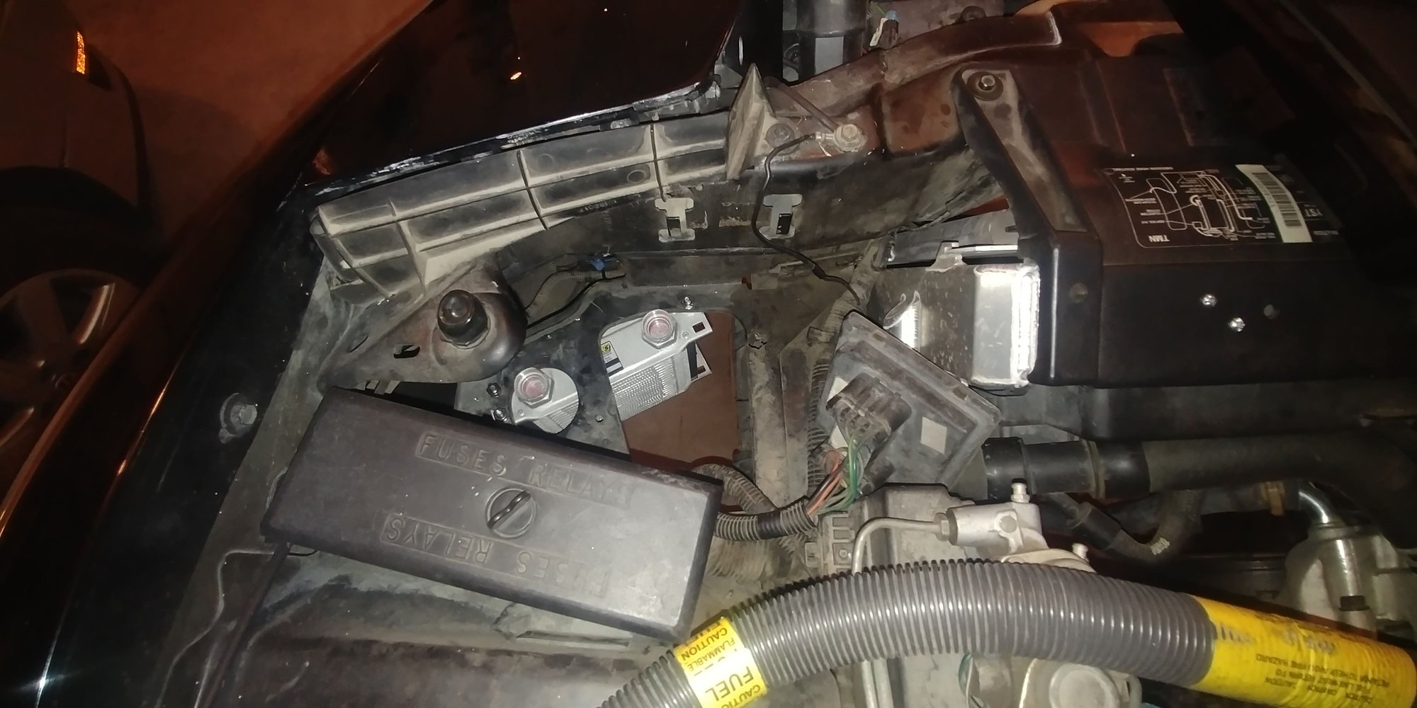

Ever since I got my fuel pressure gauge installed, I've noticed the fuel pressure drops when it gets hot in the summer, like 90 and above. I suspect this has been happening ever since I got my 383 in '09. Well I'm finally taking action.

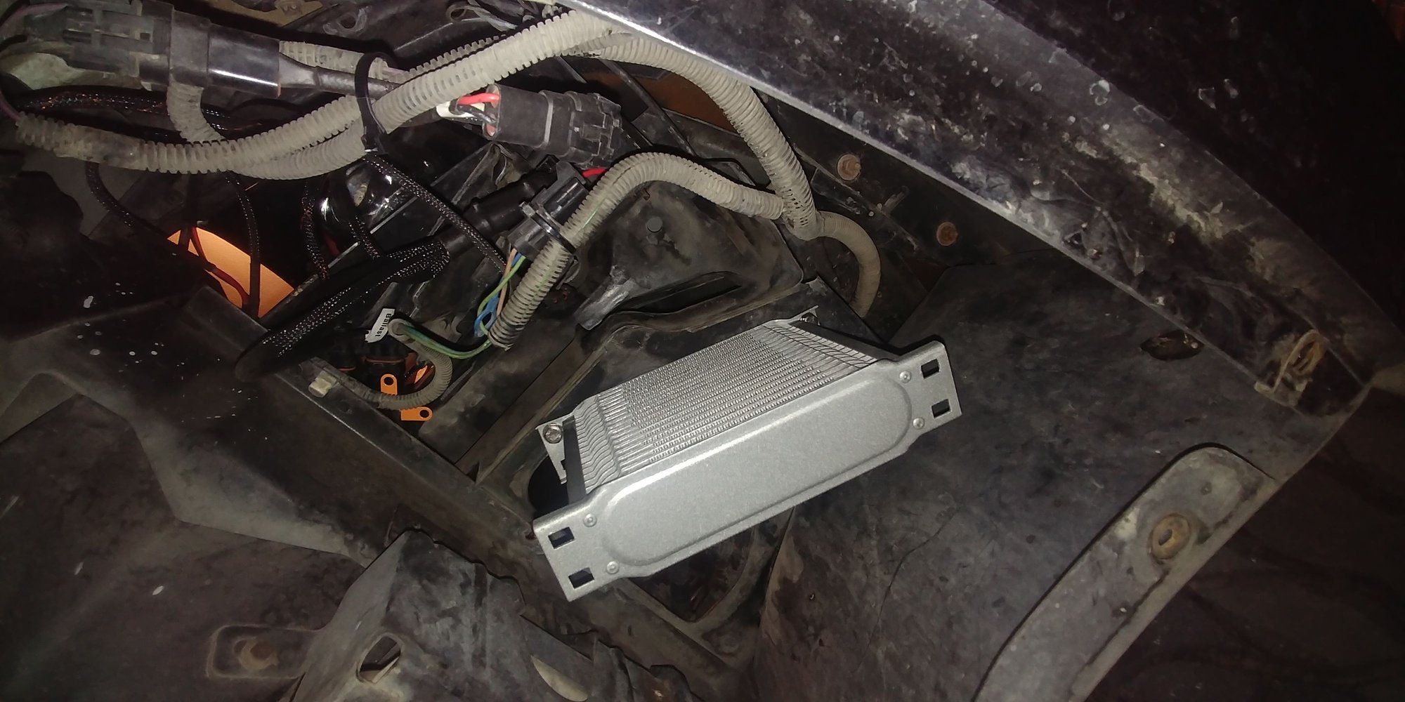

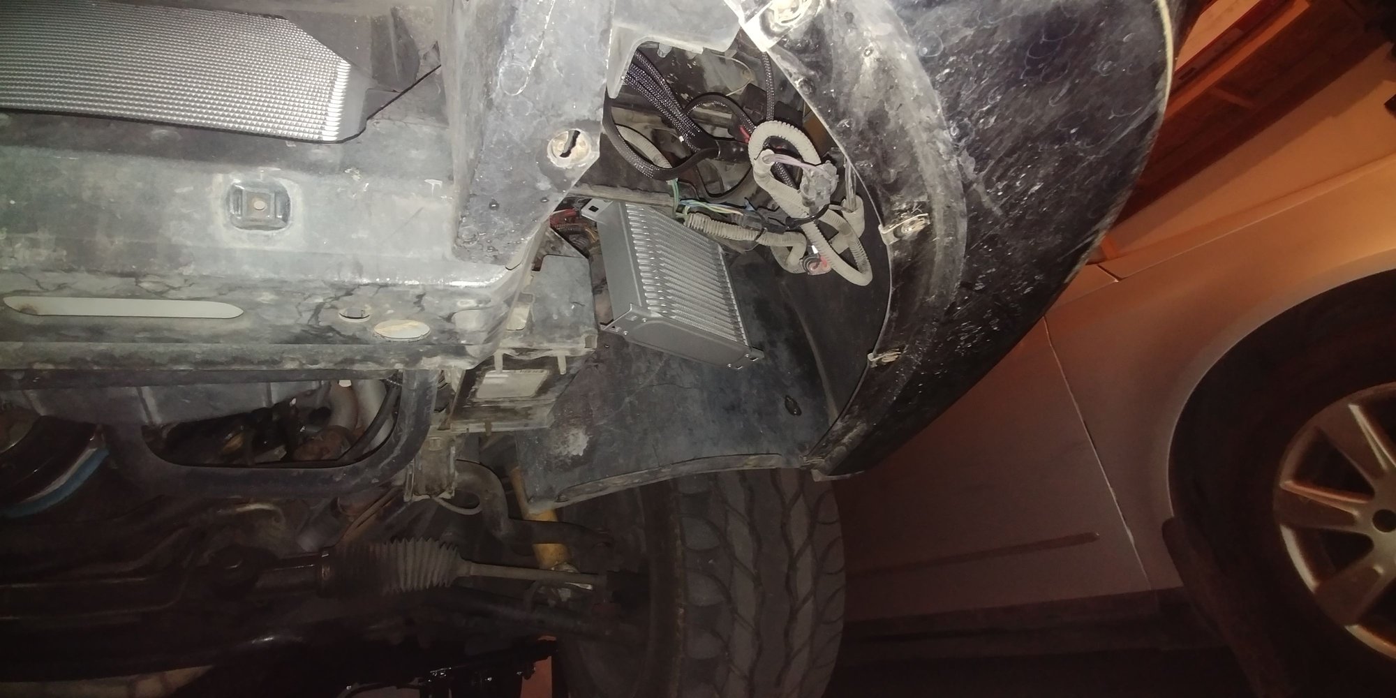

I bought an Earl's fluid cooler part # EAR-21900ERL. This is their 5.875" tall cooler with 19 rows which is the tallest that would fit in the fender well. It would have been much easier to install this in the engine bay right in front of the fuse box but I wanted the cooler out of the engine bay's heat.

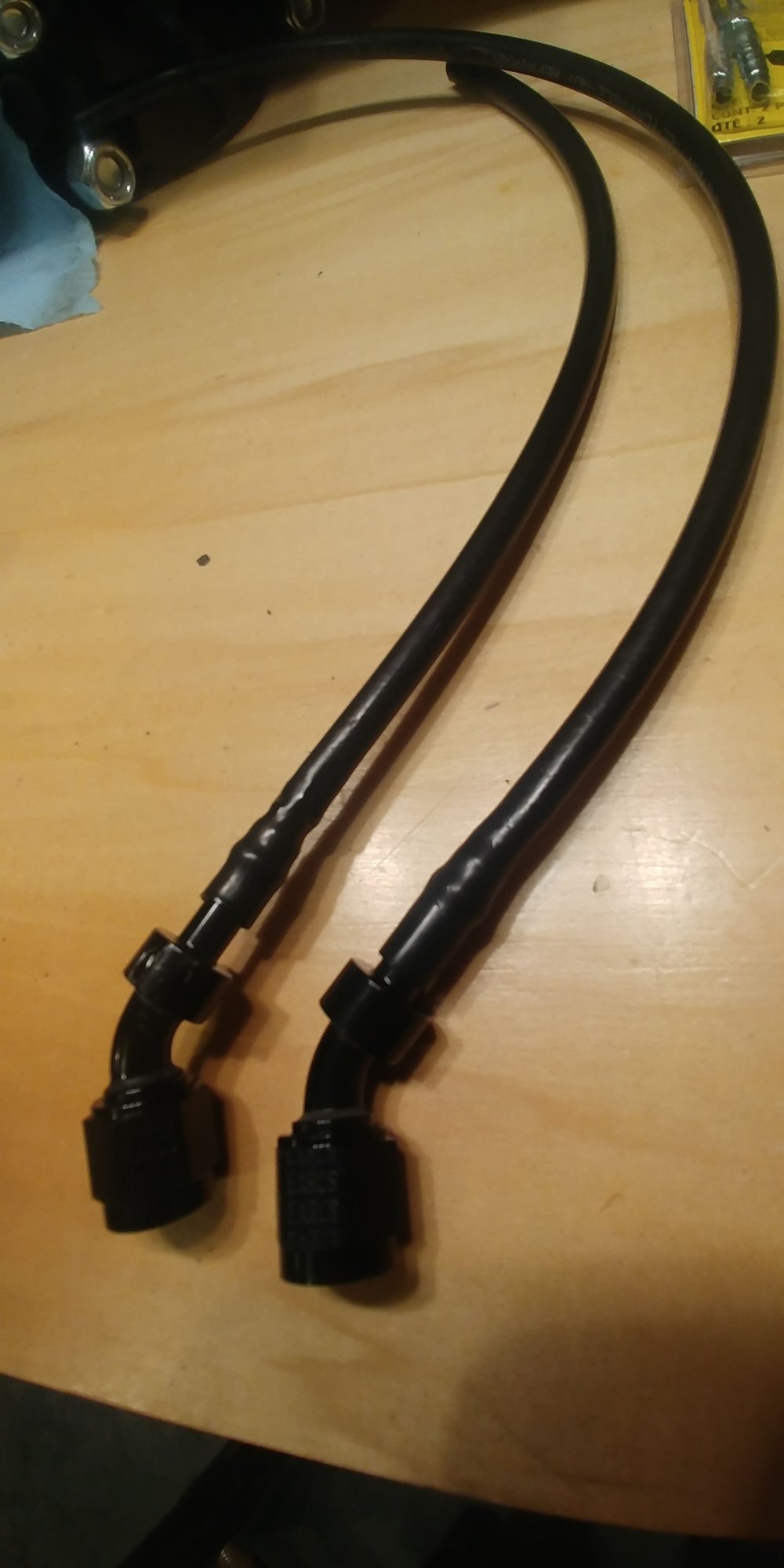

I'm using nylon hose to keep with the stock look, that could change some day.
That day was almost yesterday. It took hours of trial and error to get those fittings in those hoses. I must have melted or kinked 6 feet of that hose. I'm using Earl's vapor guard -6AN to 5/16 fittings.
Next step is to cut a slit on the underside of the loom, cut the stock return line, and get the cooler plumbed in. Last step will be getting a bracket made to mount the bottom of the cooler to the cruise control module for extra support and piece of mind.

All plumbed in and idling. There is a little seepage around the left -6AN fitting. I thought I snugged it pretty good. I read that if AN fittings are too snug they can leak. Does this look like that type of situation?
The -10AN fittings are torqued to 30ft/lbs, but couldn't get a torque wrench around these 45 degree fittings. The fittings were installed dry.
Had to bail on the nylon lines, leaked immediately. I'm using some NAPA fuel line for now, I'm eyeballing Earl's vapor guard.

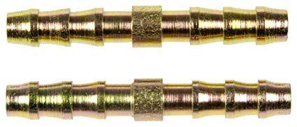

I do have one question though. I had to use these "nylon fuel line unions" to connect the stock nylon line to the new rubber line.
Is anyone aware of a fitting that is barbed for nylon on one side and rubber on the other?
Currently I have the rubber line clamped on the middle of the union because that's the only spot that's thick enough for the rubber line.

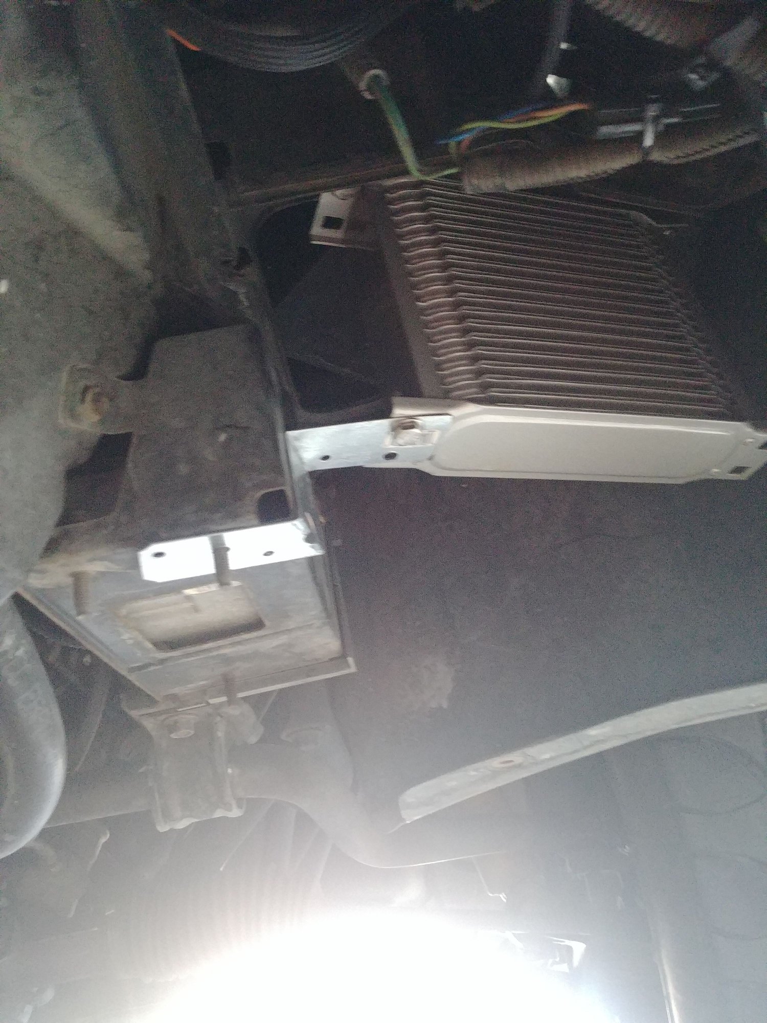

No leaks yet. Just finished fashioning up a lower bracket for the cooler. It was already rock solid with just the top bolts but this gives me piece of mind.
