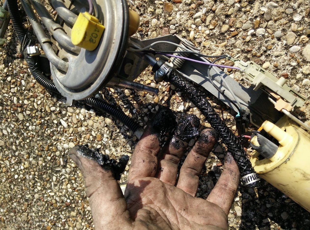

It looks like the only mod to the stock housing was cracking it open to install the old pump. Looks like I can use it after cleaning it up. Glad I dropped the tank, it's got bits of rubber all in it and needs to be cleaned. I think the picture of the old pump output line says it all... (it was no longer connected to the pump).

Ugh! That was the first thing I saw! That needed to be replaced bad, it was just going to cause issues further upline eventually.

Default In tank fuel hose
Just remember you cant use regular fuel injection fuel hose for in the tank, it will eventually disintegrate, You need a specific hose for that, NAPA has it for $35 for one foot.

My car is about like yours. Inspection went out in 2017. Got a bad brand-new a/c compressor that caused me fits until I figured that out, but still haven't fixed the a/c on the car yet. Then the car died with the fuel system issues. That hose you see there was included with the Walbro pump that I installed a long time ago. I think I installed it before I moved to Waco (yeah, that long ago, moved in 2002). Still working on a PhD and that takes 99% of the time I used to spend on cars.
I have the Racetronix kit and it includes the outlet and return lines in corrugated plastic fuel hose, but I need to do something about the basket drain line that goes to the top of the sending unit assembly. I ordered a piece of hose from Amazon that might work (it is worth a try), but may have to fumble around for something else if it doesn't.
