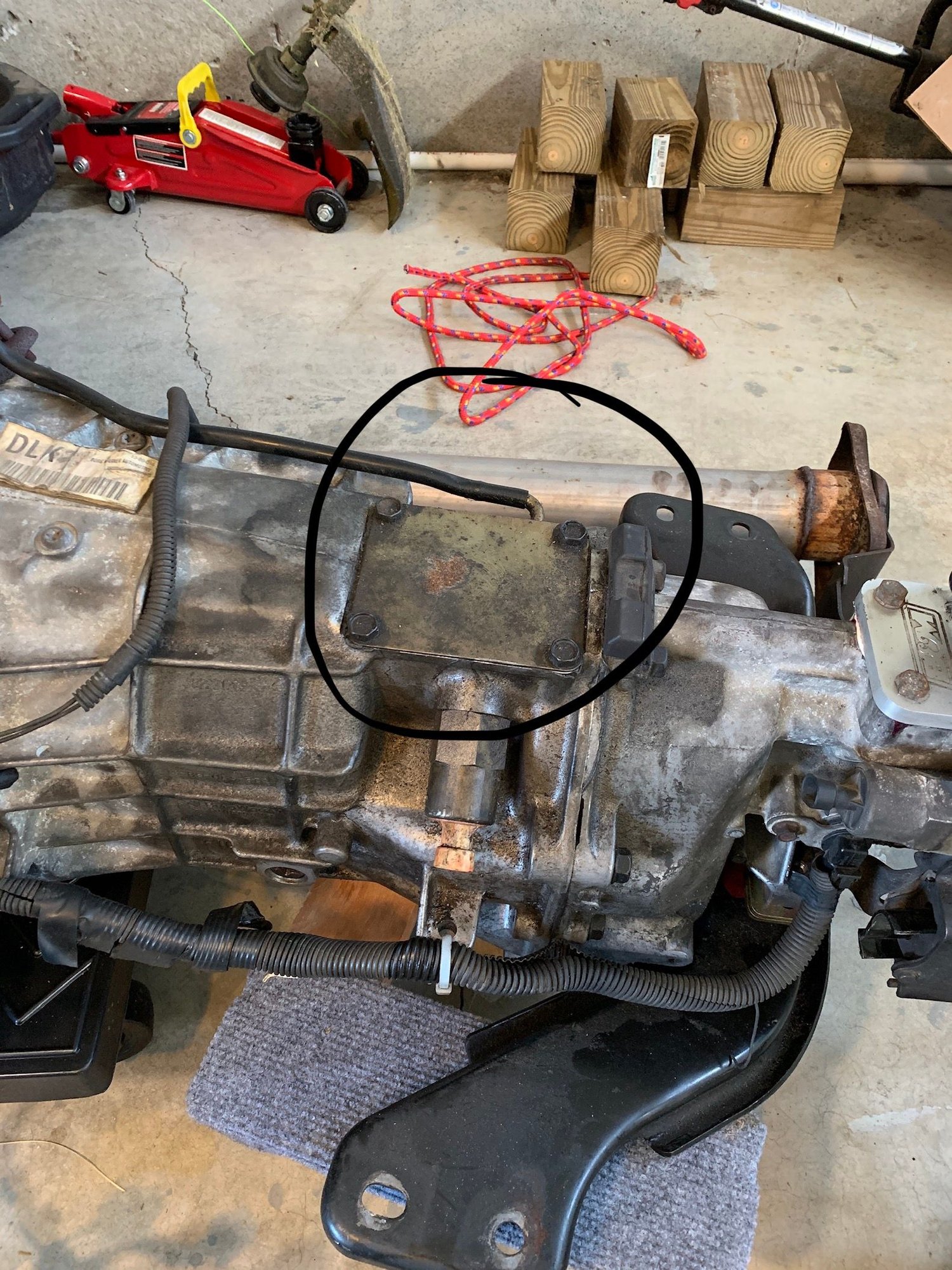

Can fluid leak from the skip shift solenoid? Got under to do the output shaft seal and found this plug soaking wet so fluid is coming from top to back.

Odd place for a leak, it's high on the trans and doesn't sit bathed in fluid. Could be coming from a loose/leaking shifter plate... has shifter plate been off?

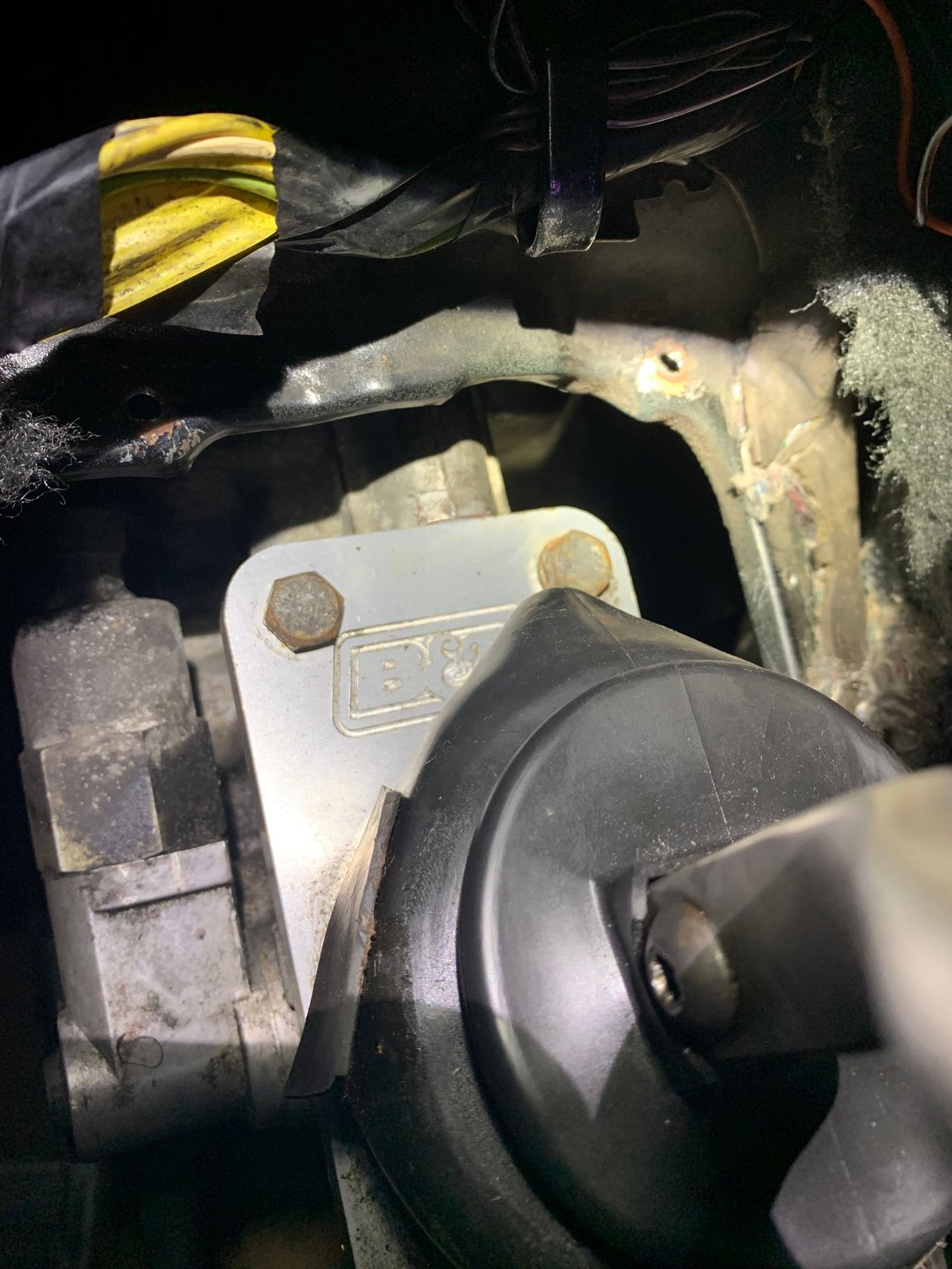

Nope. Not the shifter plate. The CAGS is forward of it and wet. Area around plate is dry as a bone.

Are you sure it's not leaking from the shifter plate that bolts atop the trans?
Old Aug 21, 2019 | 10:42 AM
Jon M's Avatar
Joined: Jul 2019
Posts: 204
Likes: 8
Positive.

Looks like oil/grime on the left side and hex part of the reverse lockout solenoid. Not sure if that follow the same path as the other pictures, but it should be resealed, IMO.

That is old dirt. The entire rim of the plate is bone dry. I am willing to bet the o ring gave after this car was in the garage all these years. Only 30,000 miles were put on it in 17 years.
