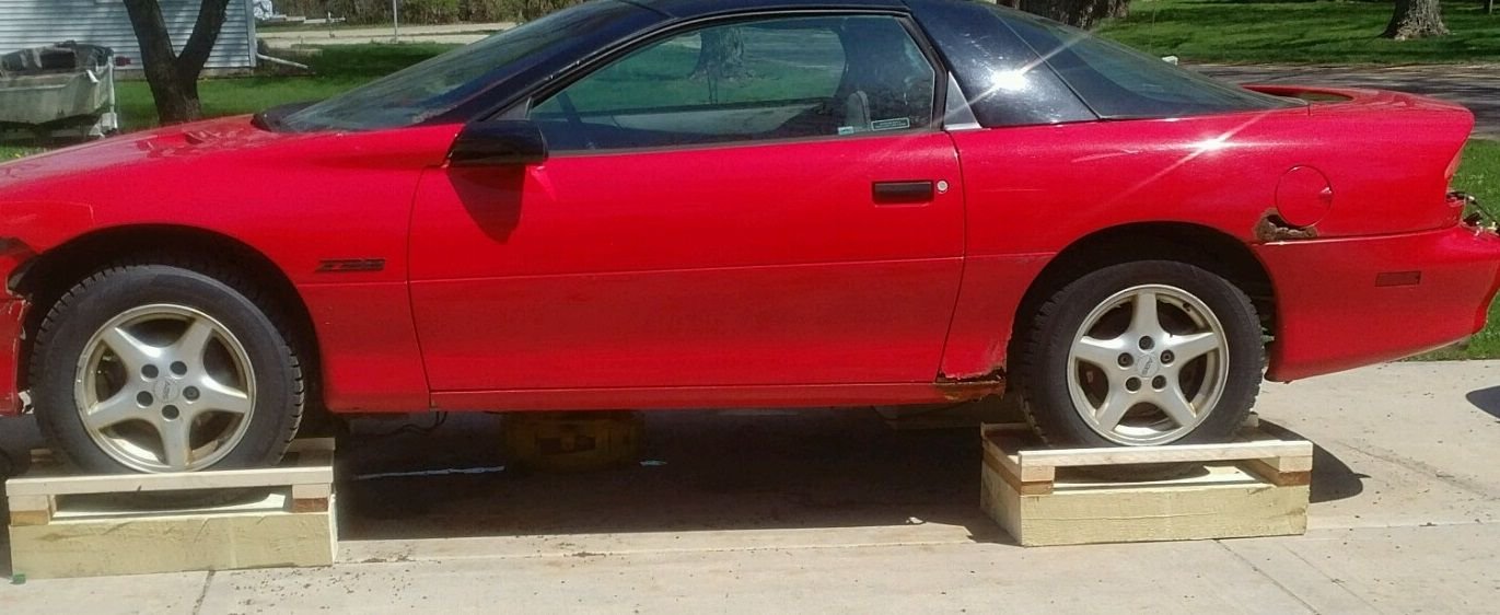

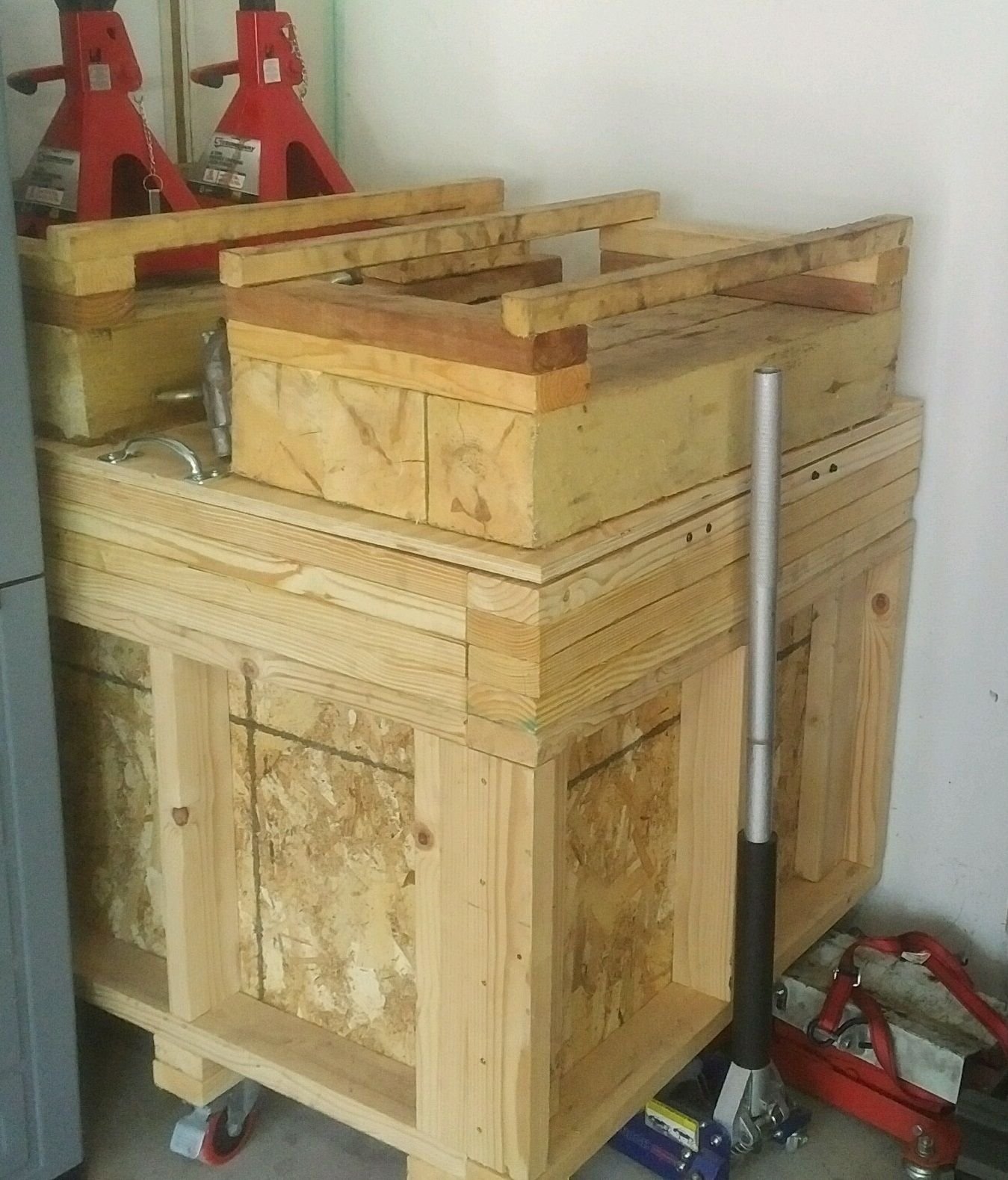

Cribbing blocks you make out of wood by using 2x4s, 2x6s, 4x4s, 6x6s, etc.
I made mine out of 6x6s (complete overkill) initially because I had a car that rusted out that I wanted to take apart. I didn't feel safe using strictly jack stands underneath it. I used the cribbing blocks as "back up" in case the stands fell through. They never did, but better safe than sorry. Having said that I love these things. I feel far safer under them than under jack stands. I just need to add some more wood to make them taller because 6x6 only gives 5.5 inches of lift off the ground. I did add 2 2x4s to front and back to tie them together and as wheel chocks in case the car rolls though, and added 2x2s for handles because they are quite heavy.
I know you said you'll use junk wheels underneath the back but just in case you wanted to try these. You might need them anyway to get the car high enough off the ground (jack stands alone probably won't cut it). Spare engine is in the crate :p
Mine are a little different than most people. They usually do something like this, which works fine too.

And yeah a regular furniture dolly will work or even just two floor jacks or a floor jack and transmission jack.I only built the crate because I'm storing the engine from my rusted out car long term, Just makes it easier to move around in my garage on wheels.

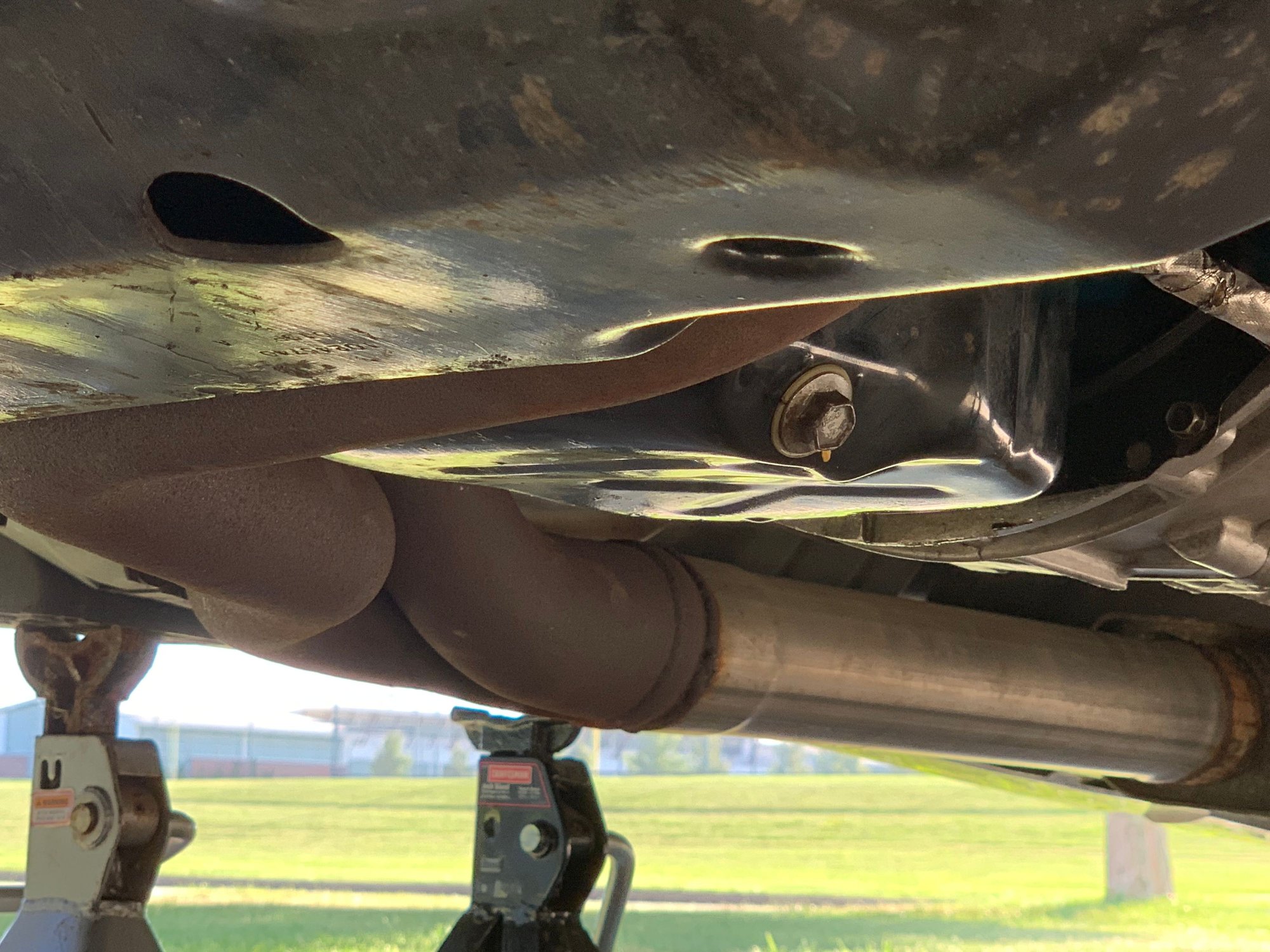

Well I started today. Got pcm out, harness out of firewall, brake lines (stripped one flare even with flare wrench), fuel lines, cooling lines off, belt off, AC compressor unbolted, brake booster and steering shaft bolt out. Sure looks like someone used my oil pan as a jack point or the Hulk punched it from the bottom. Took 4.5 hours with two of that assembling the engine hoist. I have wood under my deck to stick jack stands on. Luckily I am only trying to beat the snow and cold so I have lots of time!! Thanks for all the help! And I need a 3M decal wheel for under the hood LOL

Pretty sure the underside of that pan is normal. Drain plug sits at the lowest point.

You’re probably right SS, that pic is not the best angle but it looks funny in person. If I undo all six K member bolts while the front is in the air and I leave the eight strut tower bolts in, will they hold the motor and all? My thought is to impact them all off when easily accessible, drop the car on its wheels, then remove strut tower bolts and then lift the car up.
