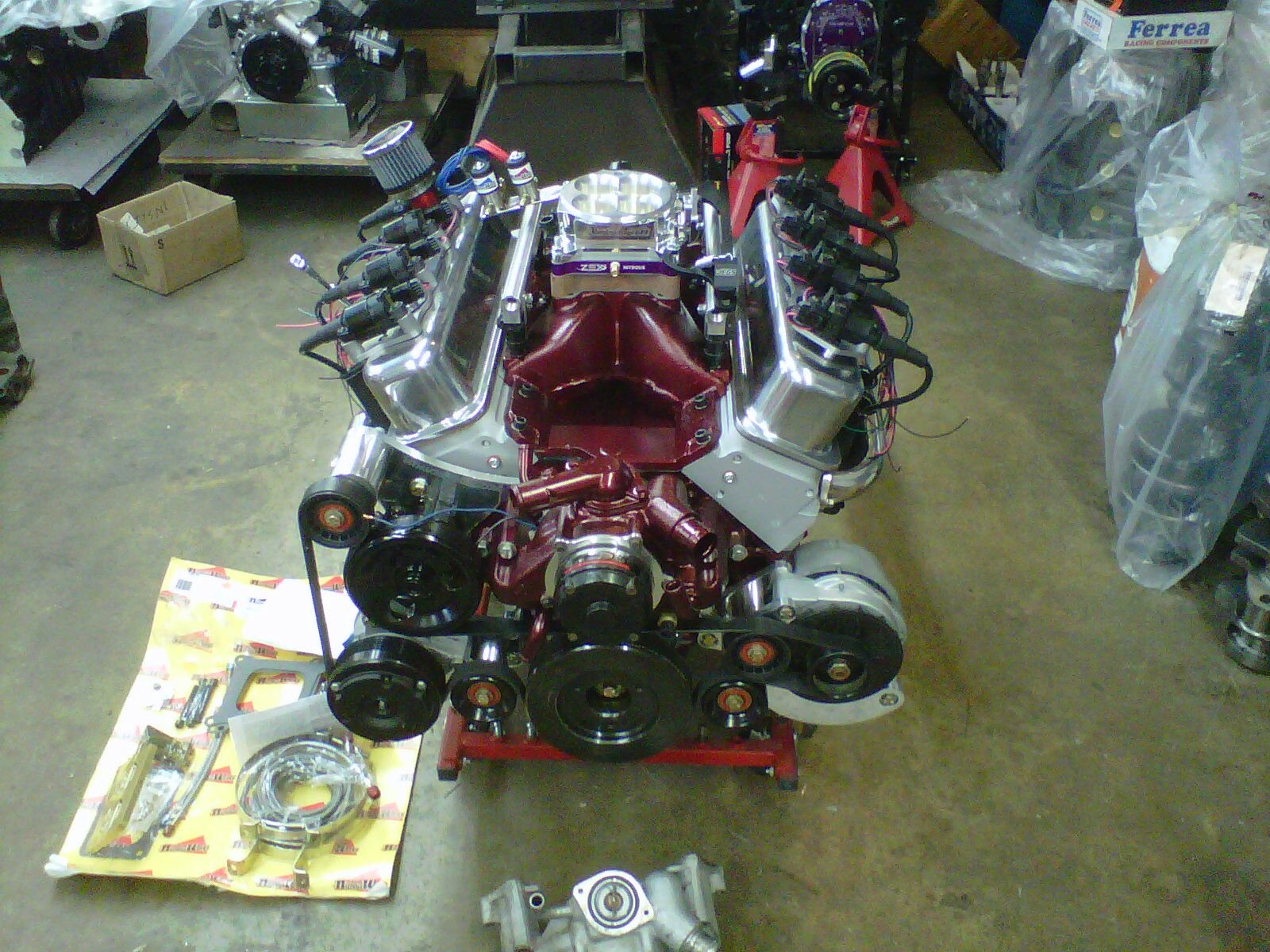

Precision Engine Machine Company in Hyattsville, Maryland builds all of my engines, here's my new one I just picked up a few weeks ago.
Block - splayed billet 4 bolt caps with ARP head/main studs, deck plugs, bored/plate honed .030 over, align honed mains, oil passages cleaned enlarged ( more oil to mains).
Crank - Howards Tracksmart 4340 forged 3.75" stroke internally balanced
Rods - Howards Tracksmart 4340 forged H-beam rods ARP 2000 capscrews
Pistons - Mahle 4032 forged with Total Seal Rings 12.5:1 compression
Cam - GMPP 847 cam 234*/242* 5xx"/5xx" lift
Rockers - Comp Cams Promag 1.6
Heads - LE3 ported 643 heads
Intake - Victor E EFI intake modded for LT1 with 1" phelonic spacer, Zex perimeter N20 plate
EFI Connections 24x ignition
TB - Accufab 4150 style flows 1215 cfm
44# injectors
Canton 244T oilpan
