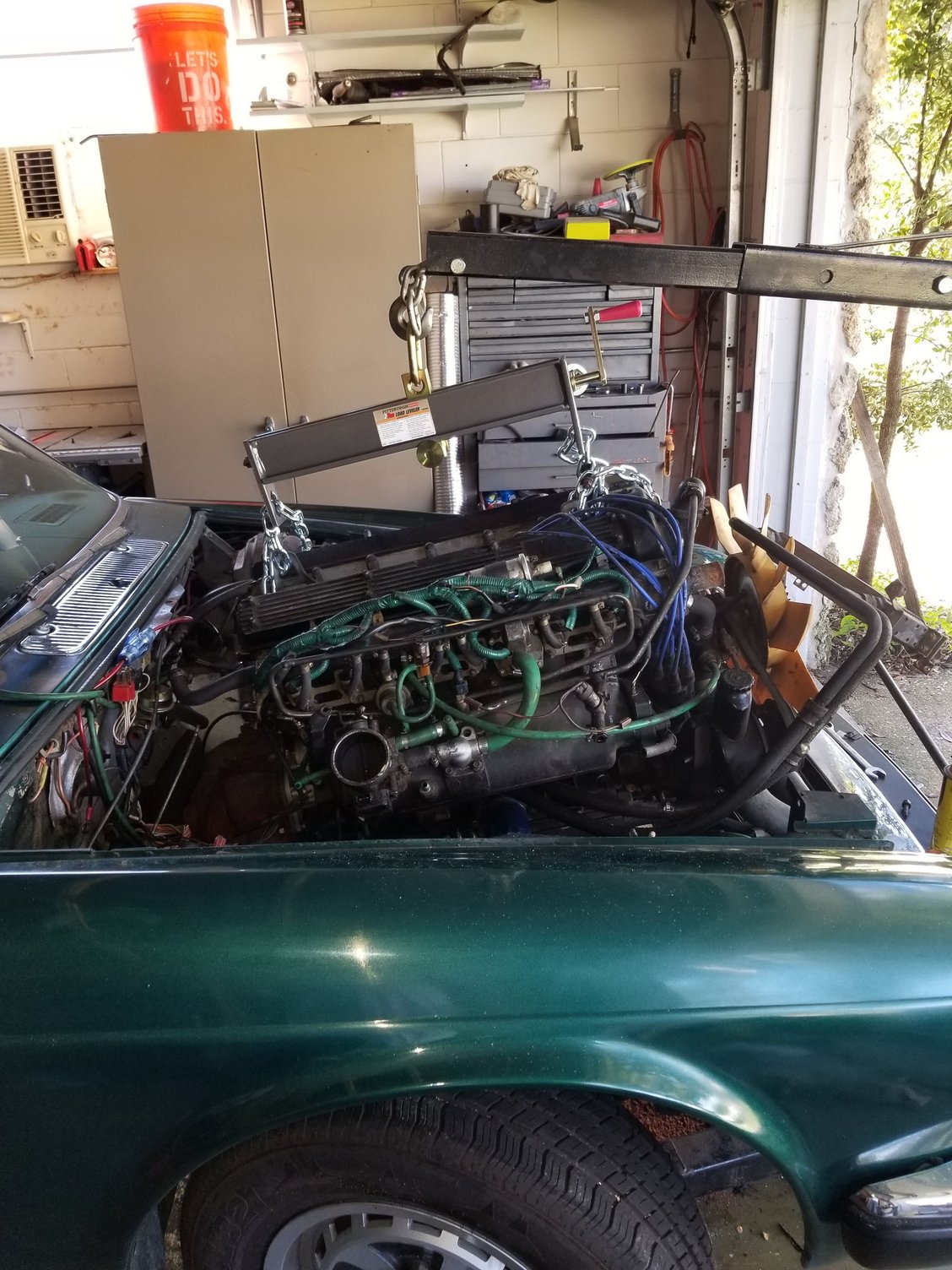

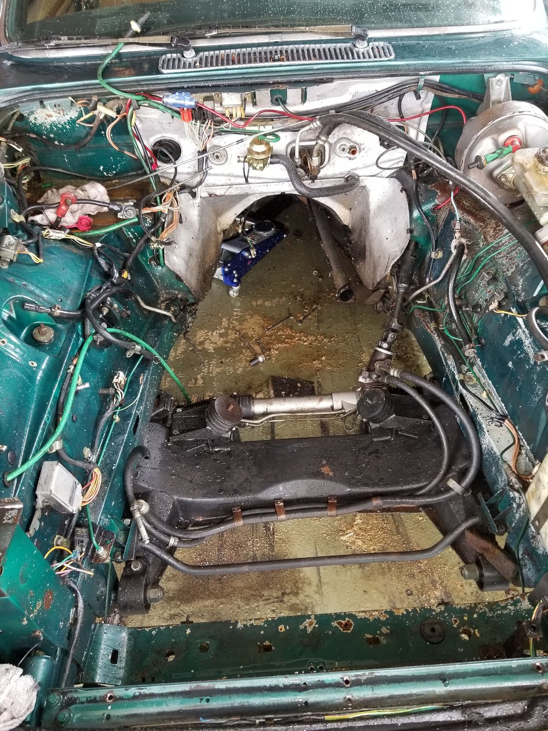

Let me apologize in advance for a duplicate post in case the mods dont catch it, I posted a couple of pics of where I am.with this, but didnt notice it said that its awaiting approval, so when it didnt show up, I did it again.... anyways.. until a mod checks in, im.looking for best advice on car direction... car facing in means I have to push car back and forth for engine/ trans pull and install, or car facing out means I have to deal with engine hoist against a 2 inch step at entry of garage.... both ways are a pain, but which way would you go???
P.s. working entirely in driveway would be optimal however HOA says it's a no-no..

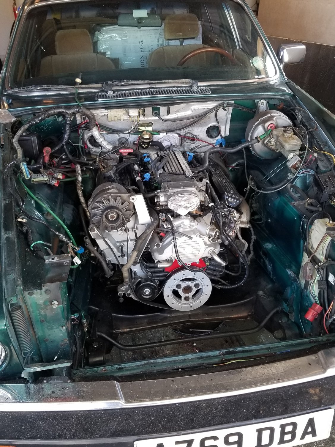

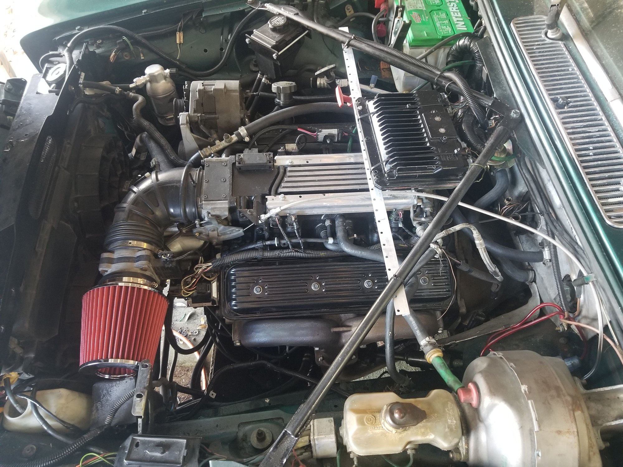

Well, a few months have passed, lt1 is in the jag, amd looks like it belongs there!, had a few issues in getting it running, all my own fault.... jag has certain cicuits that are hot in different key positions, after figuring that out she fired right up, ran like crap, but ran!! Next was injector issue, previous owner had swapped in 42 lb injectors but not programmed for them, so i put in a set of stock ones and she purrs like a kitten, albeit an angry kitten, the hotcam has a fantastic idle!!
will try to upload some phots separately as last time it went to moderation and never showed up...

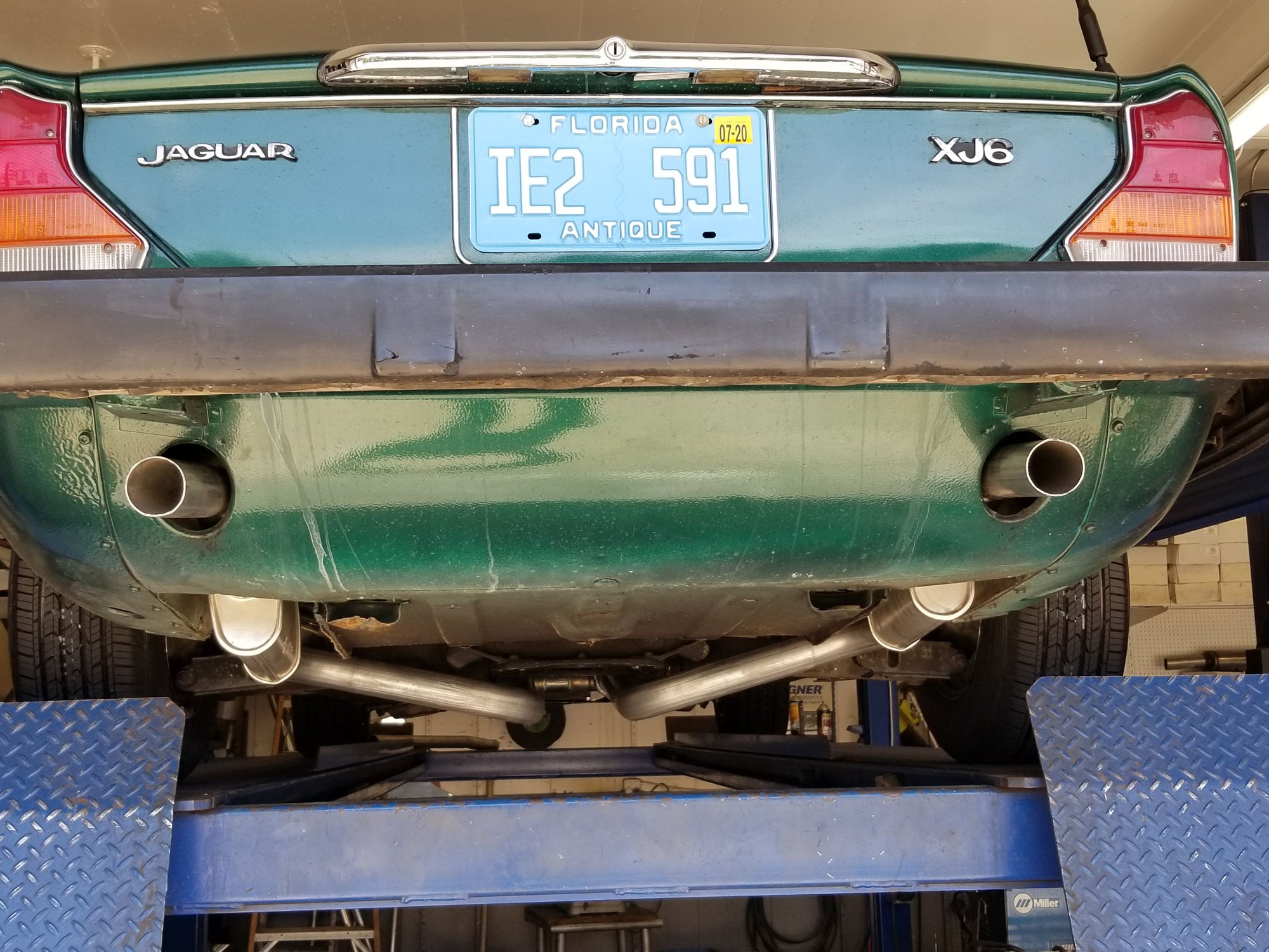

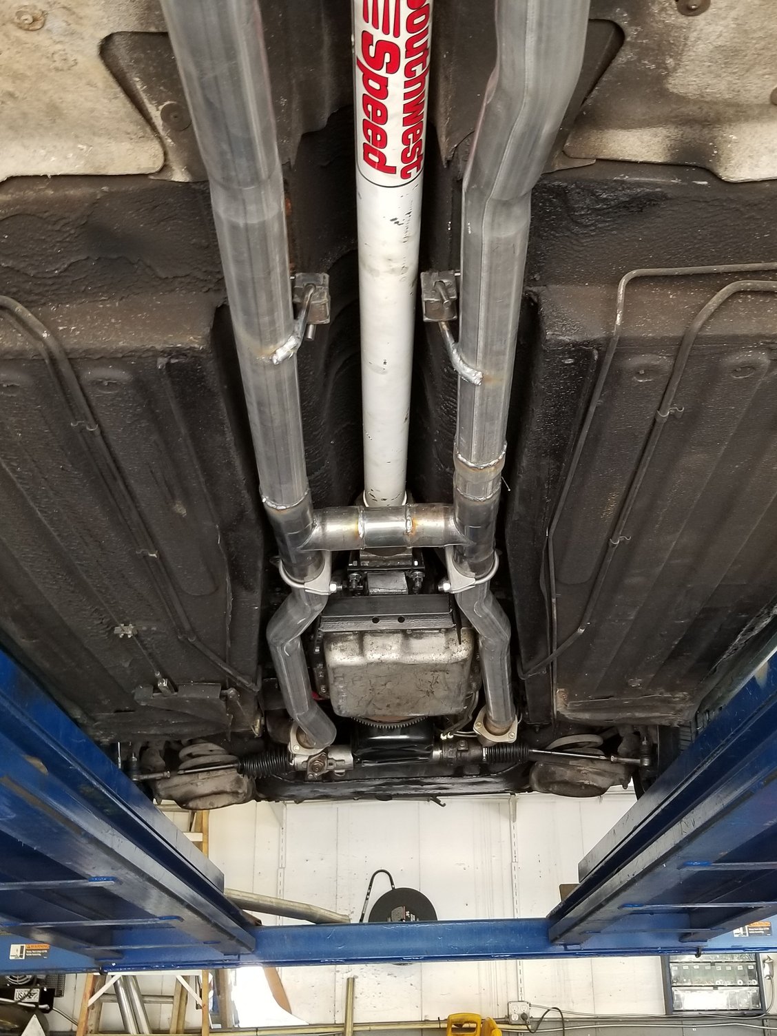

Juat a few ra dom shots.... left muffler needs to go up a bit
