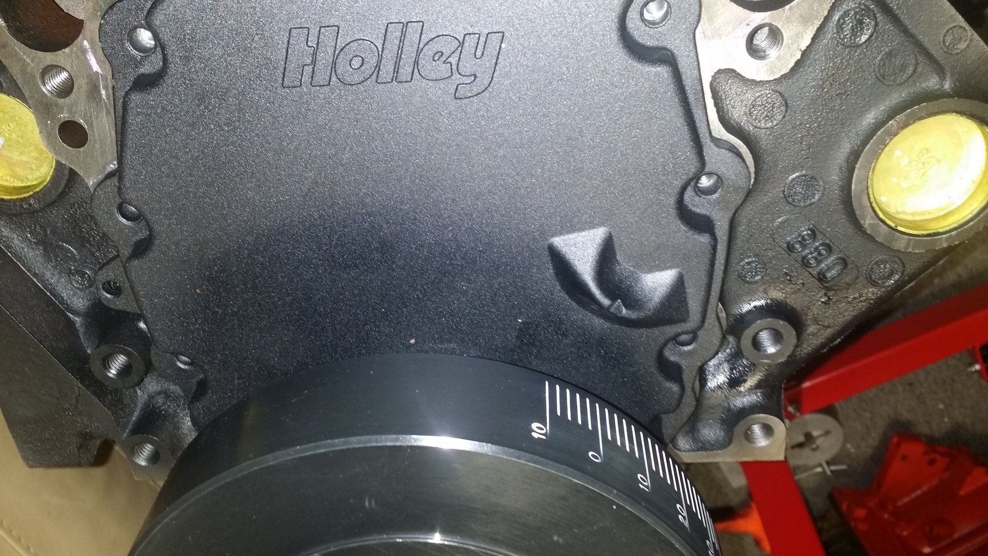

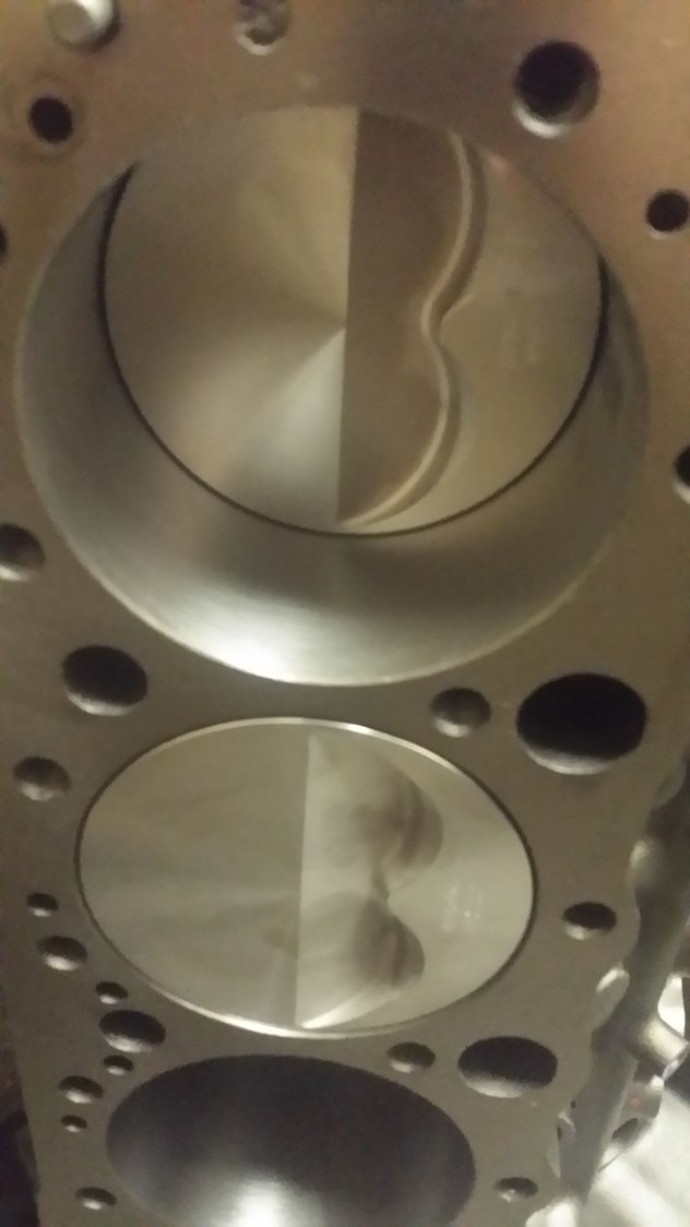

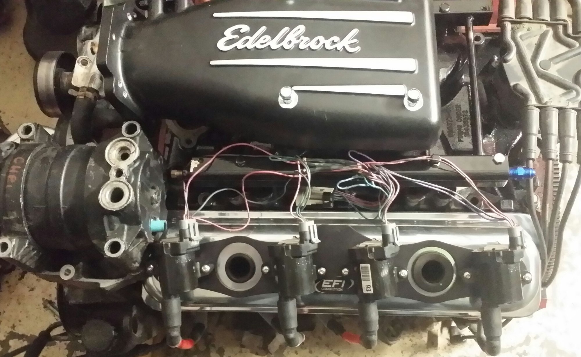

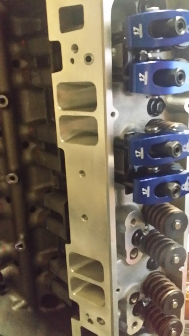

Here are a few pictures of the engine in question. Along with the intake when I was mocking it up on the 305 sitting in my shop floor.

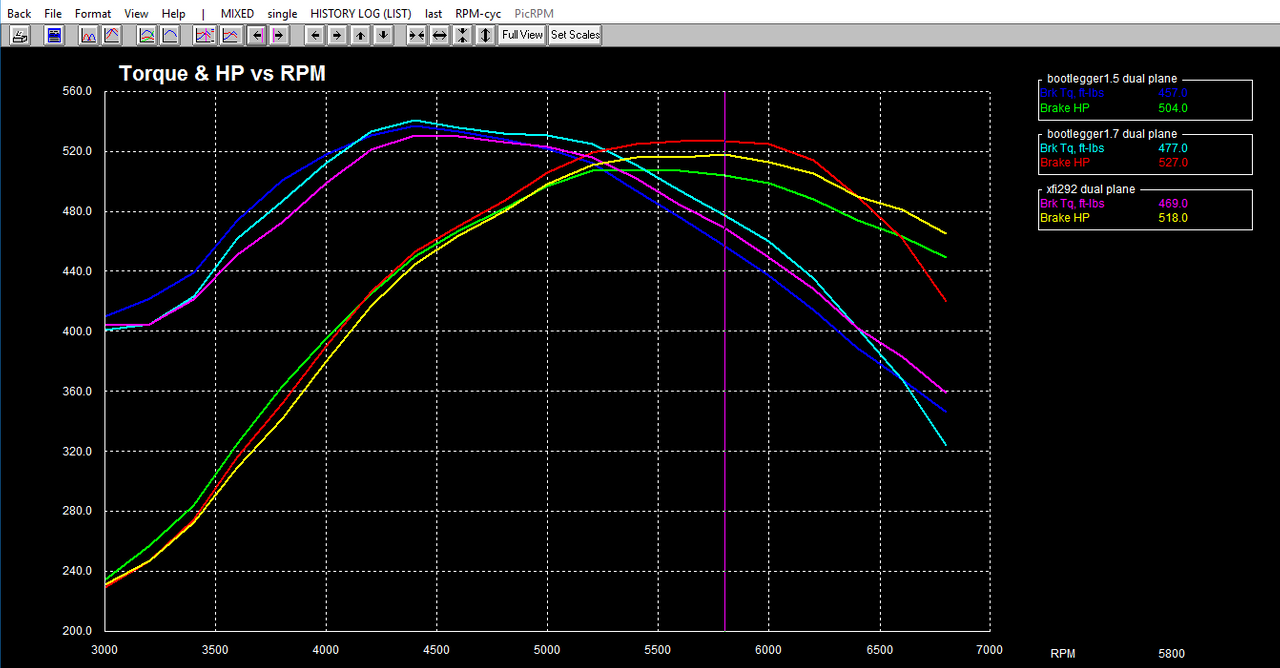

I ended up changing the cam in that 11:1 383
recently to a Bootlegger 232/244 that is more like 236/248 with the 1.7 rockers. Ended up with 0.627" lift on both sides. The torque still comes on strong in the low-midrange with the Rhoads lifters and it makes a massive torque number with the dual plane PFI intake and thorley tri-ys. I had considered a XFI 292 rather than the Bootlegger. From the looks of the software model I am glad I choose the Bootlegger grind. Model shows about 540 ft/lbs @ 4,400 and 530 hp @ 5,700. I have the rev limit set at 6,200 rpm and shift WOT in the 6,100 rpm range. Light blue/red curves are the results of the current cam/rocker combination negating the Rhoads effect under 4,000 rpm. I am not sure why the model is showing such an extreme drop-off after peak with the 1.7 ratio rockers though. The ports had not stalled even at .700 on the flow bench. I feel in reality the torque curve with 1.7s probably still has the same curve on the top-end with a similar increase all the way to redline. With the 5.13 rear gear and the 2,800 rpm stalled 4L85E this setup hits hard. I was running 70 mph on the open highway the other day and some crap box of a BMW 328I tried to keep me from passing him. After speeding up to about 75 mph and being paced, I shoved the pedal to the floor. The trans dropped to 3rd, brought the engine a little over 4,000 rpm and I was at 100 mph and 5,500 rpm in about the distance it took to overtake said 328I. A few miles down the road, accelerating from a slow down here is this BMW again. He floors it from about 40 mph. I floored it again and put a bus length on him by 70 mph. 6,200 lbs Express van moves out with this little hotrod of a 383. It is pulling about 440-450 gms/sec through the MAF at 5,500. From lower speeds it pulls harder than my girlfriends Infiniti Q50 twin turbo 3.0L which impresses me because its a red sport 400 with 400 hp and 350 tq and very quick.
