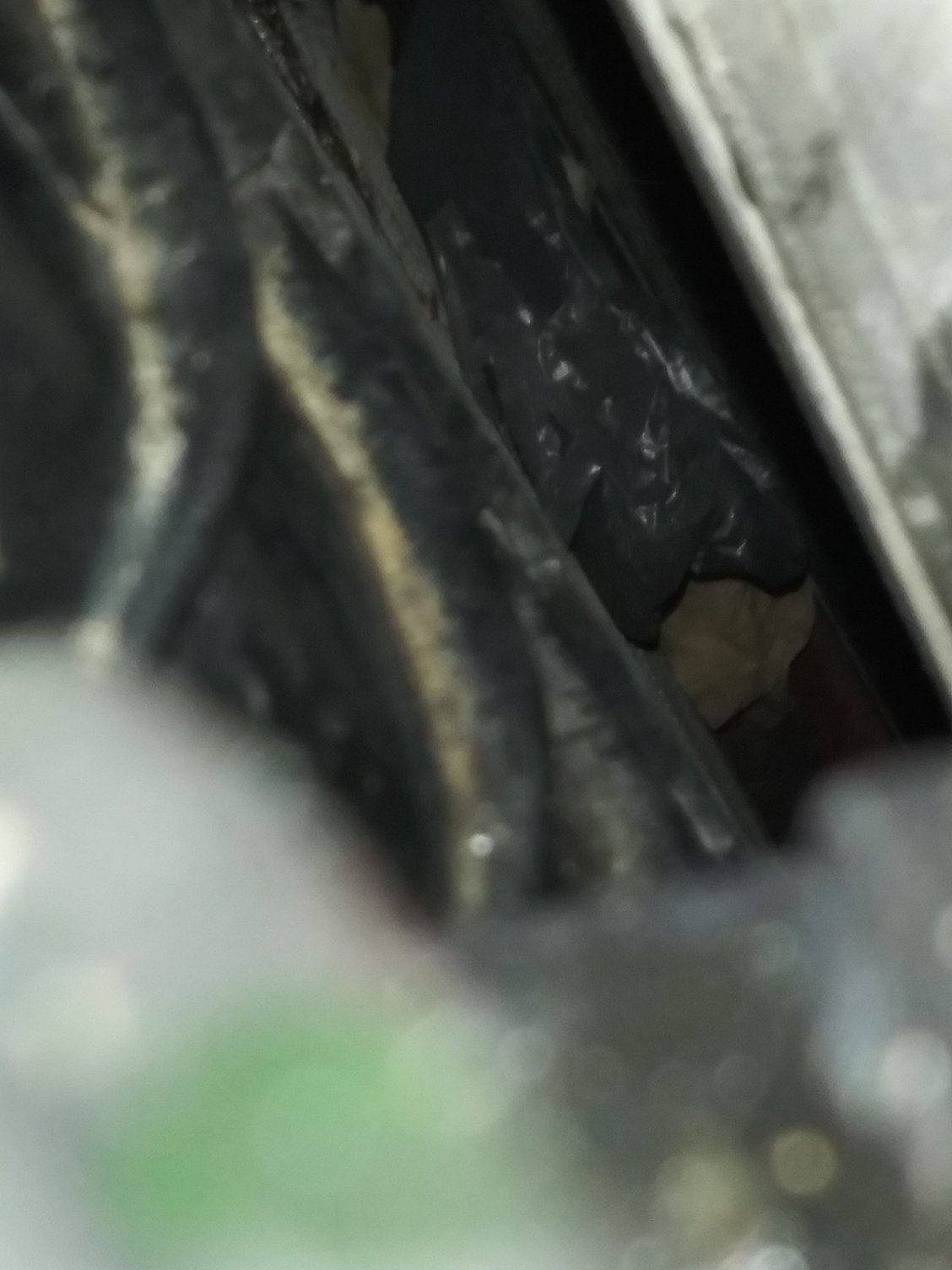

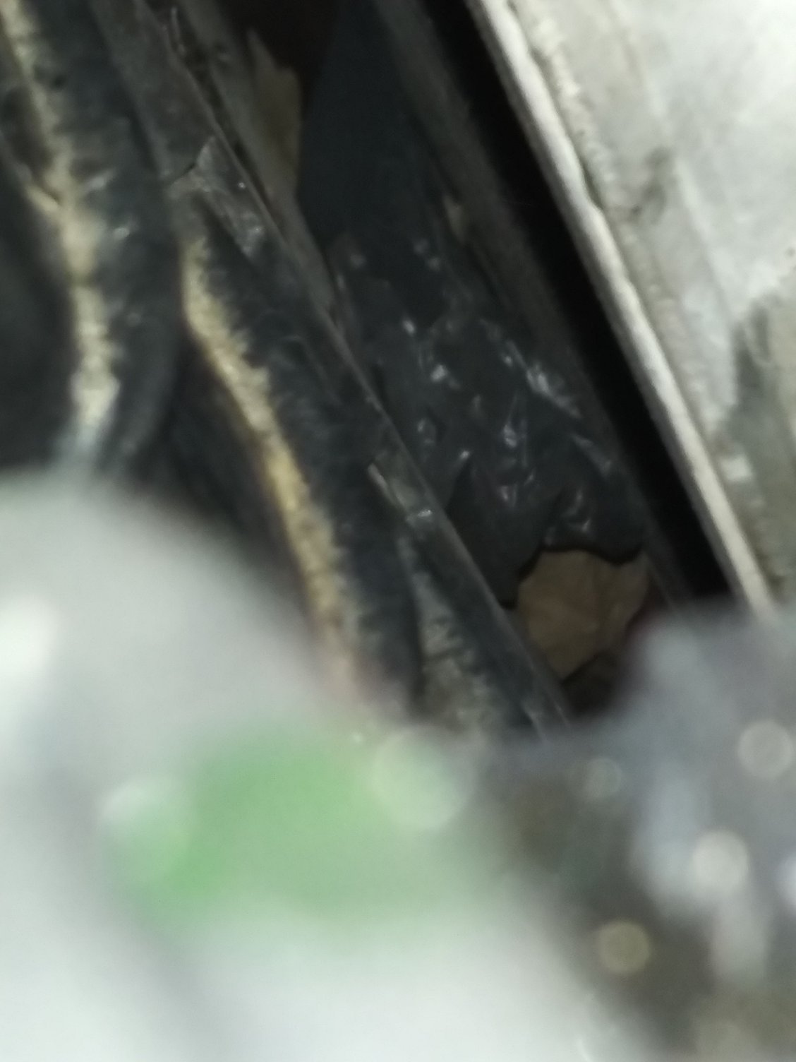

Look what I found in between the ac compresser and radiator
Will this cause restrictions in air flow getting to the radiator?

I can't tell what that is from the pic but anything that would Hinder Airflow could cause a heating problem.

Yeah It was plastic and paper towels in there. There still debris in there that I need to remove. Hopefully this is the reason why my temp was slowly climbing while cruising.

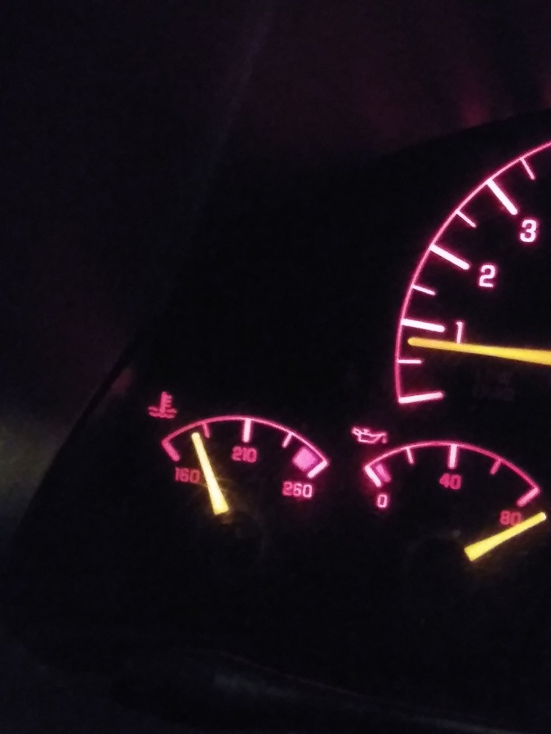

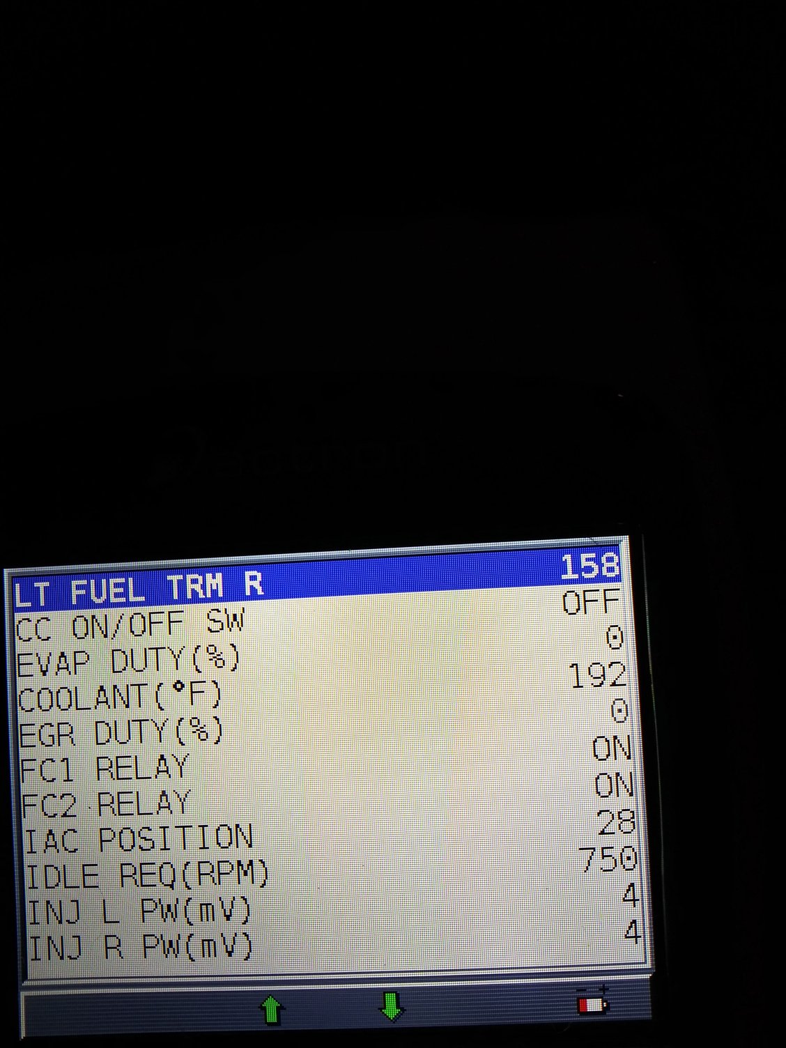

This what the pcm temp is seeing.
And this what the temp gauge is showing.

And also while driving to work Today I had the scanner hooked up to show live data. I noticed this too while warming up that my temp would drop suddenly. It kept dropping to - 40 then back to 180, even while cruising it would show - 40 what does that mean? When I got to work my temp was at 204 in park but kept dropping to - 40 then back to 204. Is that normal range for a 160 stat?

Eh, that's all over the place as if it's a connection issue or a bum sensor. Way too irradic to be normal operation. Mechanically the engine isn't capable of changing that drastically.

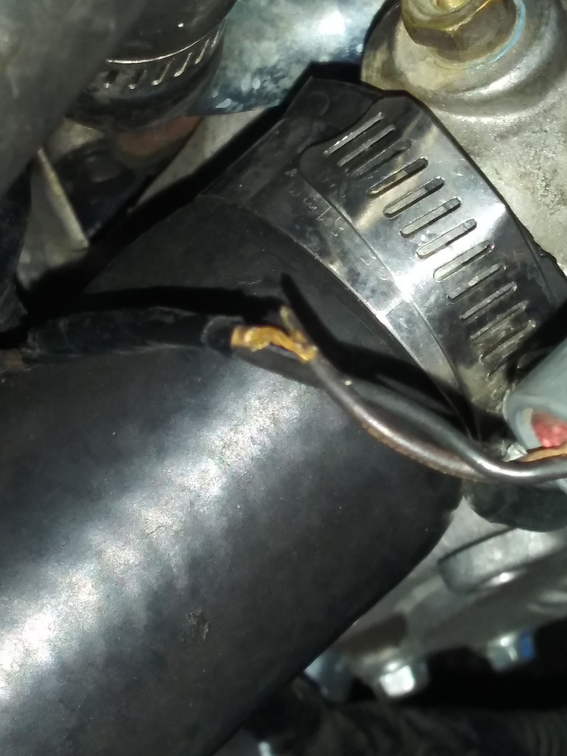

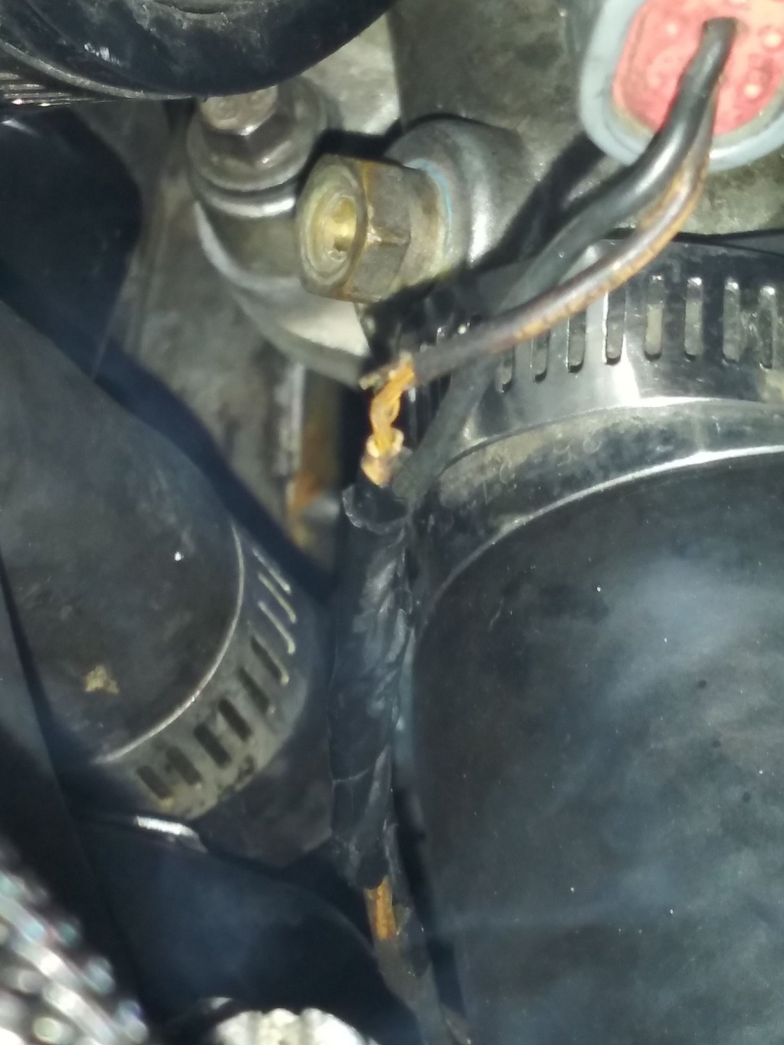

This the connection to iac sensor in the intake. Will this cause problems with the temp sensor since both harnesses are connected.
Old Dec 2, 2019 | 07:06 AM
  #37
Vicious95Z28's Avatar
Joined: Jun 2006
Posts: 1,831
Likes: 52
From: Elkton, Va
I can’t say for sure whether it’ll effect the temp sensor but it’s still clearly a problem that needs to be addressed. So... as I always say, start with fixing what you know is broken.

Are you sure you have the correct temp sensor in the w/p? That is a different part number than the one in the cylinder head. I'm guessing the wires pictured are to the water pump temp sensor? You need to follow those to see if they are damaged. It's also possible the bare wire is grounding out causing your erratic readings. Simply wrap electrical tape around bare areas for a quick fix and see if that helps.
