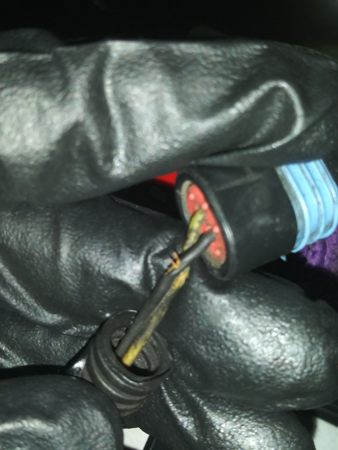

Are you sure you have the correct temp sensor in the w/p? That is a different part number than the one in the cylinder head. I'm guessing the wires pictured are to the water pump temp sensor? You need to follow those to see if they are damaged. It's also possible the bare wire is grounding out causing your erratic readings. Simply wrap electrical tape around bare areas for a quick fix and see if that helps.
​​​I'm very positive I got the right one, only one of them got two pins which is the wp ect sensor. Unless there something I don't know. I did purchases it from autozone, not sure if they have a bad rep or not.
That picture is the wire coming from iac sensor on the intake, but I see that the temp sensor also mates with same harness. I would think that would cause issues to the temp sensor cause the wire connects to it? correct me if I'm wrong.

This is the connector that goes into the ECT sensor (Engine Control Temp) sensor in the wp. Seem like the wires are kinda messed up. I wrapped it and the iac sensor (Previous photo) with electrical tape.

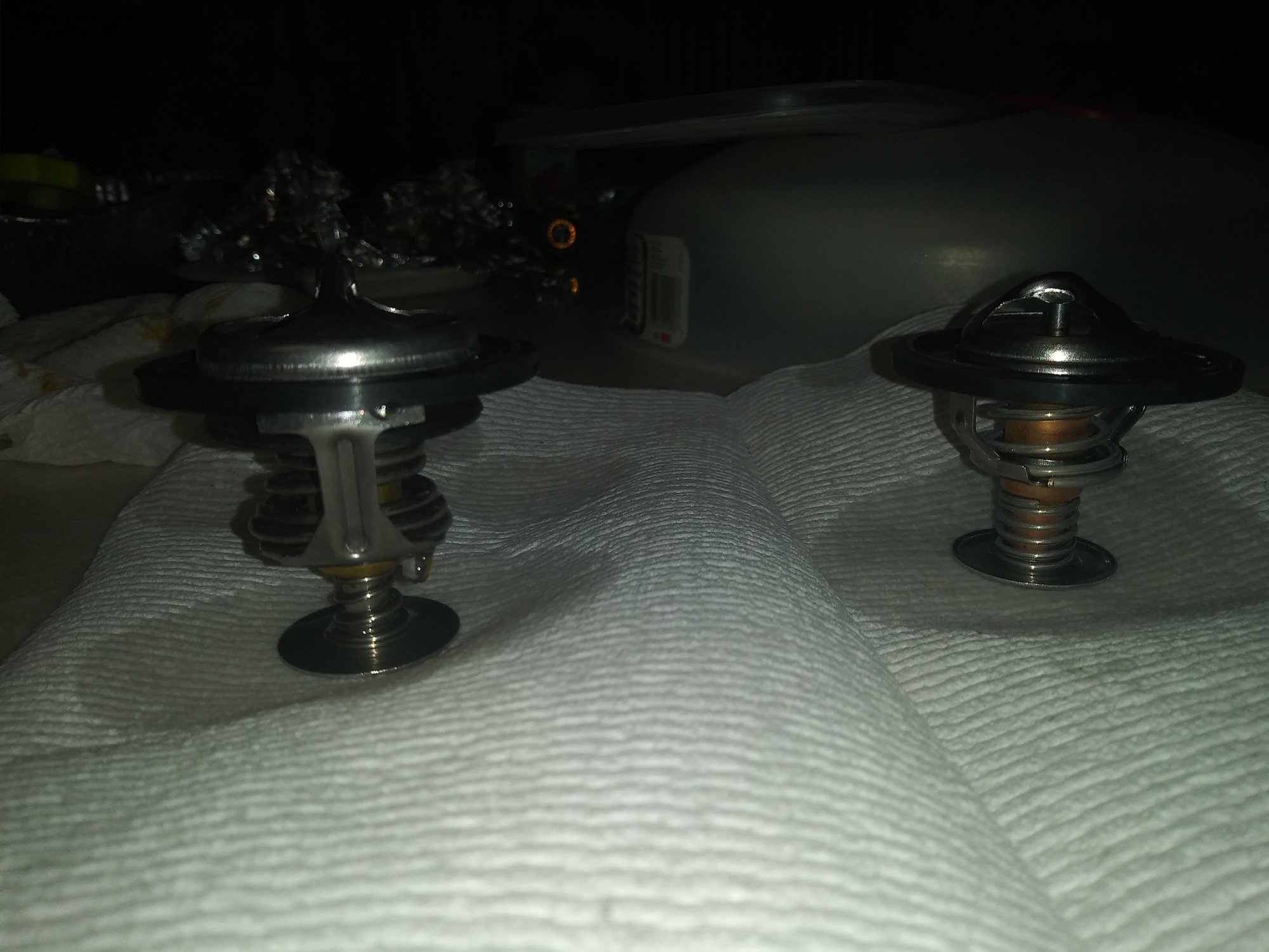

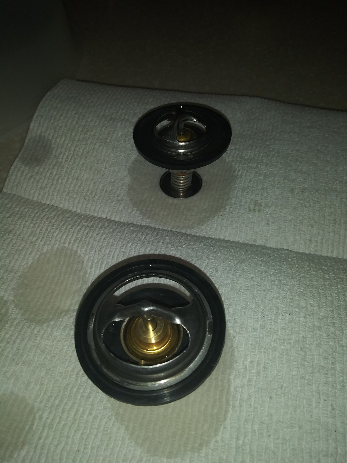

And also I had to change out my thermostat housing for a new one because the bleeder screw on the old broke. While in the process I swapped my previous hypertech 160 thermostat with a mishimoto 160 Stat. I tested both in boiling pot both function the same, they open at the same time, but the functionality while closing was different. The hypertech closed right away once taking out the pot, but the mishimoto Stat closed at a slower paste (Which I think is good imo) Another thing I noticed is the size difference, hypertech looks shorter compare to the mishimoto. I even compare a barely use acdelco 180 Stat to the mishimoto, they both look the same. Even the crown on the top of both Stat is similar. Where the hypertech stat has different design to it. While boiling the two stats I noticed when both was open i can see the flow of water flowing thru the stats. It seem like the hypertech looked more restricted due to the design on the crown. But the mishimoto and the 180 Stat look like water was flowing thru them good due to the different straight crown.

You see the difference in the top part (Crown I would call it) the hypertech might be more restricted. Idk just more theory.
Look at the height differences. Mishimoto left, hypertech right

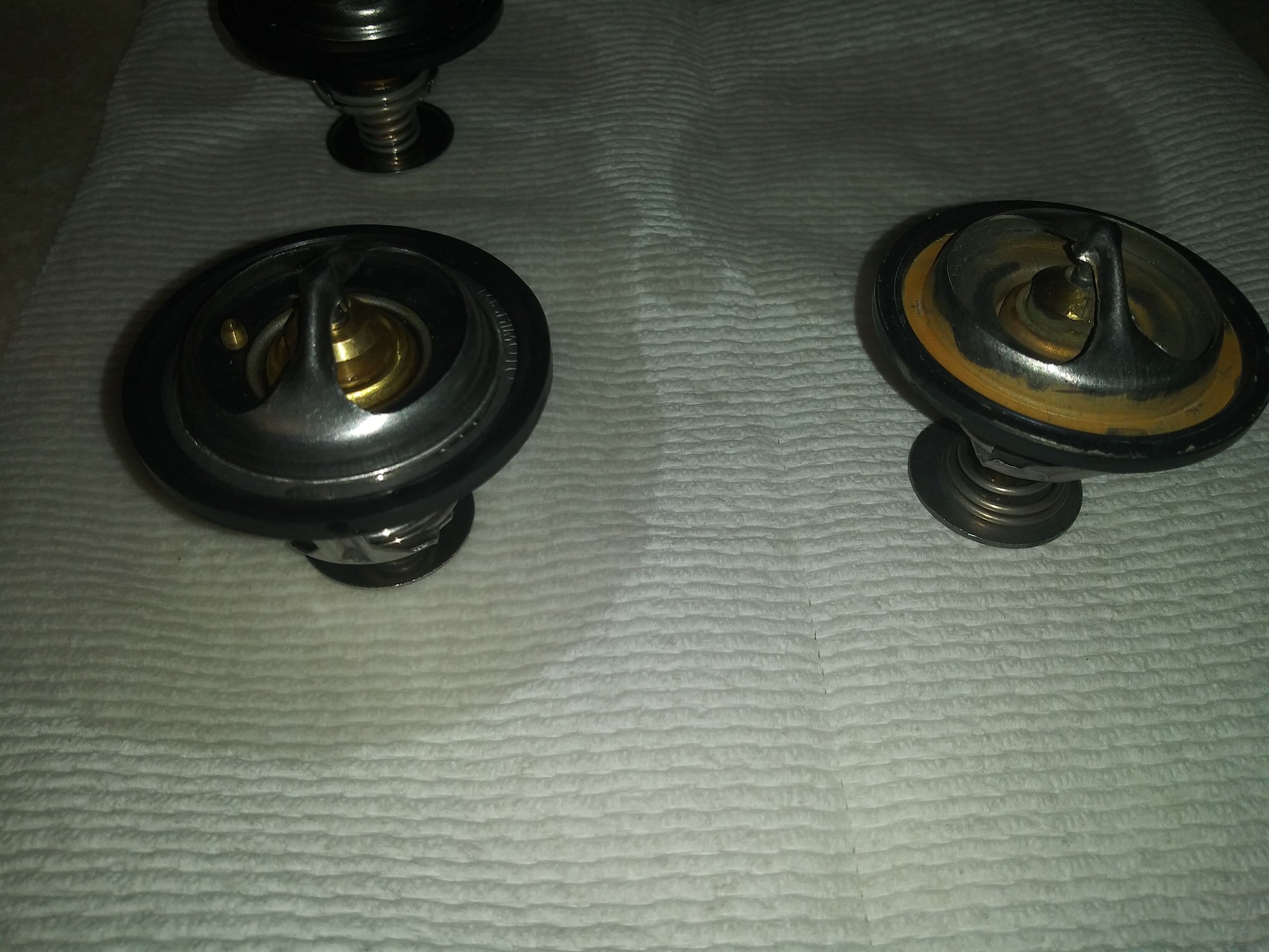

Here a Pic of mishimoto and the stock 180. Look more similar and height and size. And the crown is the same. (Sorry for the lightning)

I'm using the mishimoto Stat. I'm confused of why the hypertech Stat is shorter in size.
