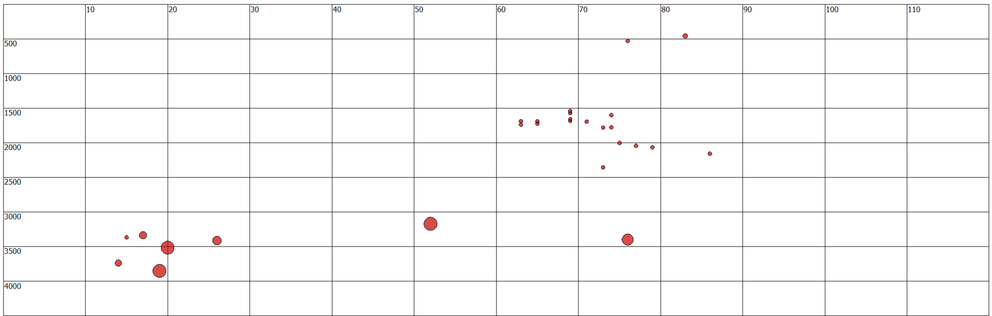

I can't seem to get rid of knock while cruising. It's mostly while in 6th gear between 1500-2000 rpms at 60-80 kpa, around 10-20% tps.
My BLMs are perfect (tuned for leanest bank due to split BLMs) and my timing table is stock. I've even taken out 1-2 degrees of timing to see if it would help. From looking at a graph of the knock counts and tps, it almost looks like I get knock when coming off or decreasing the throttle. In the EEHack knock map, it shows red PE knock at things like 40 kpa, which is obviously not possible, but it looks like it's when coming out of PE that the knock occurs. Other times the knock happens exactly when PE mode is activated, even though the timing doesn't change.
I've had a few runs with very minimal knock, but that is only accomplished by enabling spark skew in EEHack and retarding the timing 2-3 degrees. I don't mind or notice the cruise knock so much, but it's very noticeable when it happens at WOT at 2500, even after I've retarded the timing.
Is there something I'm overlooking? Attached is my current tune and datalogs from the past few days.

Your sig says you have 1.6 rockers. I am assuming they're rollers. If so, you could have valvetrain noise that's being picked up as knock. Can you audibly hear it yourself or does it just show on the logs?
You have more knock at 3k-4k and it doesn't look like you have pulled timing there. Maybe look there as well if its truly audible
