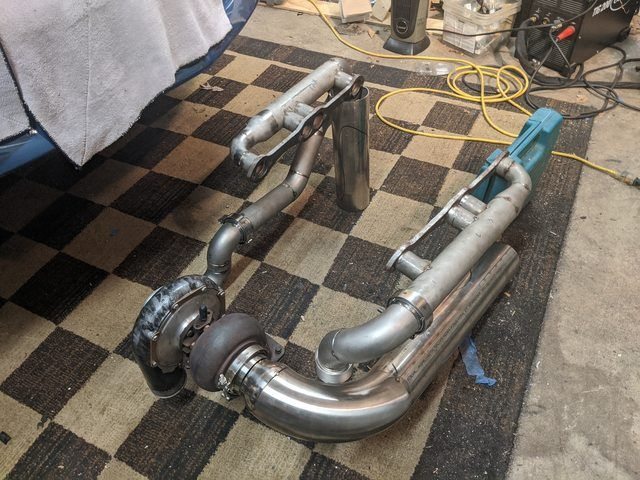

@Shownomercy any pics of your turbo setup with the BBK headers modded, I have a set and was looking for pics of how others modded them for use with a turbo?

Driver side gets a flex joint, and the passenger side gets a v band. Run a Y pipe to connect them then run it up under AC comp.

Thanks, Shownomercy, from those pics I can see why you're changing, it doesn't look like there's anyway to reach plug #5 at all. How much would you/your welder charge to make me a set of hotside pipes like the ones in your cad drawing?

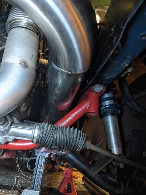

Fit a 4in downpipe without hacking car or K member?
Challenge accepted.
Old Feb 17, 2020 | 07:58 PM
Shownomercy's Avatar
Man-Crush Warning
Joined: Jun 2009
Posts: 3,197
Likes: 130
Off to get Tig'd

Looks really nice man, very simple, very neatly done.
