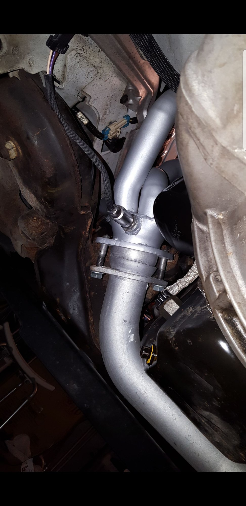

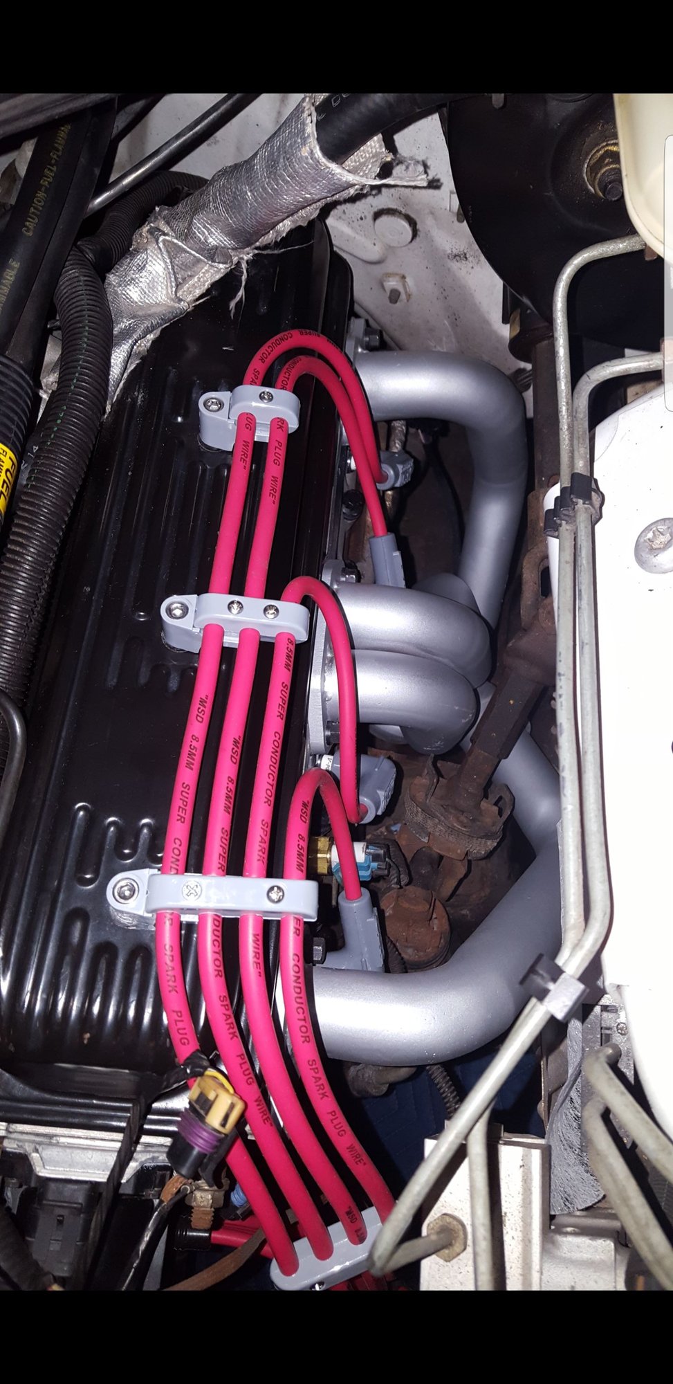

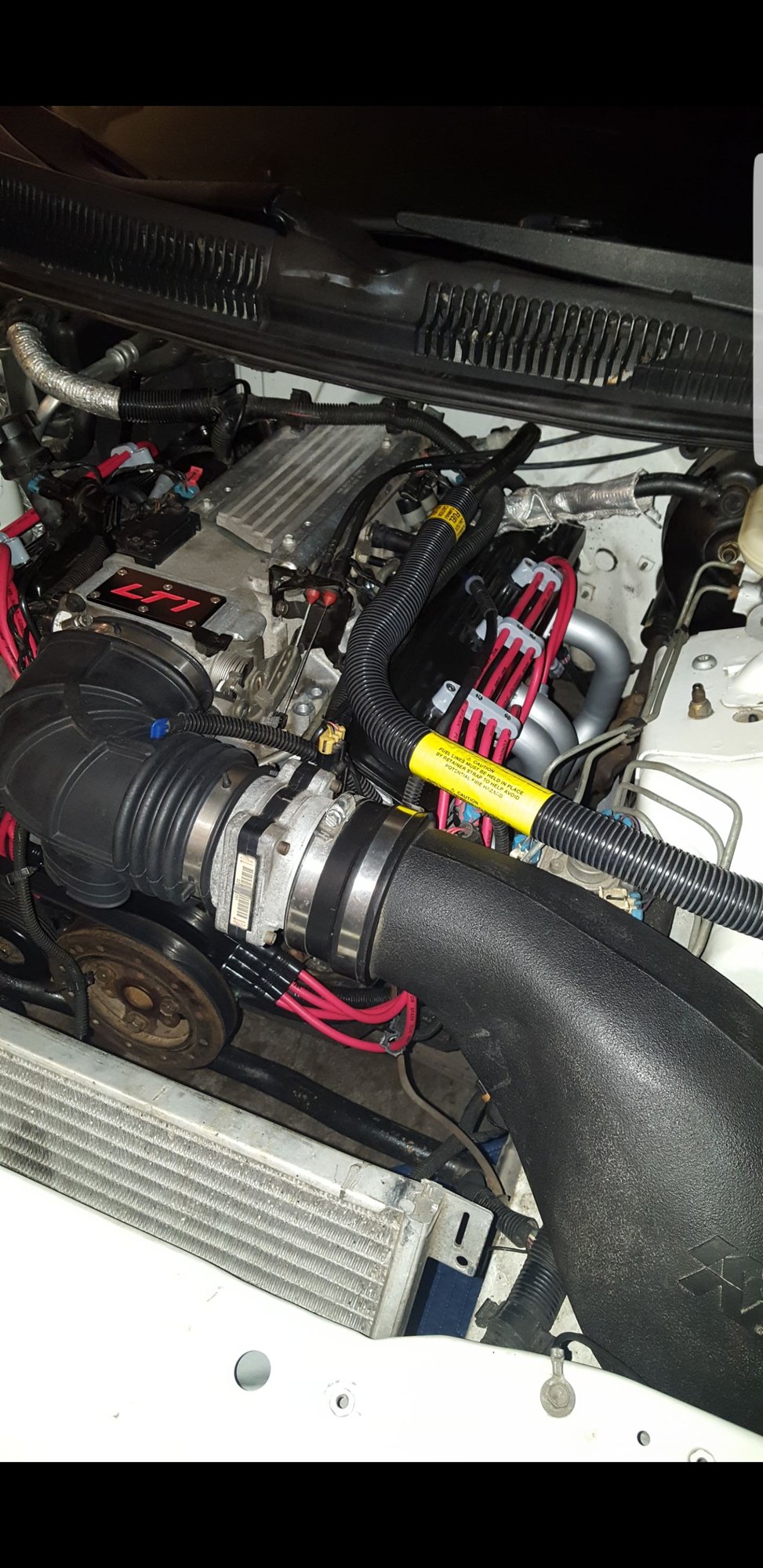

Pics of my MACS and y-pipe.
20k miles on them, zero leaks, perfect spark plug access, and excellent ground clearance.
Car traps 108-110mph with these headers and a small 215/224 cam and stock un ported heads.
