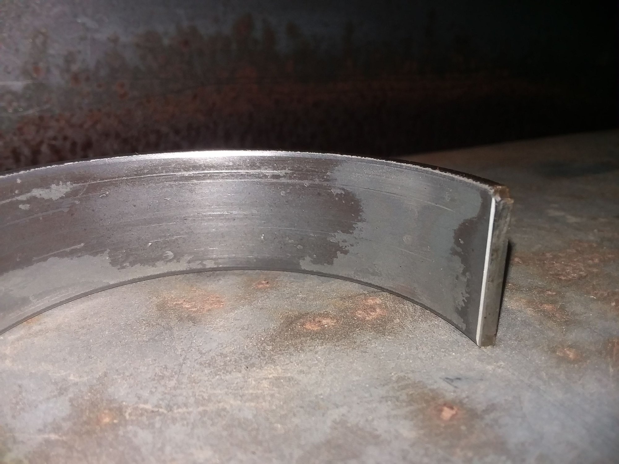

Just pulled the main bearing out. What do you guys suggest based on how just this one looks?

At this point If it were "me" I'd just go ahead and replace the bearings. You said you'd planned on replacing the mains as well but you're gonna need to pull the crank to get to the main bearings in the block unless you're really really careful and somehow manage to take all the mains lose and try to roll the bearing in, ugh, I just cringe thinking of this. Anyway, personally I'd pull the engine, and do it the right way if I insisted on replacing bearings. Have the crank checked, chamfered and polished. You mentioned replacing bolts... If you're planning on putting ARP bolts in the rods you'll need to have them resized. Isn't this starting to sound like a whole lot of work? Put it back together, change the spring in the pump to a Z/28 spring and save your money to do the job right. I'd find another block of possible that way you can freshen it up in spare time and have it ready to go in the car when YOU ARE READY. That way you don't feel rushed or pressured to get it done.

Bearings look like those with 167K miles on them.

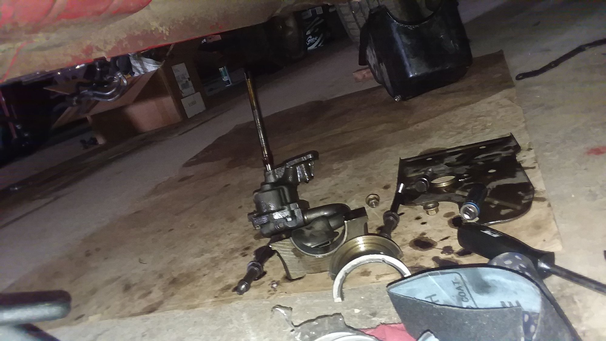

Well, the main bearings do not look as bad as i thought since i saw a tad bit of coolant in the crank case. All main bearings are in, just got rods next. I grinded down a screw and put it in the oil passage in the crank, rotated the crank and pushed the top main bearings out. It works with install too. Hope this helps someone !Worst part of this job with engine still installed in my opinion so far is the oil pan clearance, rolling in the thrust bearing and 1 main over the cross me
mber. Got the melling 10554 oil pump along with install. More pics after rod bearing install. Thanks everyone!
