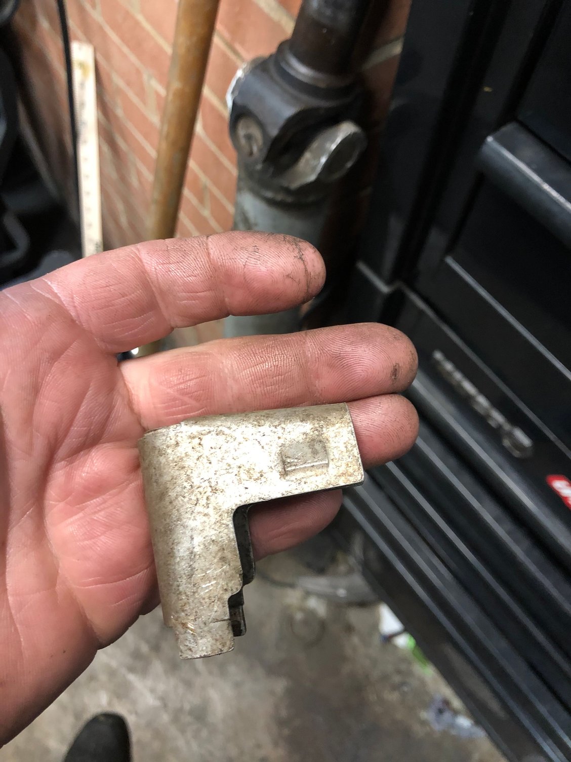

Been busy. Havent messed with it again yet. New wires should show up today, but Im working late. So will be tomorrow when I get back to it. Do those metal covers slip over MSD plug ends? I dont have mine anymore, but dont mind getting new ones. This car didnt have them at all when I got it. My other 96 did, but I want to say I tossed them because they didnt fit. But that was 5 or 6 years ago now.
http://www.taylorvertex.com/product-...=220066&sID=76
This is what I found with a quick search, still looking. Didnt see anything on MSD's site, but I wasnt looking for these when I was there. Ill poke around some more. I gotta get under and see whats going on with #6, I could be wrong, but I dont think theres room regardless which way it turns. But, this time, I did all the wires from up top, only a few plugs from below. So I didnt really take a proper look when I was did it. Tomorrow, Ill see whats going on. Got the roll your own kit, try to make'em better. Might even just wrap the top of each primary. That would pretty much solve that issue altogether. As well as use the fiber sleeves I already have.

Hey man, I can check a little later but they might work with a little persuasion. My MSD boots are kinda thick so it'll likely be a tight fit. I never used mine and could only find this one so I honestly probably tossed them along with the old wires.

Maybe the third dipstick tube will be the charm...

Finally!!!!!!
I caved and towed firechicken to my buddy"s shop. Got it on the lift, loosened passenger header, damn dipstick tube literally fell right in.
Then, drove it around, still had a miss. Those wires I got from the guy here, were knicked alll over the place. He has a really dark bay, and was able to see the wires arcing. So, swapped all wires, got the MSD roll your own kit, got 10mm wire holders, wrapped wires with few wraps of electrical tape. Today, im wrapping the top of the primaries, not much, just enough to prevent wires from ever getting burned.
