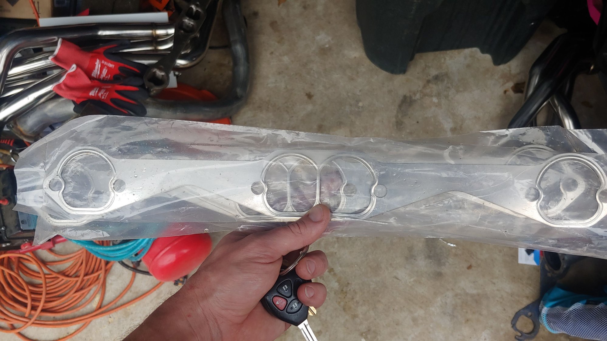

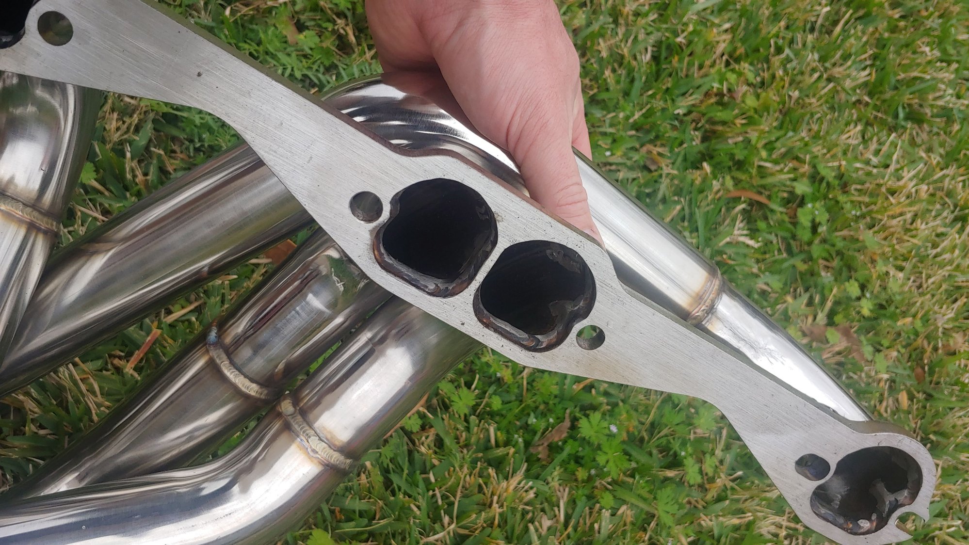

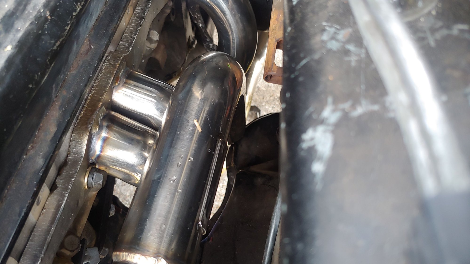

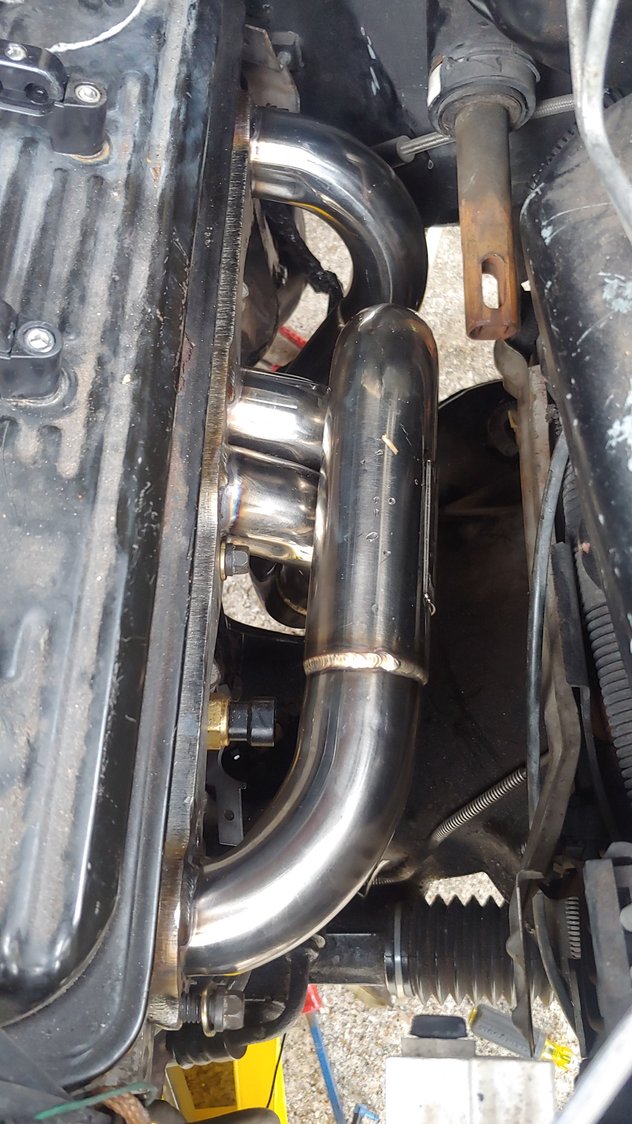

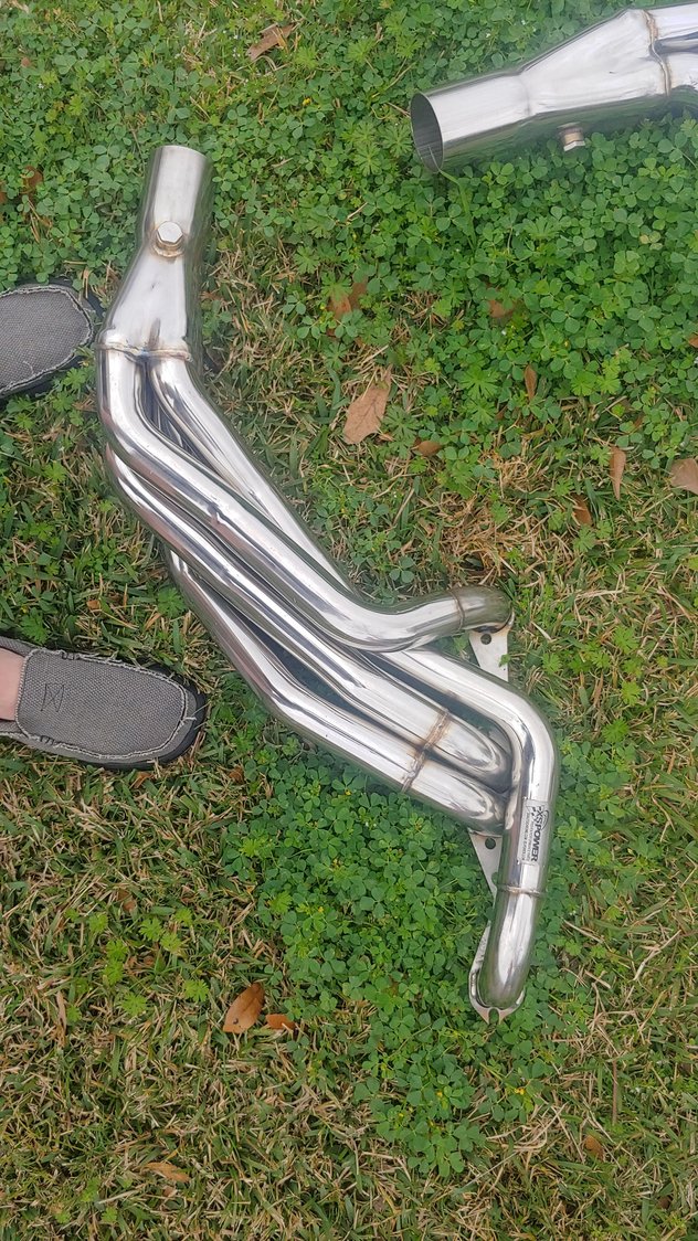

According to LPP on another forum, ltxtech i believe it was, they had XSPerf/SSAutochrome do the headers for them. As pictured on XSPerf and SSAuto's sites, these are indeed same headers. So, that's good. 300$ price, better, but i dont think they're making more. Limited stock type deal, so thats bad i guess. LT1 isnt a hot seller.
They look great. Nice, thick, straight flange. Stepped up design, AND primaries cleared for bolts. Couple clearance issues though. Got a few mocked up pictures as i plan to wrap them.

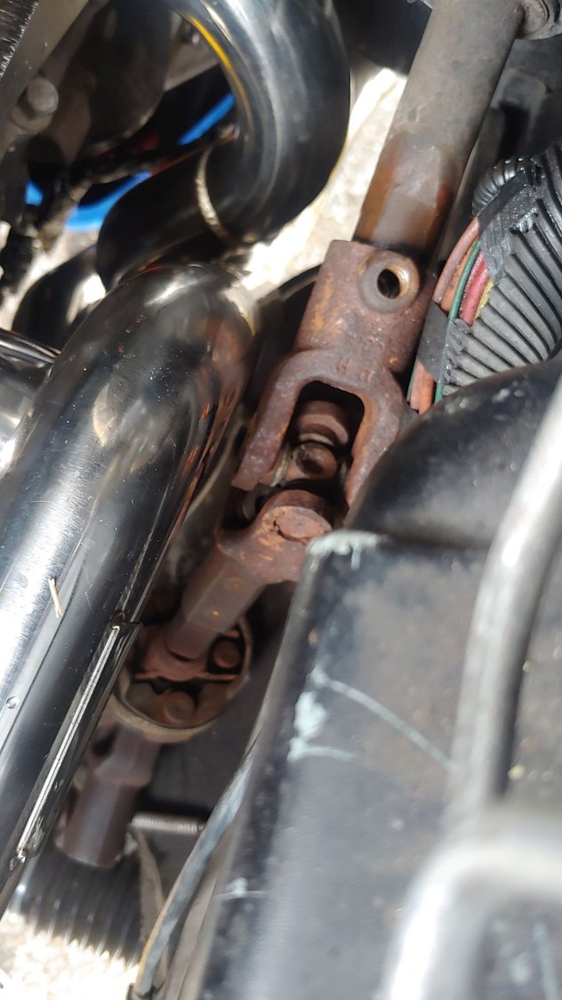

Driver side, near collector, it touches frame rail. I have new poly motor and trans mounts installed already.
Im pretty sure steering shaft will clear. Thats the widest point, but am a bit concerned after i wrap them.
​​​​​These are just mocked up, but both slid right in after removing spark plugs and steering shaft. Can probably do it without removing shaft, but i had to in order to get the crappy pacesetter shorties out.
Will post more pics later this week when i get to finish.

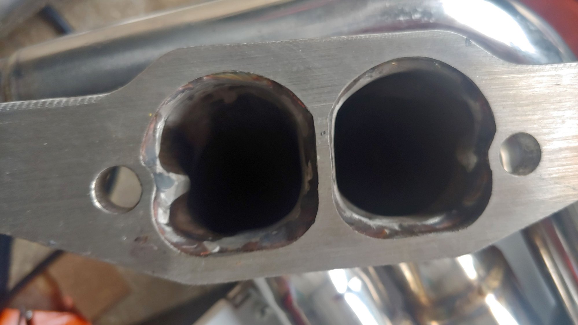

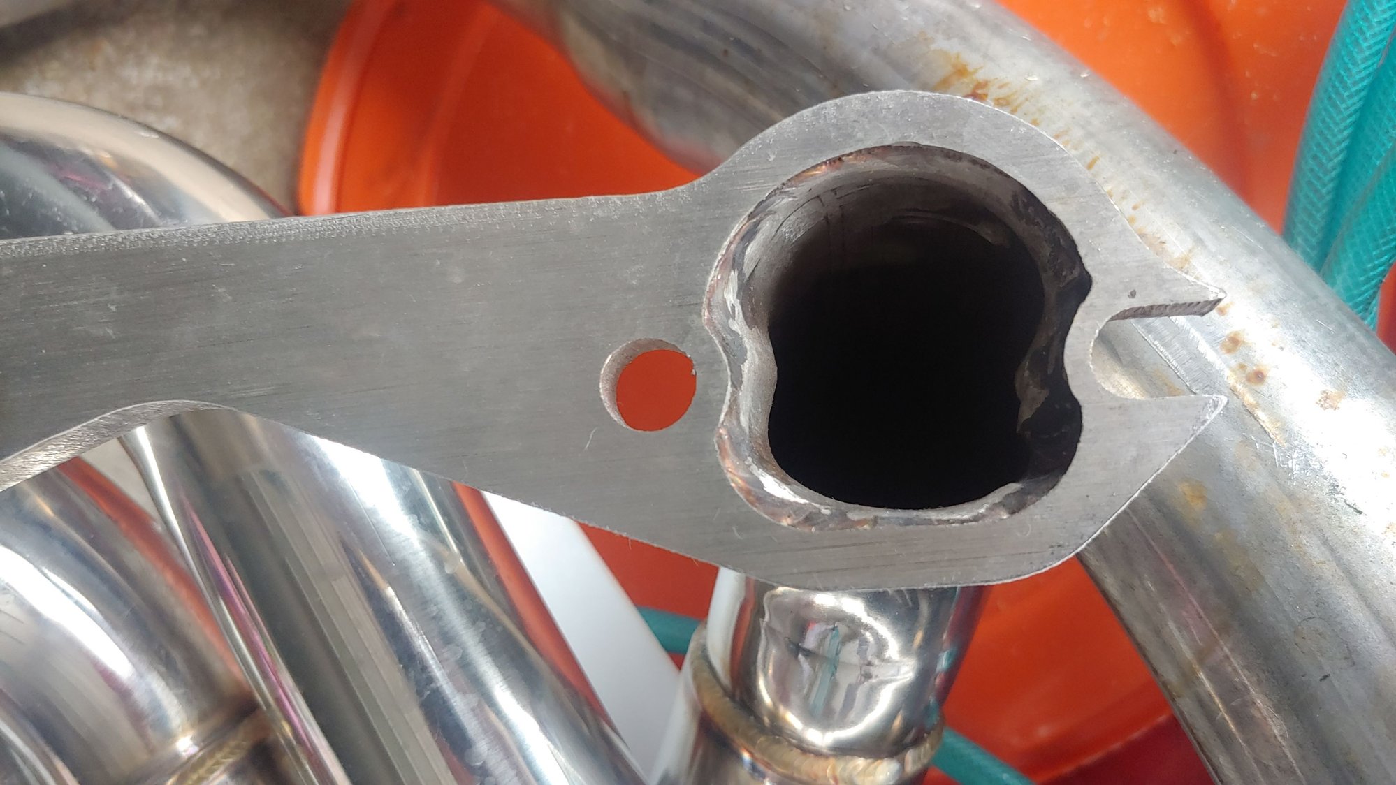

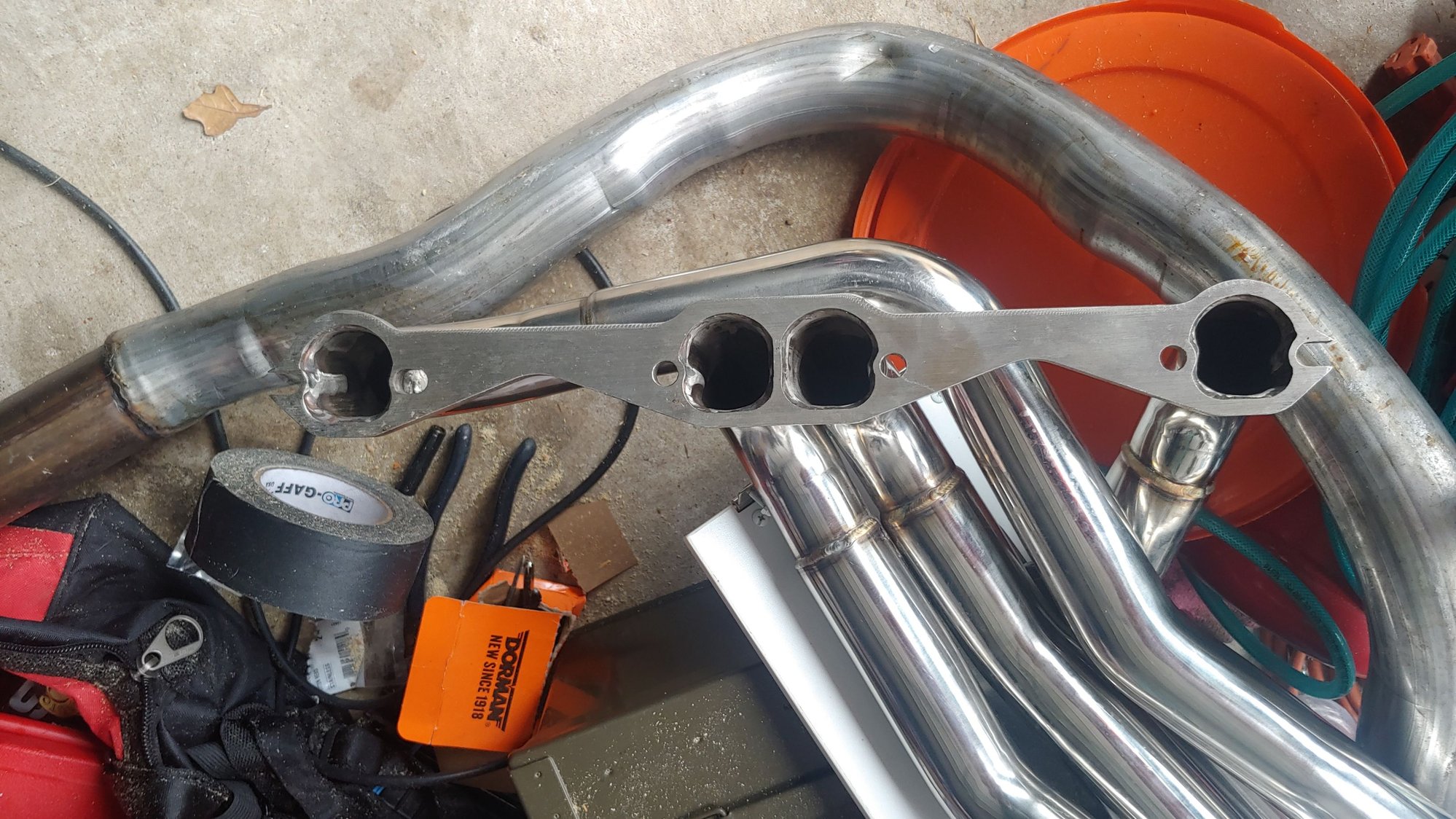

I don't like what I see with meat around the bolt holes protruding into the D shaped ports like that especially on the ports at either end. I would hate to bolt them up to a set of heads and have those protrusions blocking/impeding some of the exhaust flow. Although I have concerns especially with the ports on either end (pic may make the end ports look worse than they are) it could all potentially be a non-issue, would have to do some mocking up with clay or the like to know for sure. I can't say any of the headers I've run on an LT1 have had those protrusions but someone please speak up if my recollection is just wrong.
Is the ID of the primary tubes at the flanges a true 1-3/4"? Some of the cheap headers advertise 1-3/4" but have measured out to 1-5/8" ID. How does the merge spike look?

Ill take better pictures of the primaries and flanges tonight. It did not seem to be an issue, but this is also NOT a high performance engine. Might be a concern if youre trying to perfect everything, but will take better pictures tonight. #1 and 7, 2 and 8 seem to be just fine. But, possible I didnt notice something.
They claim on the site 1-3/4 to 1-7/8, I have not measured them.

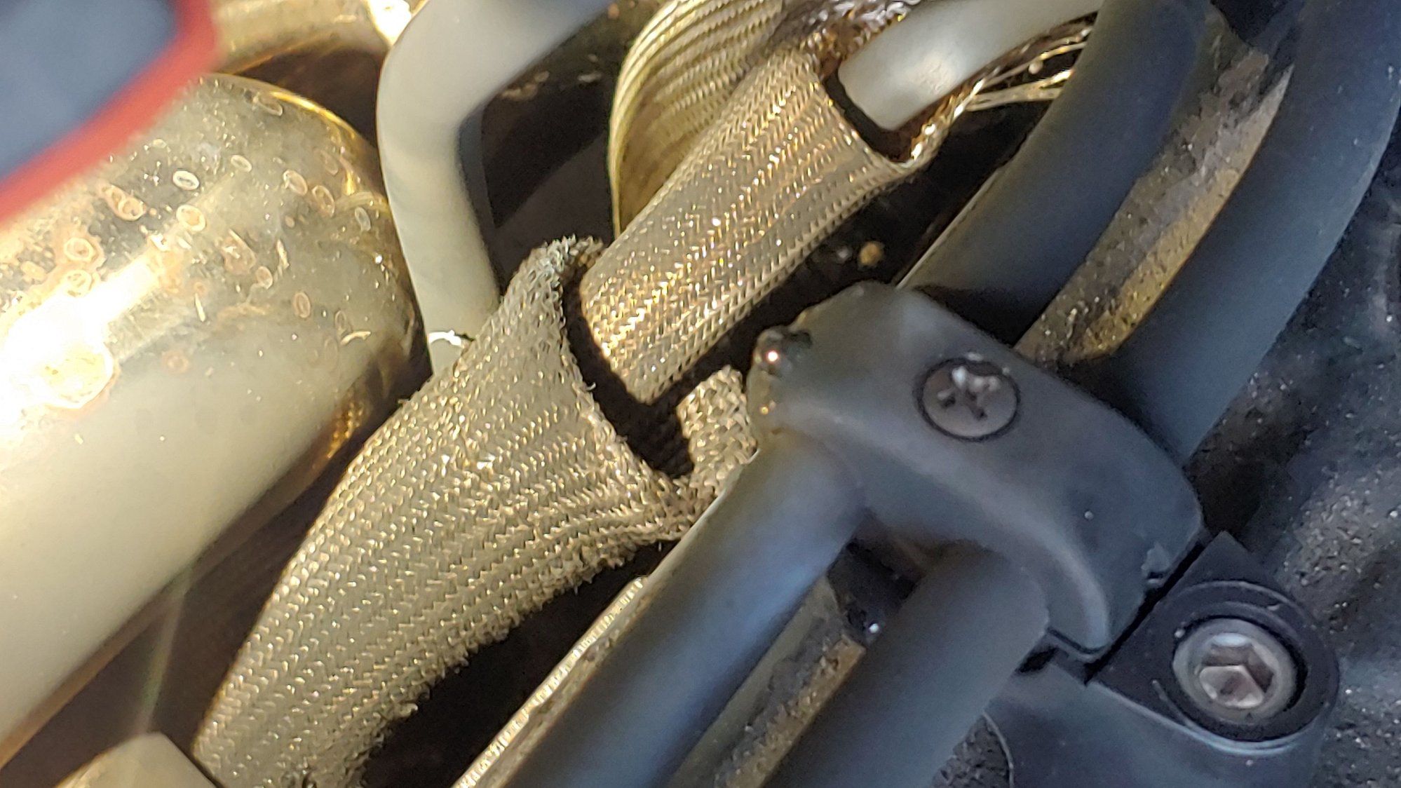

Wrap is not necessarily for the spark plug wires, as I have the OTVC kit, and the ends are essentially triple wrapped. Kit came with a single thin fiberglass sleeve, I have some I think cool socks left over from previous LT1, so slapped those on. These are the double layered, double stiched, with the metal ring at one end. Forget the brand. My main concern is that main body harness next to the steering shaft. On the pacesetters, it is way too close, and Im sure would cause it to burn/melt in a matter of days or weeks at most.
With LSx engines, the header design is a little better to deal with this issue, especially on fbody cars. So, I can see it NOT being as much of an issue. However, Im being paranoid and dont want to fudge that harness up, as that will introduce a world of other issues. Im actually leaving early today, so gonna try and mess with the engine bay some more while headers are out. Im definitely sending the wraps I got back, already coming apart and I havent even unrolled it yet. Second pack is even worse, and still have plastic shrink all over it. So, have time to dick around and see if I can fix all the wires out of the way.

I'd definitely be taking a bit of time with a grinder in those primary tubes. You don't have to get too crazy but if the tube is welded all the way around I'd take as much protrusion out of the tube as possible. You can measure the port width and also the tube width and see if it's going to be a problem or not but even with the large ports my ported Trick Flow's have my Kooks headers give plenty of room around the port.

Couple pictures showing the inside better.
How much benefit do you guys REALLY think would be had by cleaning up these welds more? Remember, stock motor, only mods are these headers, Solomon tune, and removal of emissions stuff. Im not chasing tenths here.
On another note that'll make some of yall happy, im not wrapping them. I wrapped the driver harness with that stuff i got. Best i could without removing all the brake goodies. I didn't get pictures before it got dark because i got called back into work.

Added pictures to show its not that bad. Extremely less restrictive than the pacesetter shorties, and the hooker super comps were smaller primaries all the way.
Im curious, how are the Kooks flanges and bolt clearance? These are awesome, can get all 6 started with my fingers. I cant find any good pictures of the LT1 setups besides install pictures of the Kooks.
Ill chip away at it more Thurs if the weather permits. Get more pictures too. Had them both pretty much tightened all the way when mocking up, only clearance issue is the portion of the driver side K-member. Few whacks with a hammer will fix that.

Ports look better in the additional pics. The original pics made the end port look way skinnier than it really is. They appear oversized so you’re good. Unless you’re particular about that kinda stuff like me and Vicious just slap them on and enjoy. I’m the type to grind down the screw heads and **** on the TB blades but in my mind it’s the little stuff that adds up and that attention to detail is why some cars run harder than others. Most people couldn’t care less.

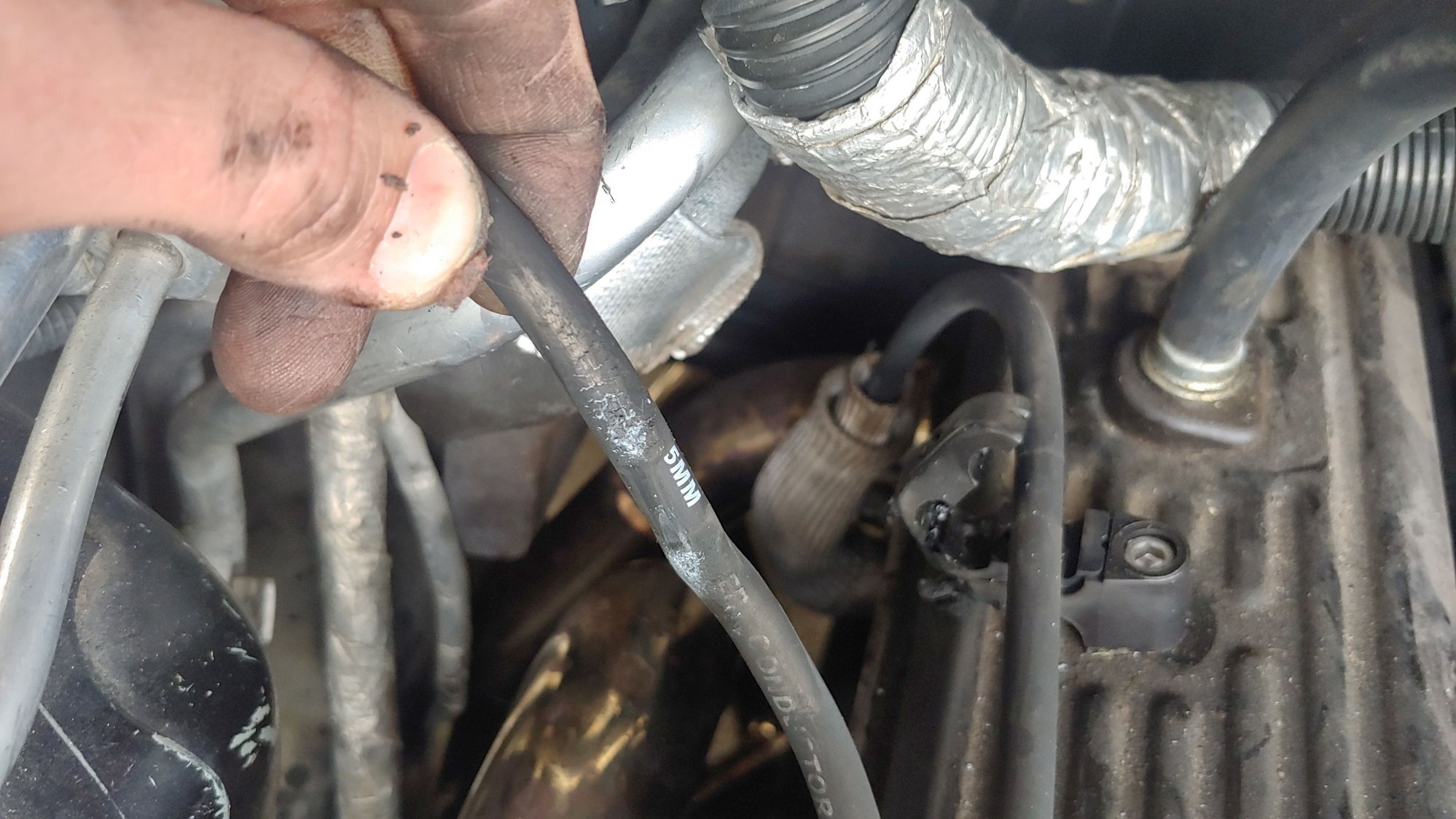

Was running just fine, drove to Bucees to get sone real 92 gas, engine light came on when almost home. Running funny, started hearing a funky dinging/ticking intermittently. Well, here it is. Cant frickin win with this damn thing.
Haven't gotten at it yet, just got home. Letting it cool off.
Old Feb 29, 2020 | 12:31 PM
demonsmokr's Avatar
Joined: May 2014
Posts: 436
Likes: 20
From: Houston Texas

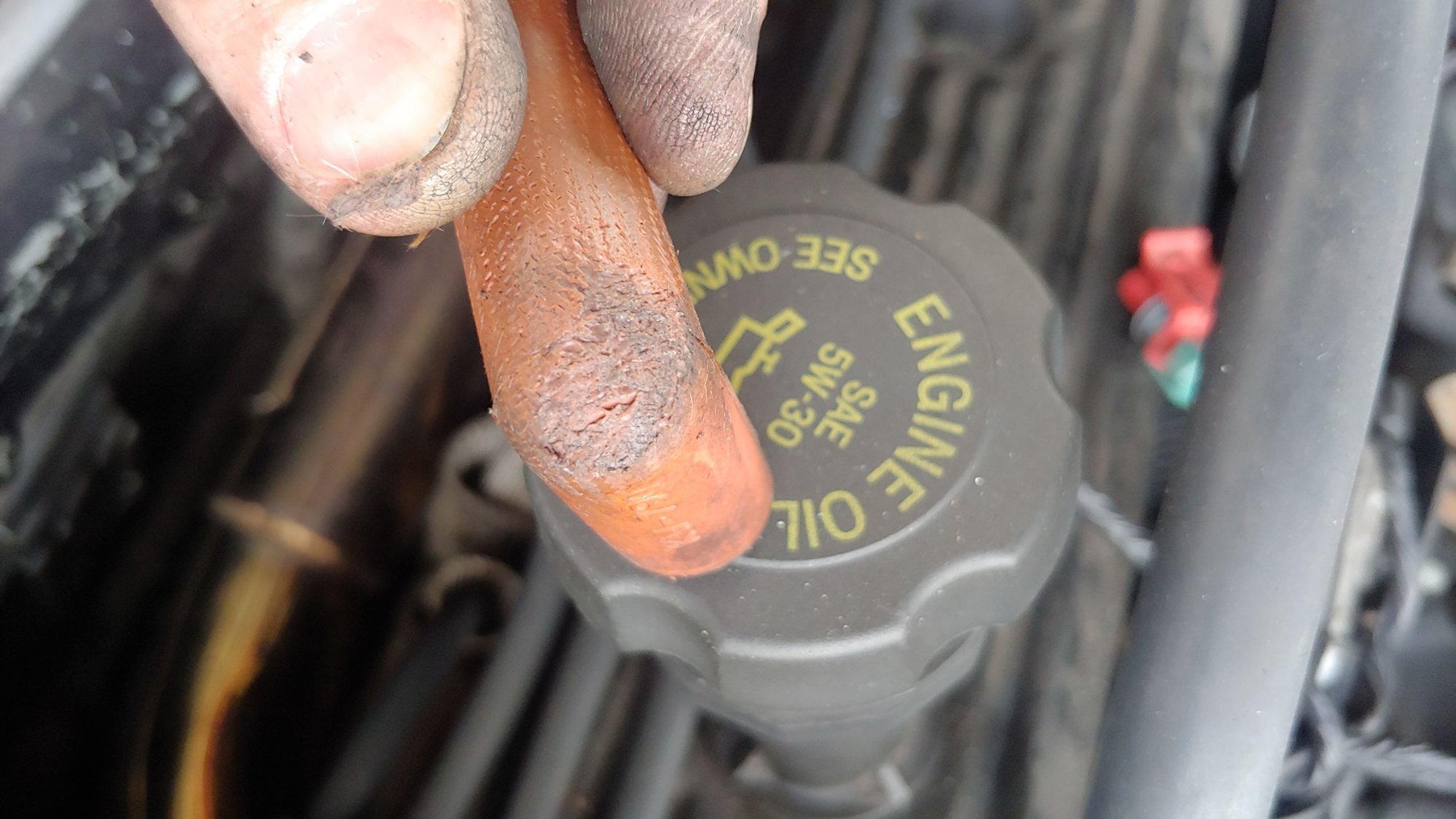

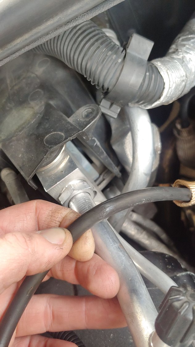

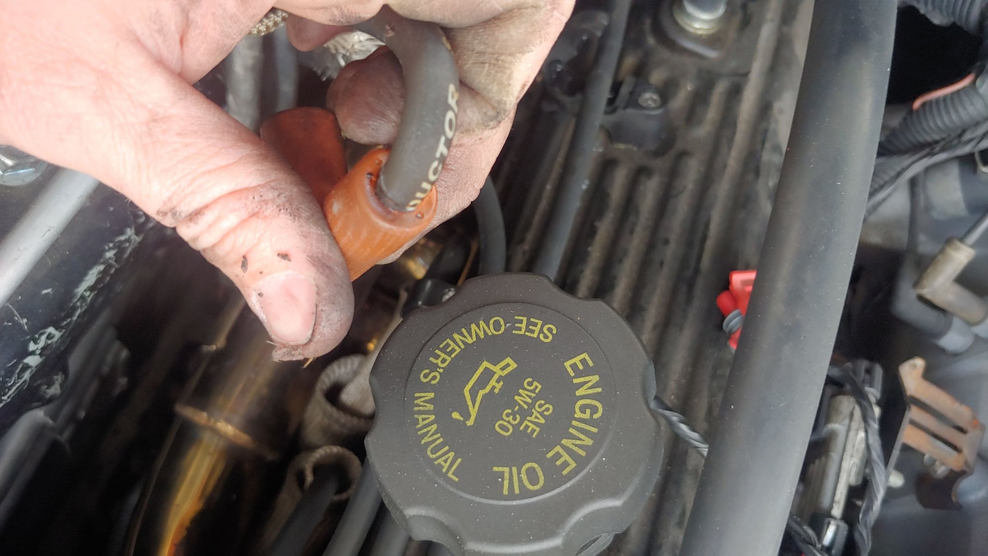

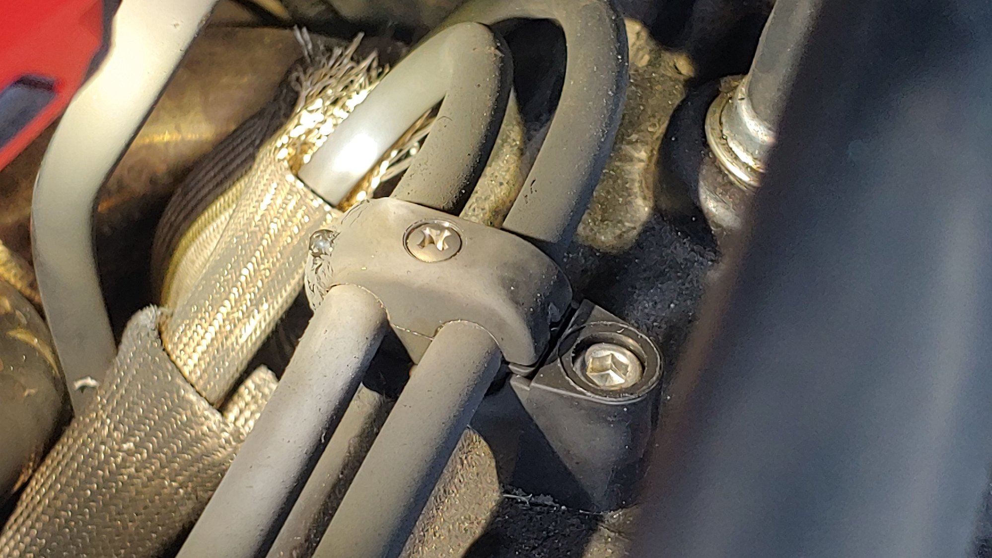

got these wires from a member here. Nothing against him, because he got ripped off more than me. But, still gotta replace at the minimum, two wires.
One arced out on both sides of the last clamp. Not sure why, they weren't nicked or anything. Wasn't very tight, snug, could probably slide them back and forth with WD-40 or oil without loosening.
Then, same one was arcing through the backside of the boot it looks like. Rubbed it with thumb twisting it for the camera, was more charred looking initially. Also, boot was getting hot enough to melt even though its tripled up with fiberglass.
not entirely sure if arcing in this third spot. Im going by wire damage as opposed to witnessing the arcs. Third spot could be due to clamp melting from the arcs from that upper area, and dripping down on the wire.
And i was gonna do the dipstick today so i could actually drive it. But noooooooo.
