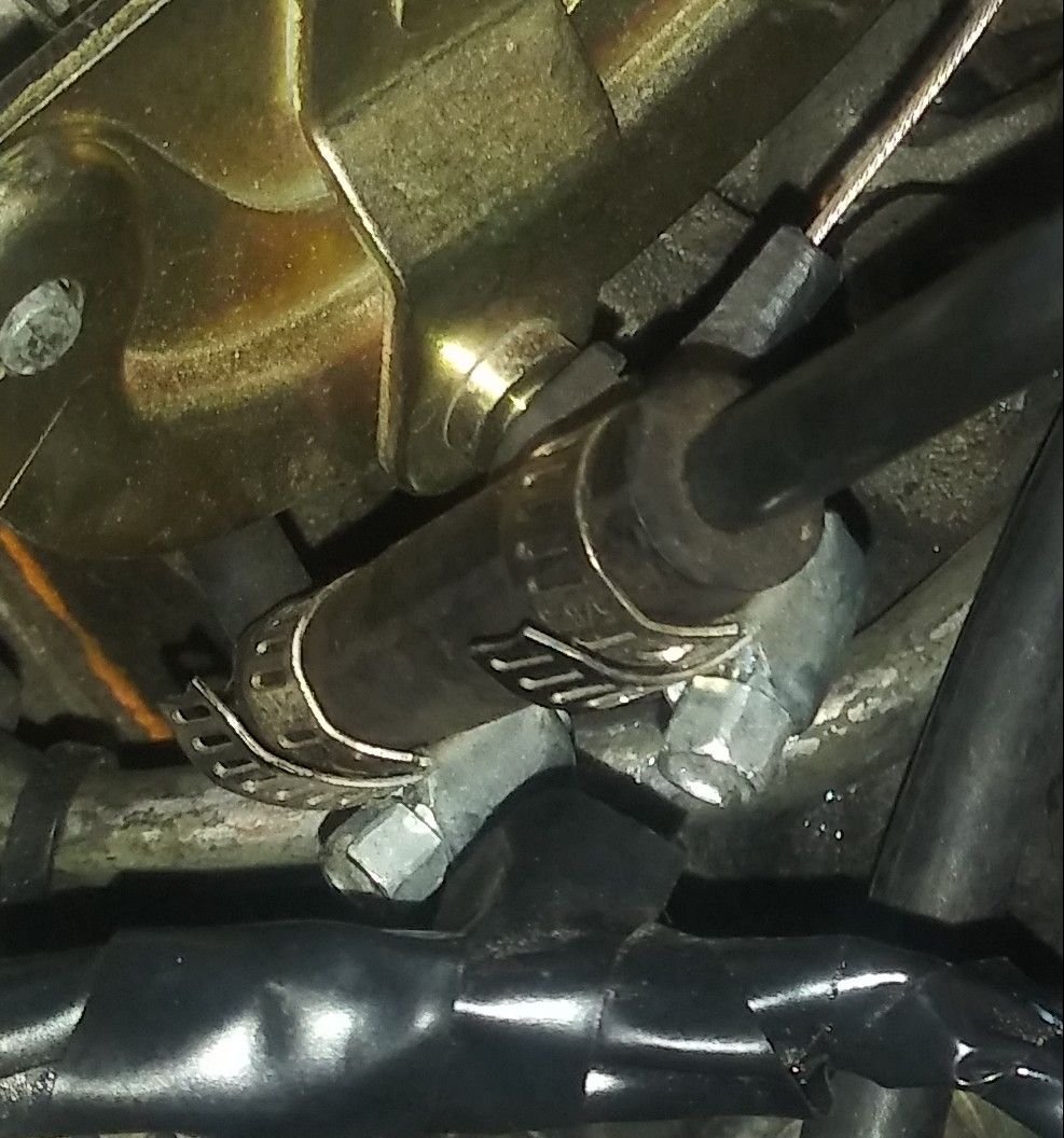

So I know it's been a good while since I been on this thread. I been very busy due to all this pandemic stuff. But hope all is well with you everyone. So the picture is the vacumm hose that connect to the evap solenoid. I broke this when I was taking off throttle body when I first got the car. I put a rubber hose and clamp it temporarily. But forgot all about it. Will this cause my long term fuel trim to be at 160 (both banks)?

IIRC this is is nothing more than a vent tube?
If it broke engine side of valve, would be a vac leak no?

I'll double check it later.
The other day while driving the the evap duty was showing numbers. Like 22, 33, 44 up until it got to 100
And if I'm not mistaken your not supposed to see those numbers unless there a leak.
It only should show 0-100 when stepping on the gas since that the only time the pcm commands it right?
Correct me if I'm wrong guys.
