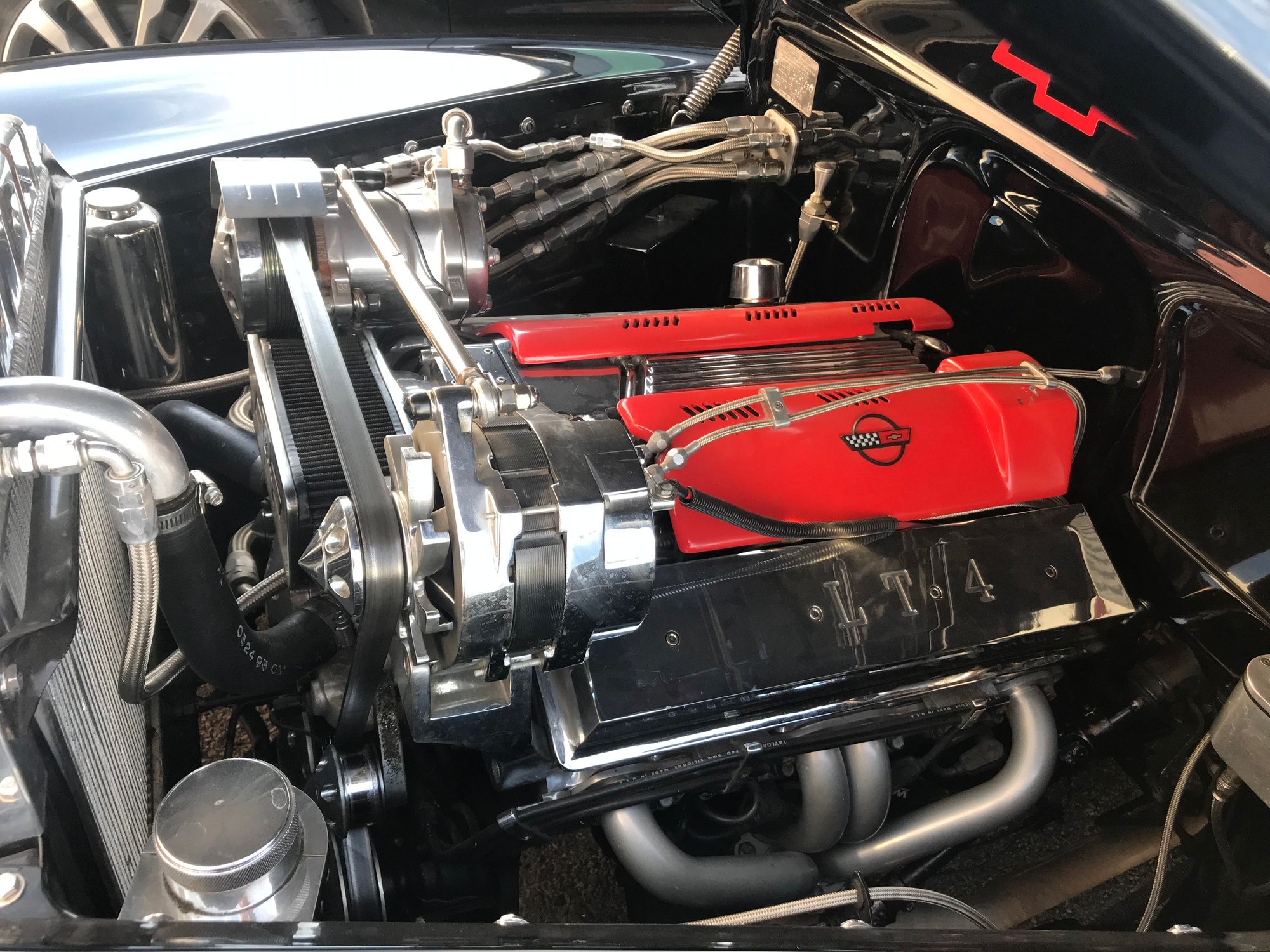

I’m new to this page and I’m trying to help my grandfather out.
He has a 1948 Chevy woody with a lt4 in it that puts out 650horse. Other than that I have no idea what any of the specs are.
I was wondering if you guys could help me out with what oil, how much oil and all that good stuff.
edit:
I don’t have much information on it at this time. It’s beloved to be out of a corvette not sure on what year exactly. I get that I’m not giving you much to work with but anything would be helpful.

650 hp? Yikes!
That is some crazy HP for a NA 97 LT4 Gen 2 small block.
must have those special triple hump heads and a 3/4 extra hot cam.
pull a valve cover off, should see some roller rockers. 1.6 if stock, but you never know.
mobil 1 fill from the factory.
muse dipstick to tell u how much.
somewhere around 5-6 quarts.

Pretty sure the OP is talking the gen V LT4 which was rated at ~650. If so op, wrong section. This forum is for GenII dinosaurs.
can you see the pic he posted?
looks like a Gen 2
looks like a Gen 2
Not until just now. OP got the two mixed up.

I like how simple and clean everything looks. I must say 650 horse seems severely optimistic for an NA LT4 especially with those diameter and length primary tubes, stock manifold, that warm air filter setup, etc. It's certainly possible to do and I'm sure it's been done before, but we're not talking a streetable setup nor one that looks like what I'm seeing in the photo. Anyways, if the bottom end of the motor has been built, I would consult with the engine builder because the bearing clearances will dictate the proper oil viscosity. As far as how much oil, that will depend upon the oil pan that is being used. I would put 5 quarts in it and see where that comes to on the dipstick and take it from there.

OP
more like 350 HP. but cool ride
If it has a stock pan the oil fill is 5qts. Aftermarket pan can hold more so just check the dip stick after adding 5 qts...and starting the motor for a moment to fill the oil filter
If the motor was rebuilt with wider bearing clearances than stock than typically that builder would spec 20-50 but otherwise 5-30 oil is what they use
The distributor is called a Optispark and is on the front of the motor behind water pump. If the motor runs don't touch it. The cap & rotor are scheduled for 100k mi replacement
