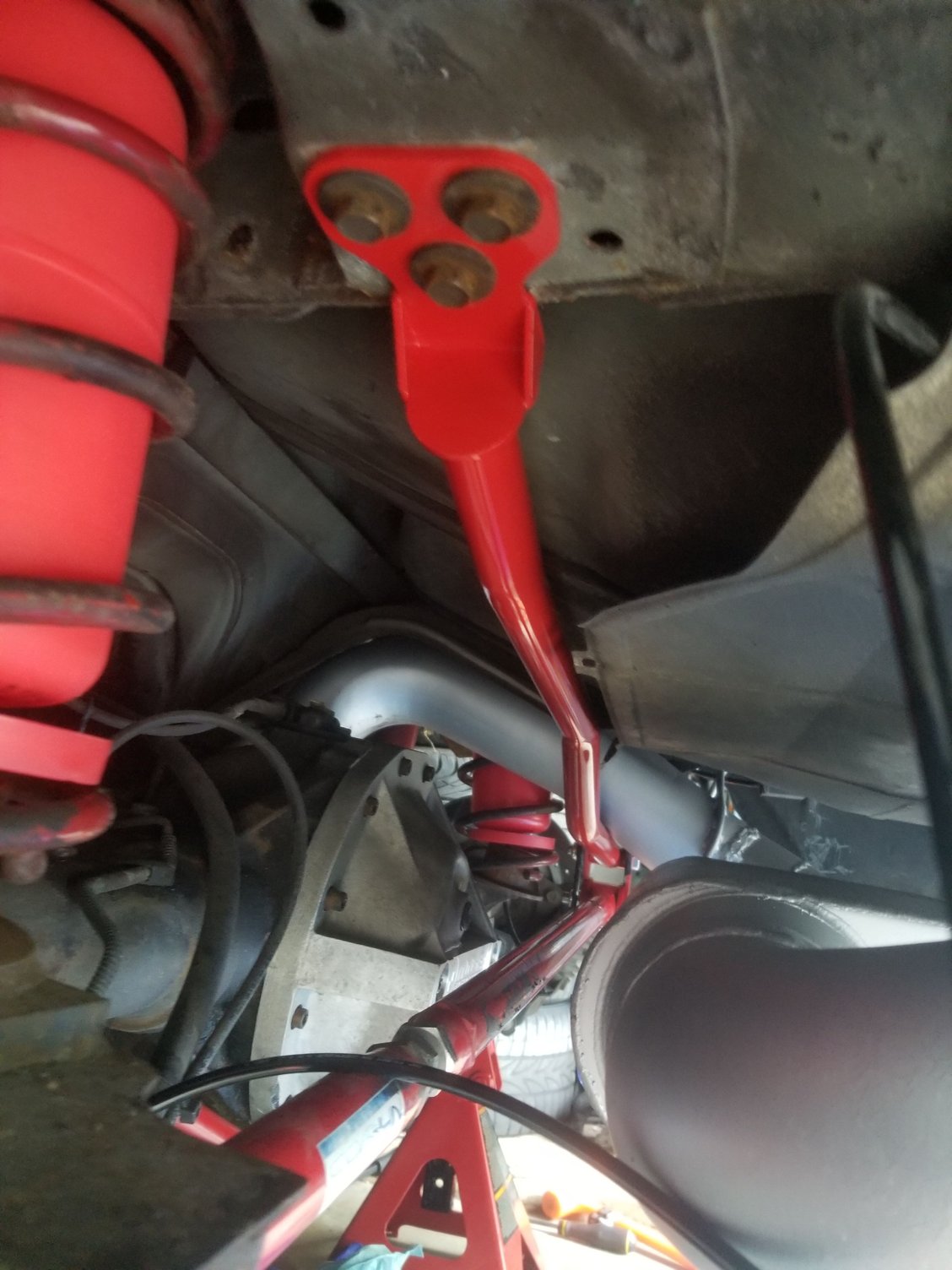

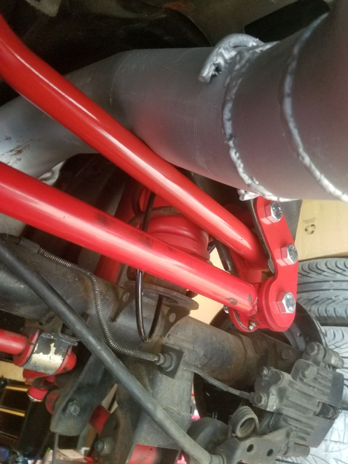

I have the 4 inch mufflex installed on my build and it has very good ground clearance. You will need to buy a panhard bar relocation kit for $130 so it can have the clearance to fit over the axle.
Other than buying that item, it fits great and without hassle. And it does sound very deep , i like it better than my 3 inch magnaflow catback.

[QUOTE=350 groundpounder;20271559]I have the 4 inch mufflex installed on my build and it has very good ground clearance. You will need to buy a panhard bar relocation kit for $130 so it can have the clearance to fit over the axle.
Awesome, thank you for the pics! Do you have the mufflex 4" Y pipe? I was curious on the clearance for that piece.

I put 5500 miles on the mufflex y pipe with no clearance issues. I had pacesetter long tubes though. Never touched a speed bump .

SRZ, do you have the mufflex 4 inch catback? That is amazing if you got that to fit over the stock panhard bar. My mufflex piping only cleared the relocated upper panhard by less than a cm. Every car is different apparently.

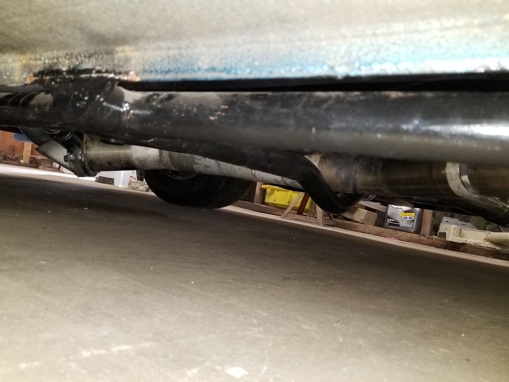

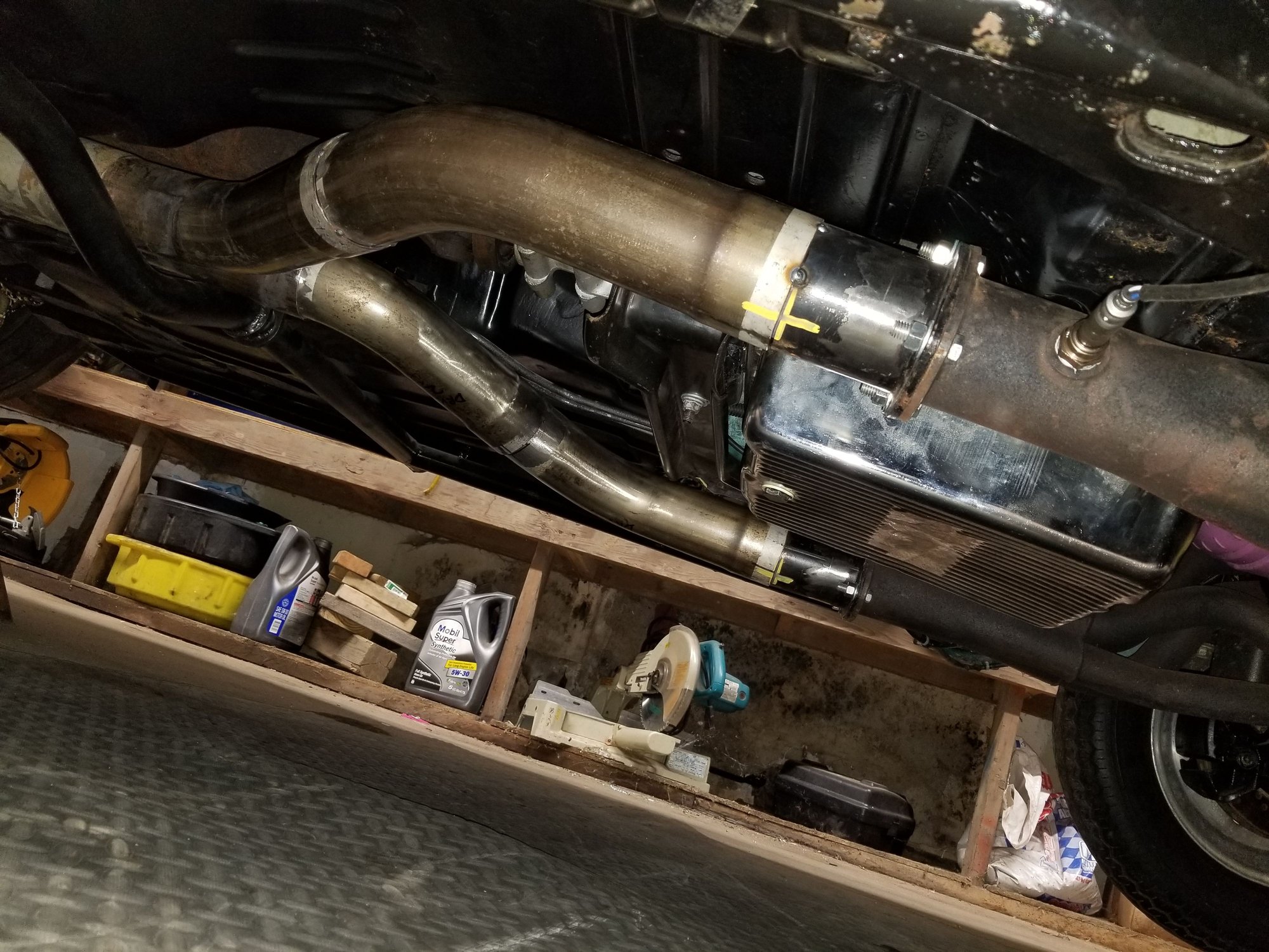

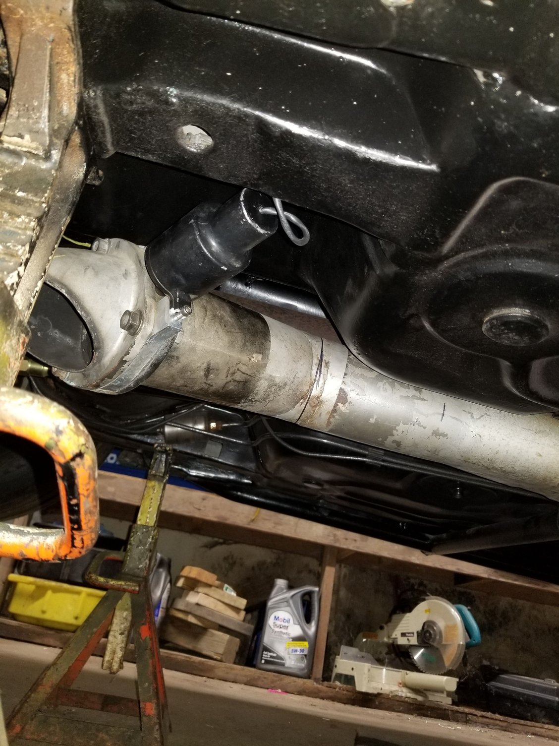

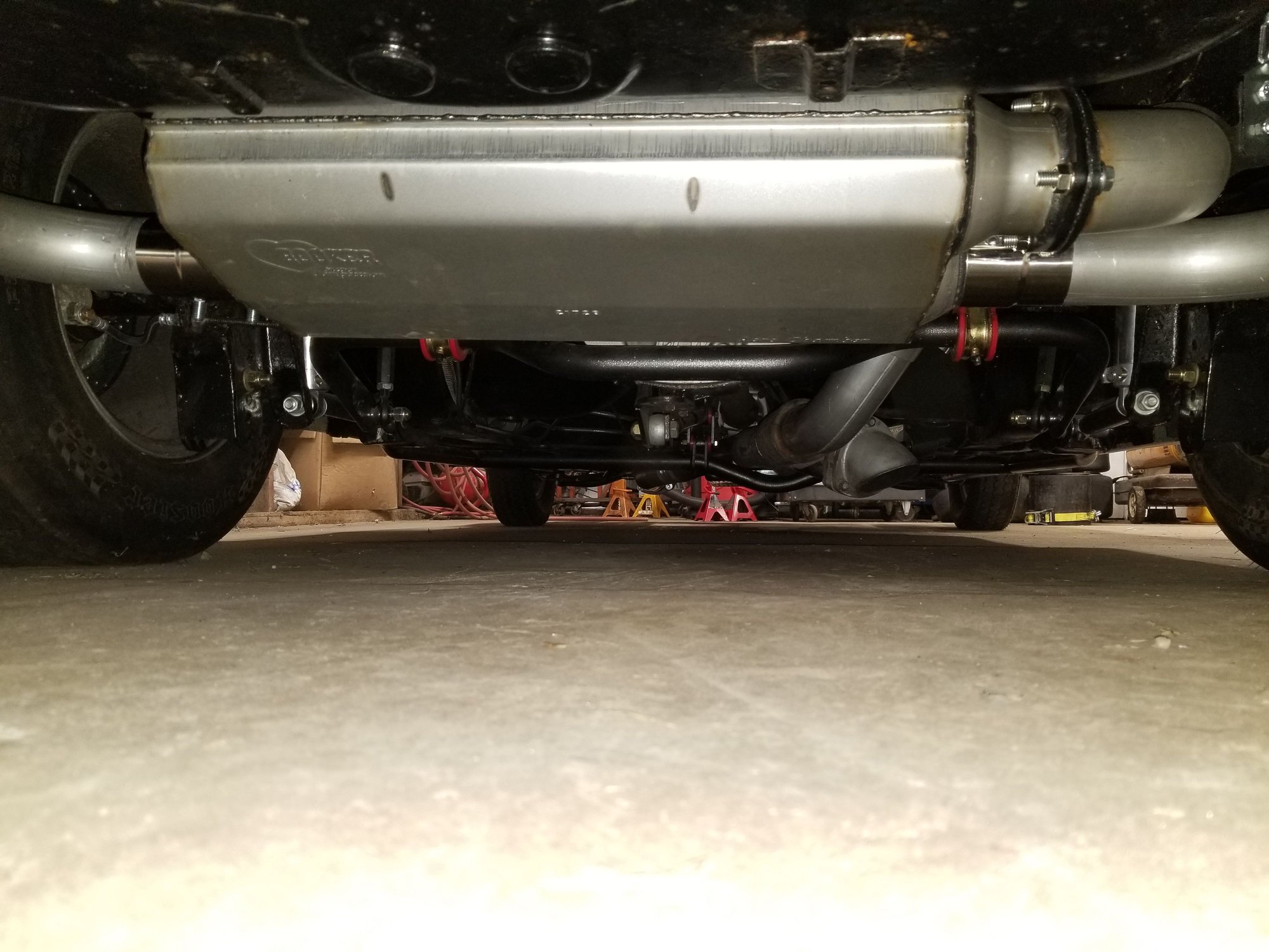

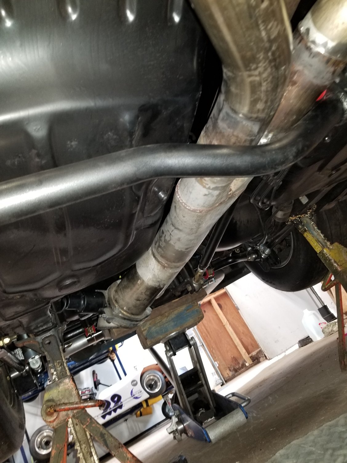

I ended up ordering a Hooker aerochamber cat back. Then decided on building my own Y pipe with 3" mandrel bends to a flow master 3-4 merge with a 4" cut out. Then back down to 3" to connect to the hooker system. I have terrible luck with things fitting like they are supposed to. that and Mufflex dont respond to Emails or answer questions.
Old Aug 26, 2020 | 06:10 AM
nickp's Avatar
Joined: Mar 2007
Posts: 412
Likes: 21
From: Southern Michigan

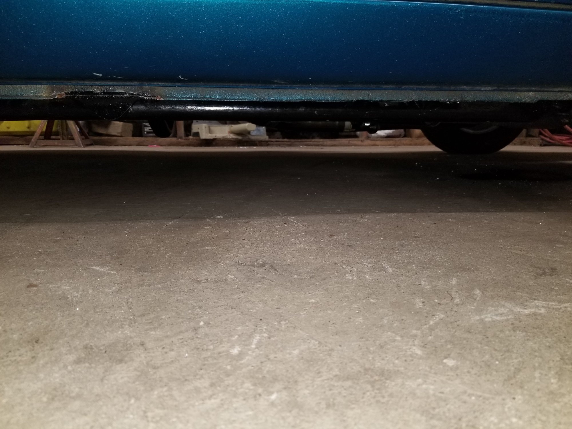

Heres the home made Y pipe to 3" Hooker aerochamber cat back. The 4" QTP cut out tucks pretty nice in the void behind the passenger rear seat. Overall ground clearance is awesome. The cut out is the only part that hangs down almost as far as the BMR crossmember and I might be able to tuck it up a little bit more. The rest tucked way up tight. I'll get some better pics after its fully welded and I can get it outside in the light. I am very happy with the way it turned out. It was not a difficult project at all if you have some basic shop tools.
