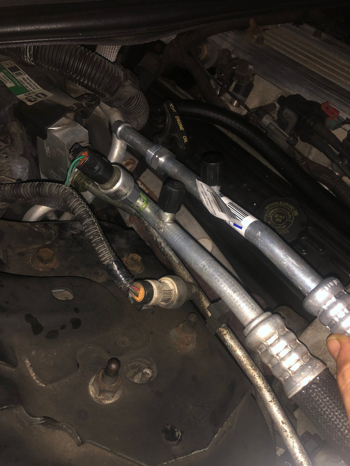

Bought the low ac line that runs from compressor to expansion block. It came without the ability to hook up that sensor. Will I still have ac if I leave it disconnected or do I need that sensor?

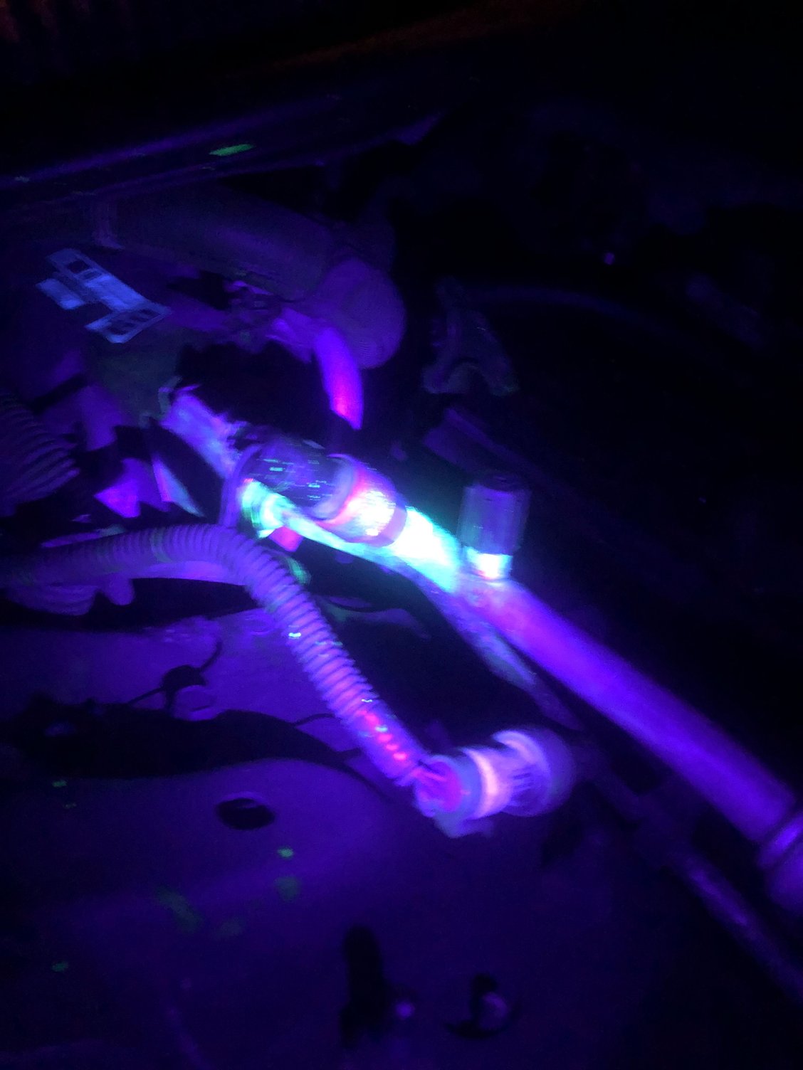

New rock auto line on the right
Refrigerant leaking out sensor and expansion block

93s had a low pressure switch (which the port is missing from your new pipe). You could conceivably bypass it with a jumper if you need to (not saying that is absolutely safe in all situations).

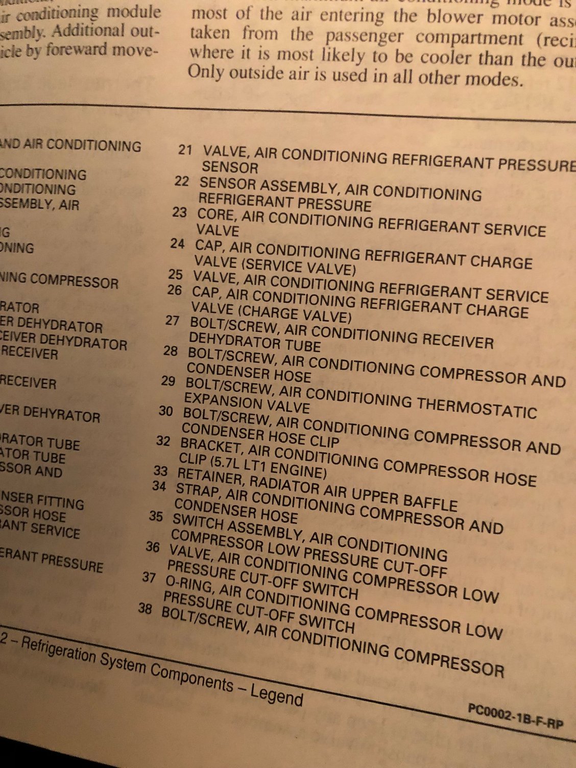

It disables the compressor if the pressure drops below 6 psi and re-enables it at 27 psi. Just a change in architecture, I guess. My assumption is that when they changed the computer in 1994, they incorporated programming to use the pressure sensor in the high side to serve the same function.

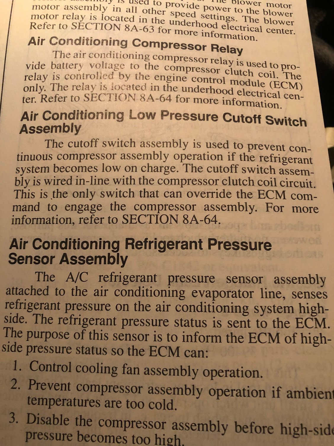

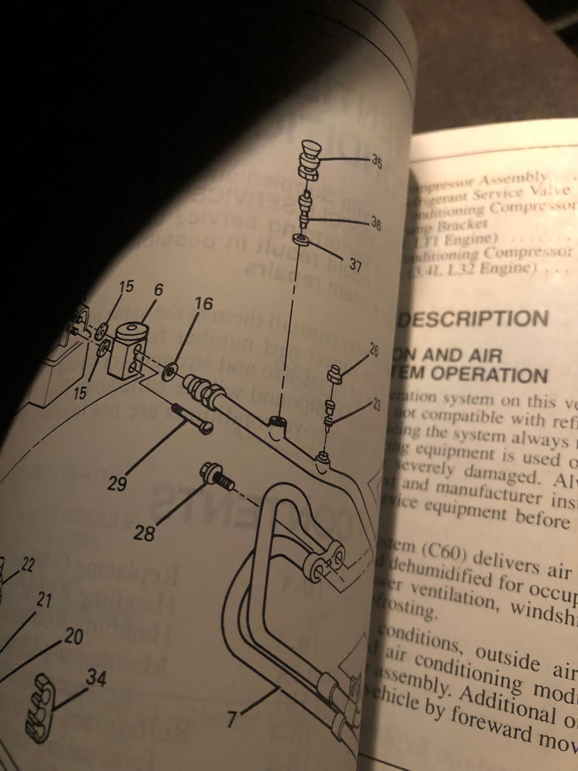

Now I have a 1993 service manual thankfully. Probably 1000 pages in the book. Hard to come by but according to what it says in the pictures I could run the line without that sensor?! The thing is once refrigerant gets too low the compressor won’t shut off at it’s normal time to prevent possible damage to compressor?! Can someone verify that? I don’t see how a 93’s A/c seems more advanced than 94-97’s..
Diagram
#35 and #36
Low Cut off switch detailed
with all that being said I could run without the sensor, I’d be running just like a 94’s through 97’s right?...

Yeah, that's the chance you would take if you jumpered it out in that it would not shut the compressor off if pressure got too low.
