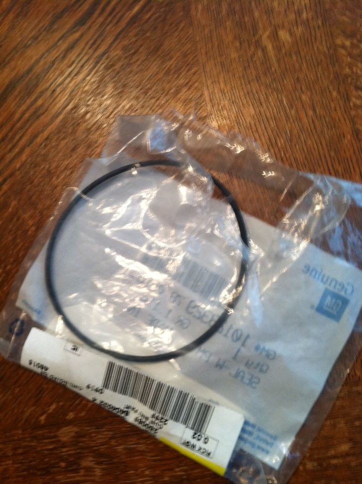

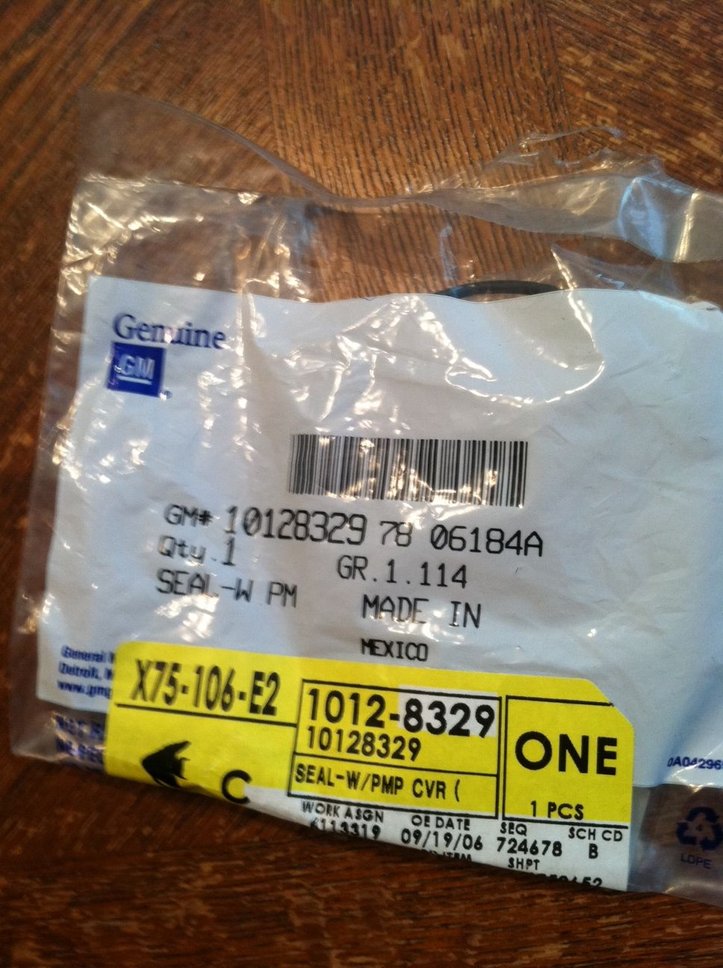

The large O ring gasket for WP is available.
