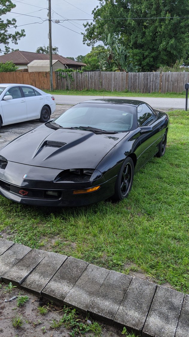

here's mine, no 707 but she's got an LT4 head and a hot cam, long tubes, 58mm, and a nitrous kit

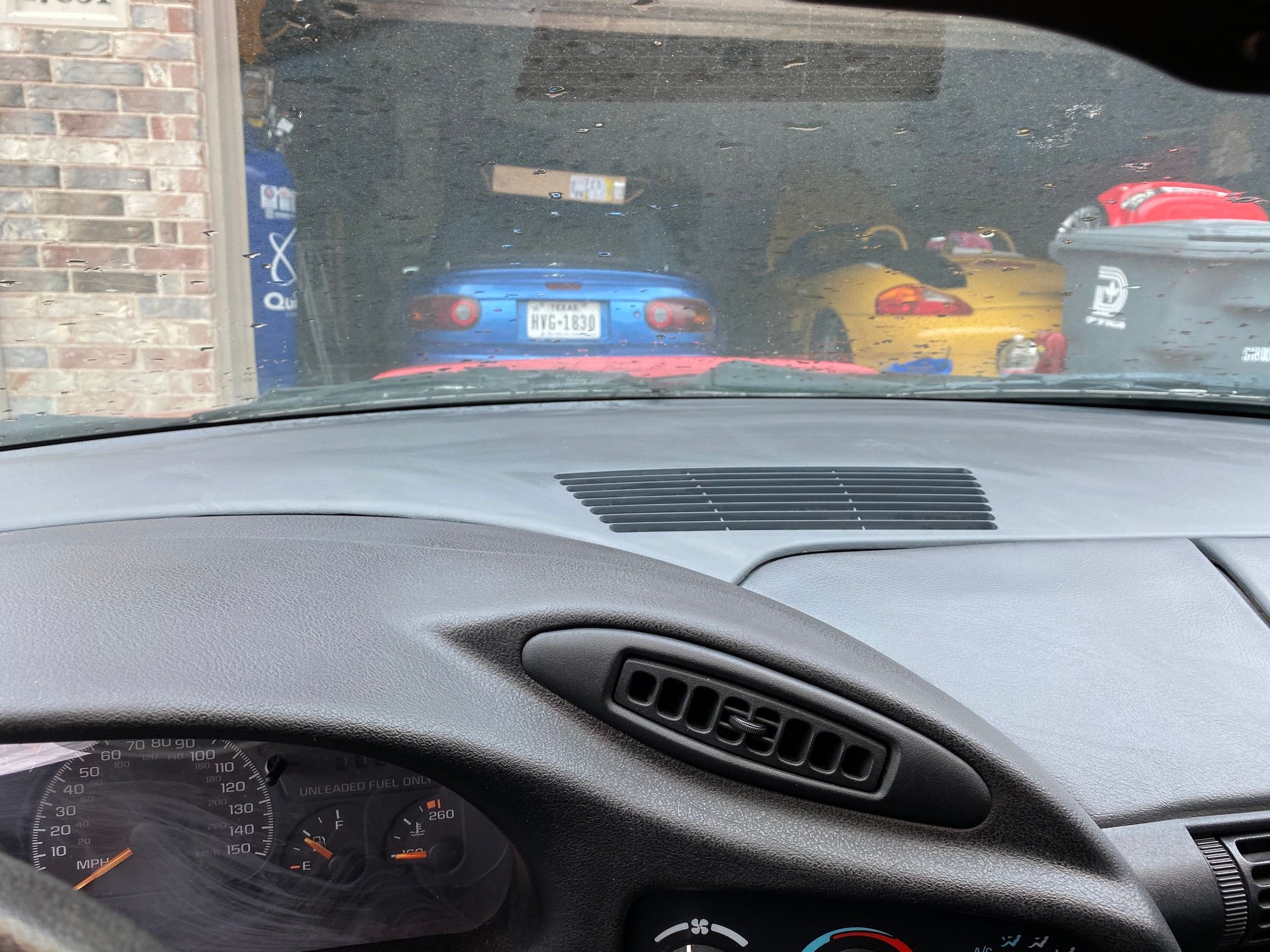

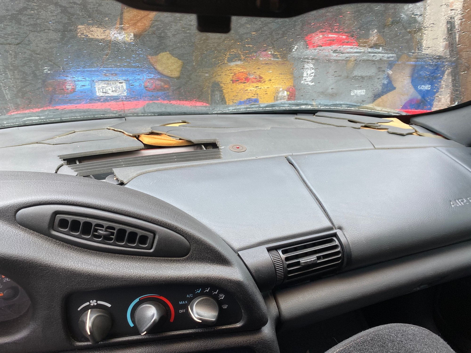

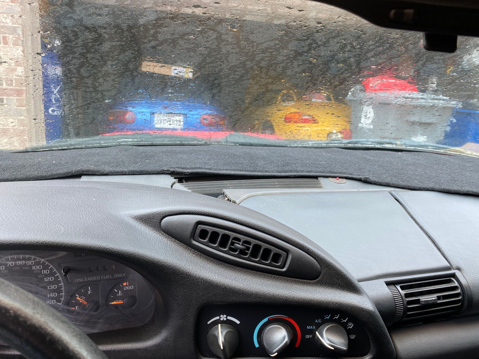

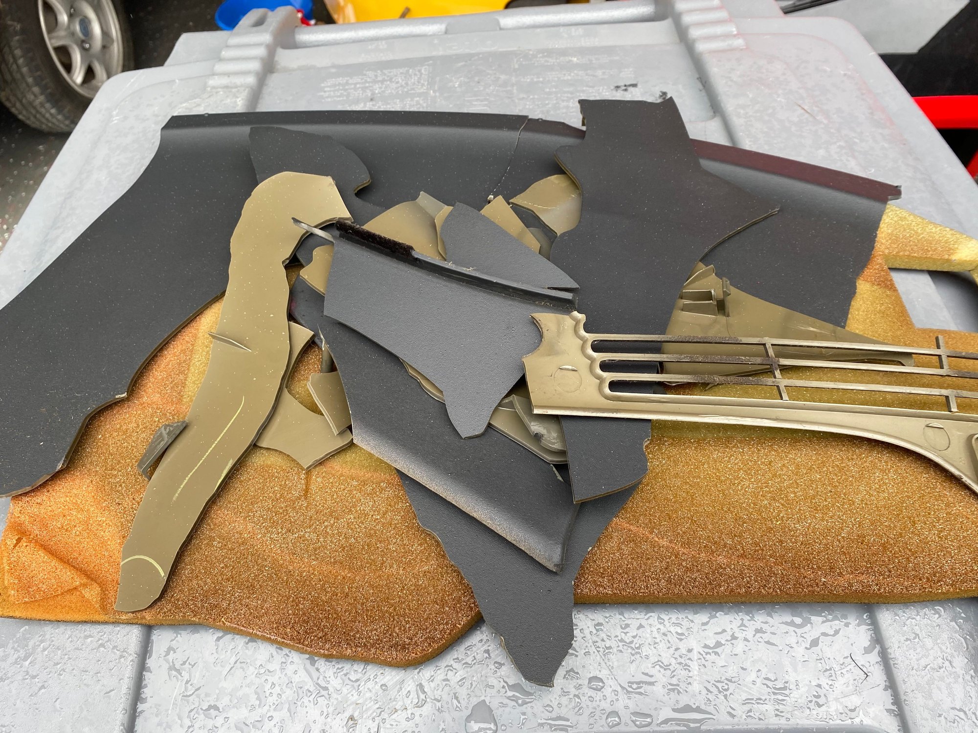

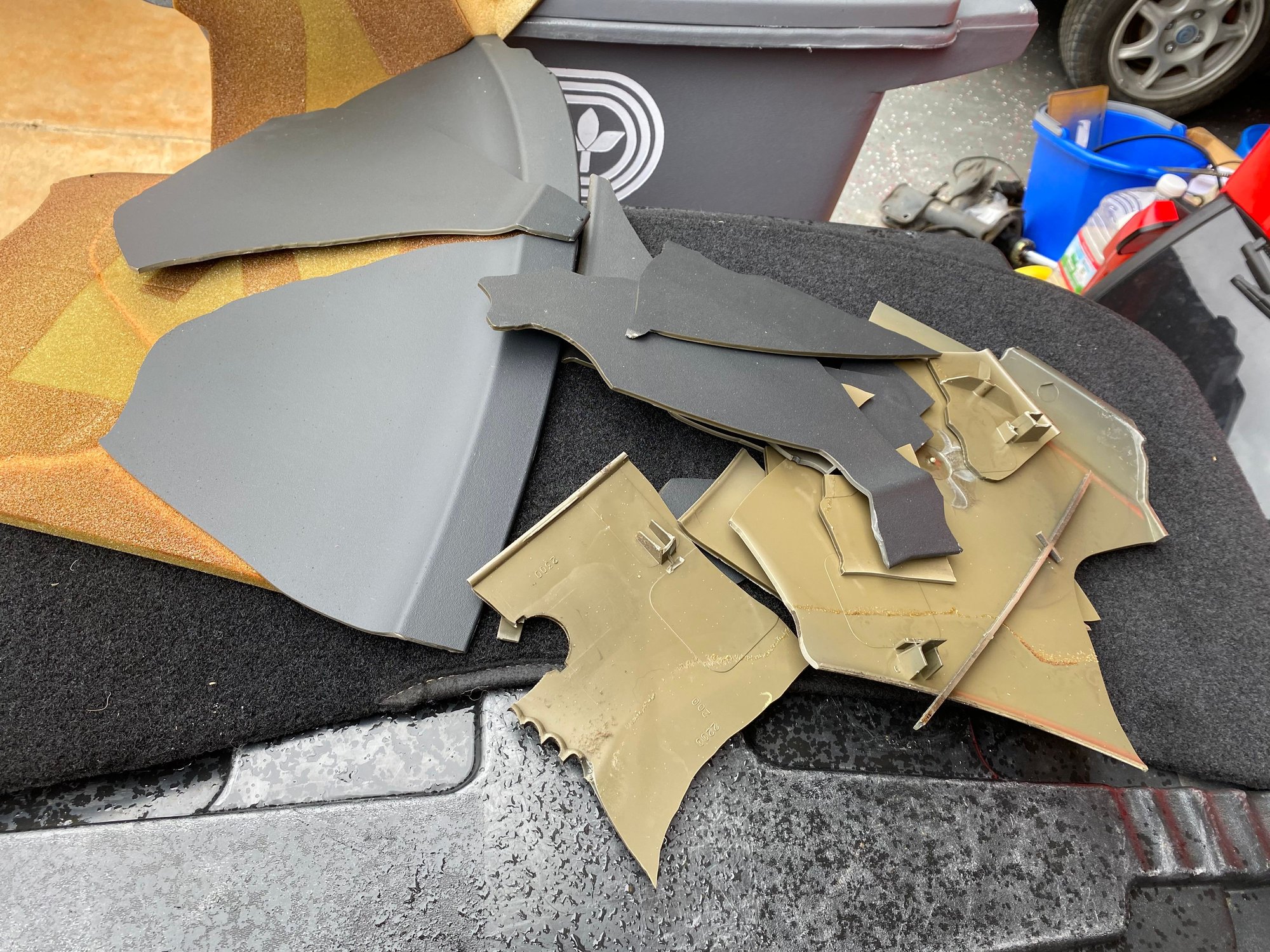

Today I fixed my very cracked dash. It was almost humorous removing the 51 pieces I counted. The TX sun and Bilstein suspension destroyed this dash. After reading about various repairs on this forum, I quickly realized a factory replacement was the easy button. Thank goodness there are still a few on eBay from GM dealers.
Enjoy the photos! New wheels and tires will be on it soon. I'm also going to service all fluids soon too. Then I will start driving it regularly and figure out what it needs.
Hidden under carpet cover.
Carpet hides much of the damage
Half the removed pieces.
Other half of the removed pieces
Looks better than the dash pad that came with the car or carpet.
Oh lookie there!
Wow that is so much better!

I've replaced mine. If you have an alarm LED, you need to be careful not to damage it's housing or the wires. The entire dash pad is held down with gm "ball" type latching pads ...I have no idea what the real name is for them....
My pad had started cracking and when taking the old one off, it shattered into several pieces once I popped loose the first ball pad. The sun had made it extremely brittle. The new one went on by just pressing it in place and listening for the ball pads to snap.

Honestly, it was super easy to replace. My car is a slick top, so removing my side pillar panels is a bit different than all the videos of the t-top cars online. Once you have the side pillars out, just pull up on the old panel. Mine was brittle and broke into many pieces. The new one is much more flexible (it was a new graphite colored one from GM), and it had all the velcro pads already installed in place and the clips. It is really a matter of making sure all of the old velcro pads are removed (a few of mine stuck in place and didn't come out with the old pad), and pushing in the clips. I did have an LED, but instead of cutting a new hole, I just left the LED below the new dash pad. It's not even really a pad but is in fact just a huge plastic panel with foam padding, velcro and the clips underneath. The new GM part comes with all the padding and everything installed underneath. It is a very simple remove and replace. If you can change engine oil, you will find this task even easier.

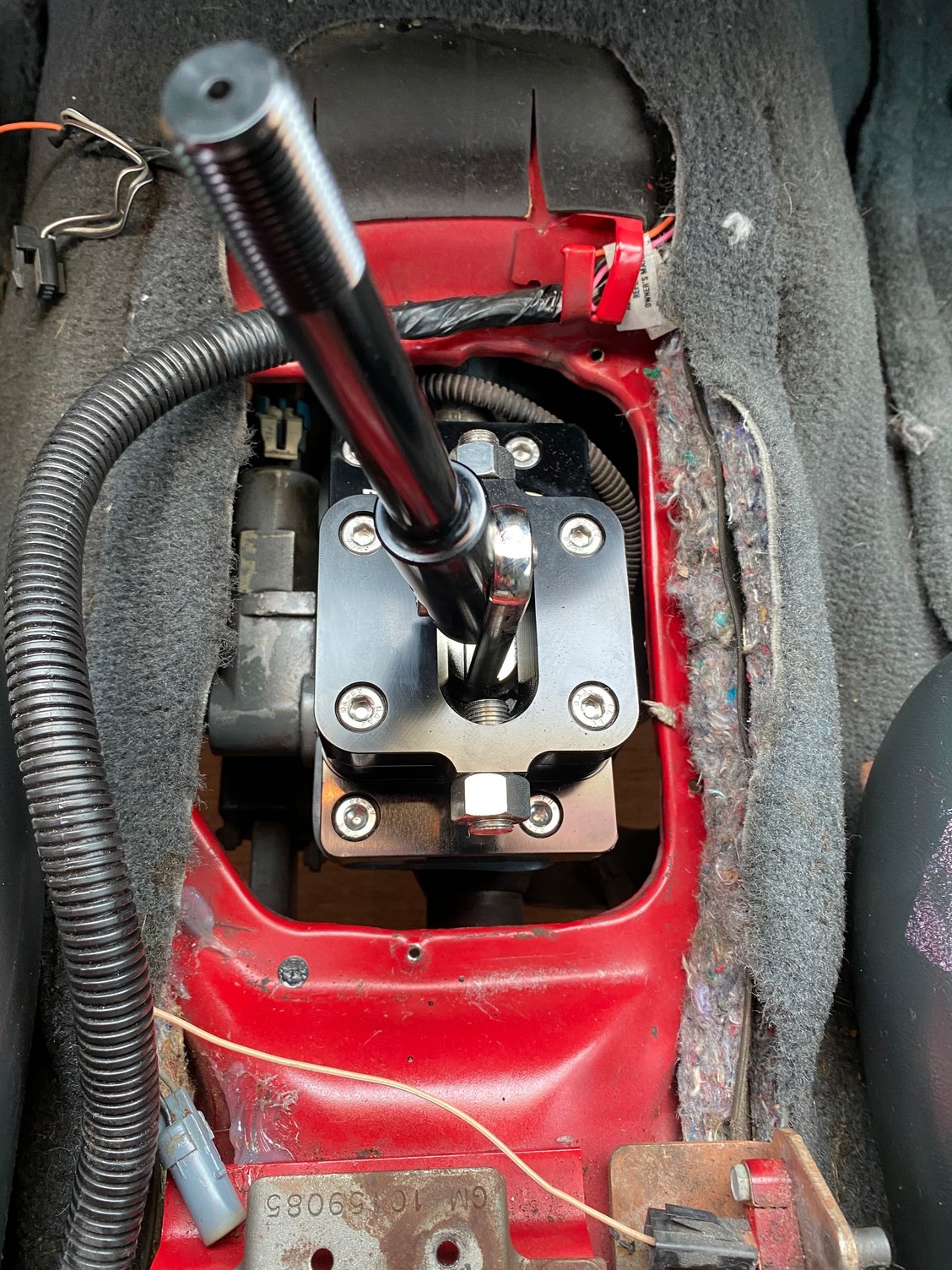

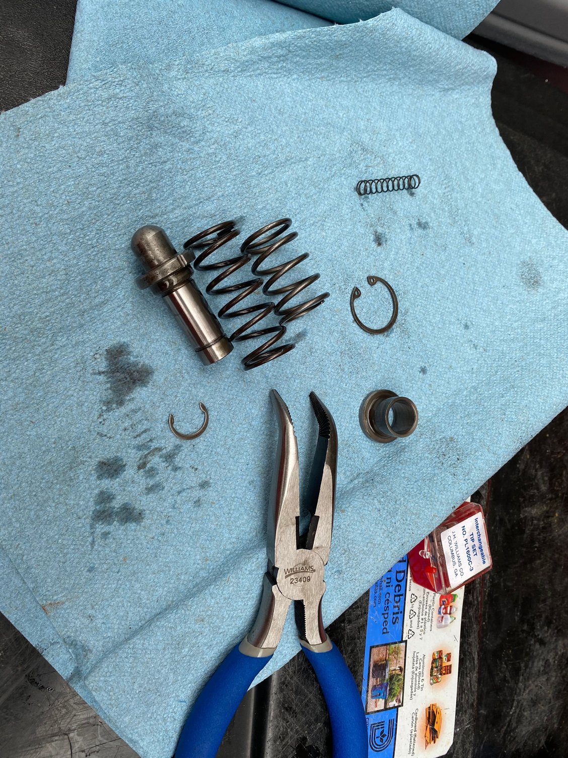

Well I figured out why my car is so dang hard to get into reverse. The reverse lockout solenoid is unplugged. I can't seem to find the plug either. If some can take photos under their car of the wiring routing and colors for the T56, I'd be very appreciative. I did drain the trans fluid and replace it with synchromesh. I'm also replacing the tired shifter. The new shifter from Hawks feels much better shifting from gear to gear. Someone has had the console and shifter boot out though at some point because there are some missing screws holding down the rubber boot and the console bolt holes have cracks, etc. I'm a total sucker for fixing things right so it won't go back until I locate two more similar if not the exact same screws for the shift boot and probably reinforce the cracked plastic with fiberglass and epoxy. I also need a new console storage latch and hinge, but I think all 4th gen F cars can say that. That will get fixed too. I know nothing will ever be factory new, but I don't like things done sorta halfway either. I'm going to drop the engine oil and service it too.

IIRC the reverse lockout solenoid and the skip shift eliminator plugs are exactly the same and can be plugged into either solenoid. If there is a plug which is on the skip shift solenoid, try plugging that in the reverse lockout and see what happens.

Well I have the car up and have spent some time under the car. I have swapped the shifter and 1-6 feels much smoother now. I also changed from ATF to Synchromesh which may help too. I did the bronze shifter bushing and the original was a bit worn out so that was some of the issue. I found the reverse lockout plug attached to the skip shift solenoid and a resistor inside the skip shift plug. I hate CAGS, so I put the resistor back and tapped it all back up with fresh electrical tape. I have been changing all fluids too. Someone cross threaded the oil drain plug (oh boy). It went back in right and tightened up okay but I will need to keep any eye on it. I probably need a new oil pan and plug. I need the right size oil filter socket so I'm about to go get that. I do have lowering springs (I think) and I do have a heavy duty front sway bar, bushings and new end links. The car is super clean underneath with no corrosion (except minor on exhaust) and very little dirt. This car was likely garaged much of it's life and will be in the future.

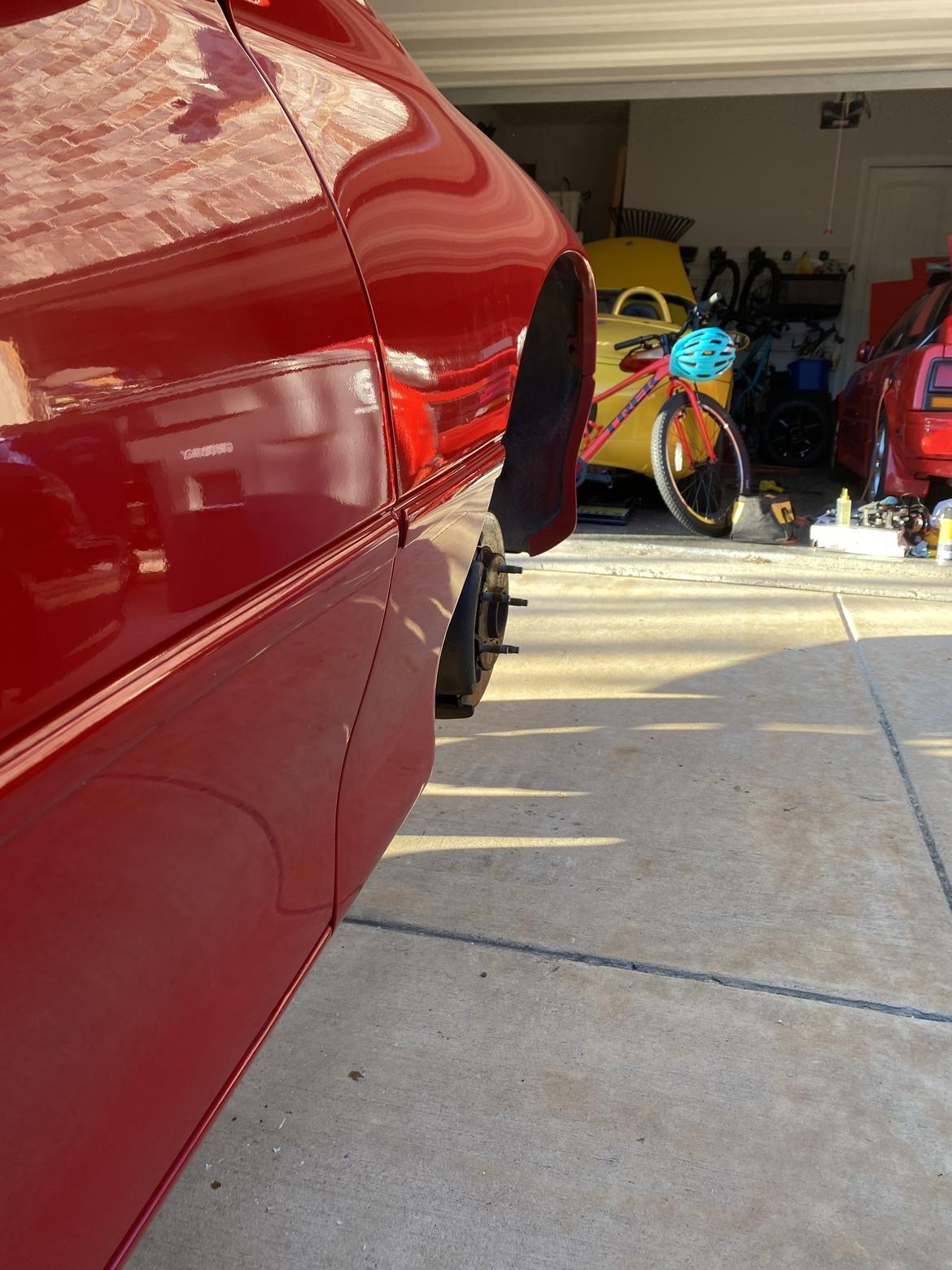

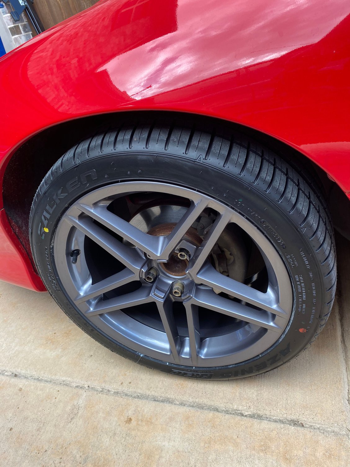

So I’m very unhappy about the wheel situation with this car right now. I’m contemplating grinding wheels or swapping axles and doing bearings too since the car has 183k.
https://ls1tech.com/forums/lt1-lt4-m...l#post20355196
Vette front on 96 SS front

I see three ways out.
1). Grind inside of the wheels. Probably okay but not ideal.
2). Get new axles or have an axle hub lathed to correct 70.3 mm diameter. I’m finding replacement axles but none list the hub diameter.
3). Run longer studs and a 5mm spacer or so which will probably work too.
I just serviced the trans fluid and oil. I did get a new rear cover gasket and was ready to service the rear. If I do axles and bearings, now would be the time.

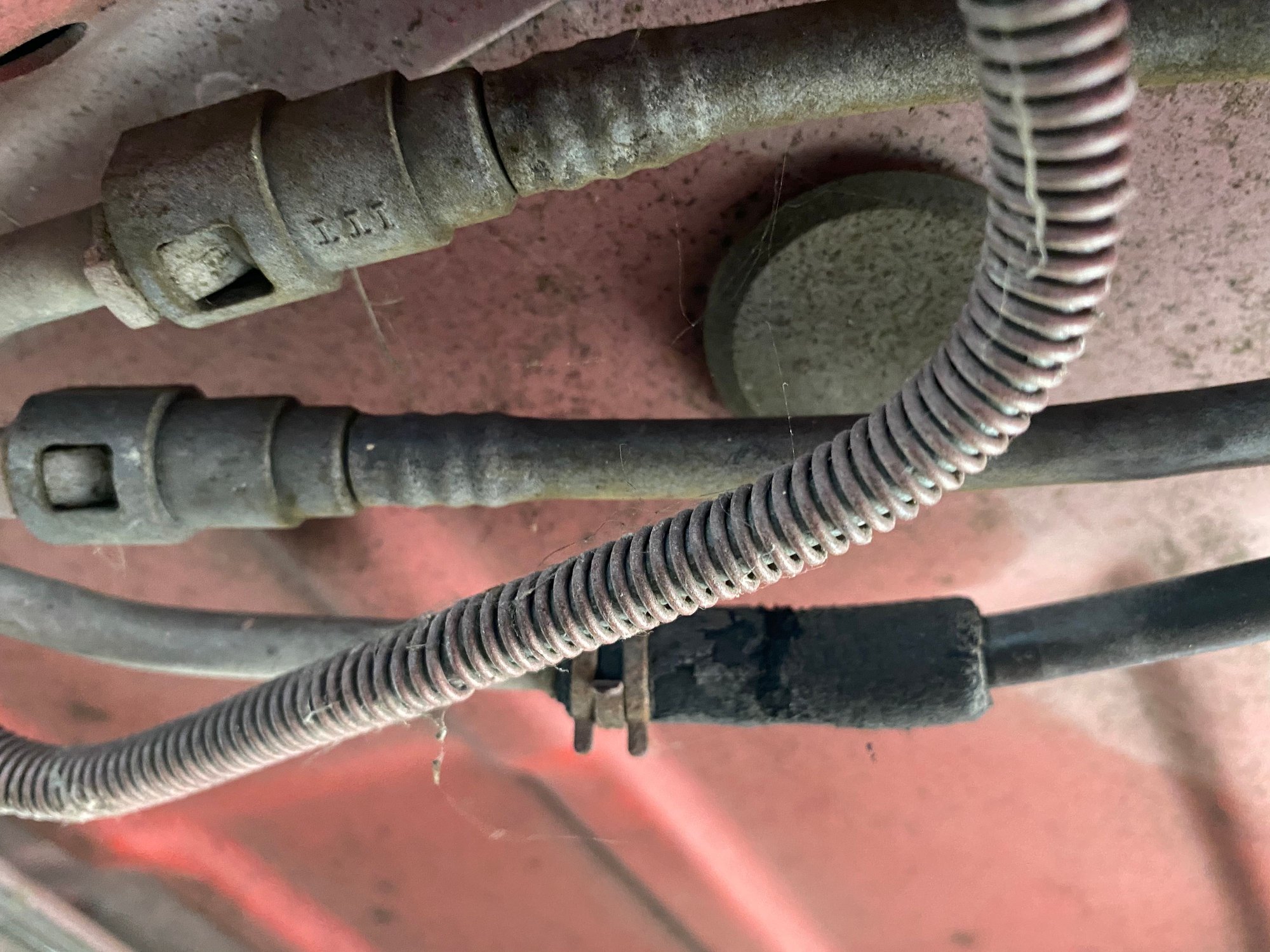

Well messed with the car some more yesterday. I put a lighter spring in the reverse lockout solenoid. And while under the car I found the cause of the CEL. I have a vapor canister CEL and the vapor line next to the two fuel lines has dry rotted right where it connects to the hard pipe going back to the tank. I'll cut some fuel hose of the right diameter and clamp it with the smooth crimp clamps. I have a lot of them from working on VWs and Audis and they are superior to hose clamps and don't cut the hose. I'm curious how long these fuel lines will hold up. On Fords and Porsches the hard plastic lines have a history of failing and leading to engine fires (SN 95 GTs and Porsche 944s). I don't want to lose a car to something preventable. My car has aftermarket sway bars front and rear with poly bushings and grease fittings. They looks similar to what Strano sells. It may have lowering springs too (I'd love to know how to ID Strano springs). Wheel spacers and longer studs arrive today. Honestly the factory studs are a bit short for these wheels so I may get new front studs for piece of mind too. If the wheel bearings are worn, it'll get new hubs too. Center caps and decals for the wheels should arrive soon too. I also need to do some repairs on the console so the plastic doesn't break any more. Then I need to fix the ubiquitous broken console door and latch. This car may yet see an autocross and maybe a track day this year. When I got it, I figured it might take way more than a few months to get it ready for events.
New and old rev lockout solenoid springs
Hawks shifter and solenoid back in place
Gnarly vapor line causing CEL

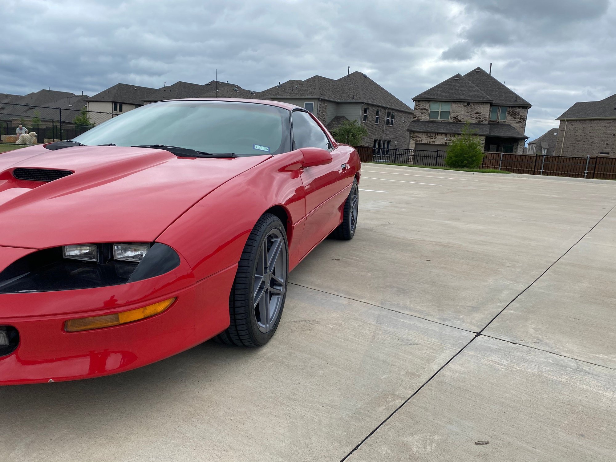

Wheels are on and look good. The added 10mm offset looks almost perfect.

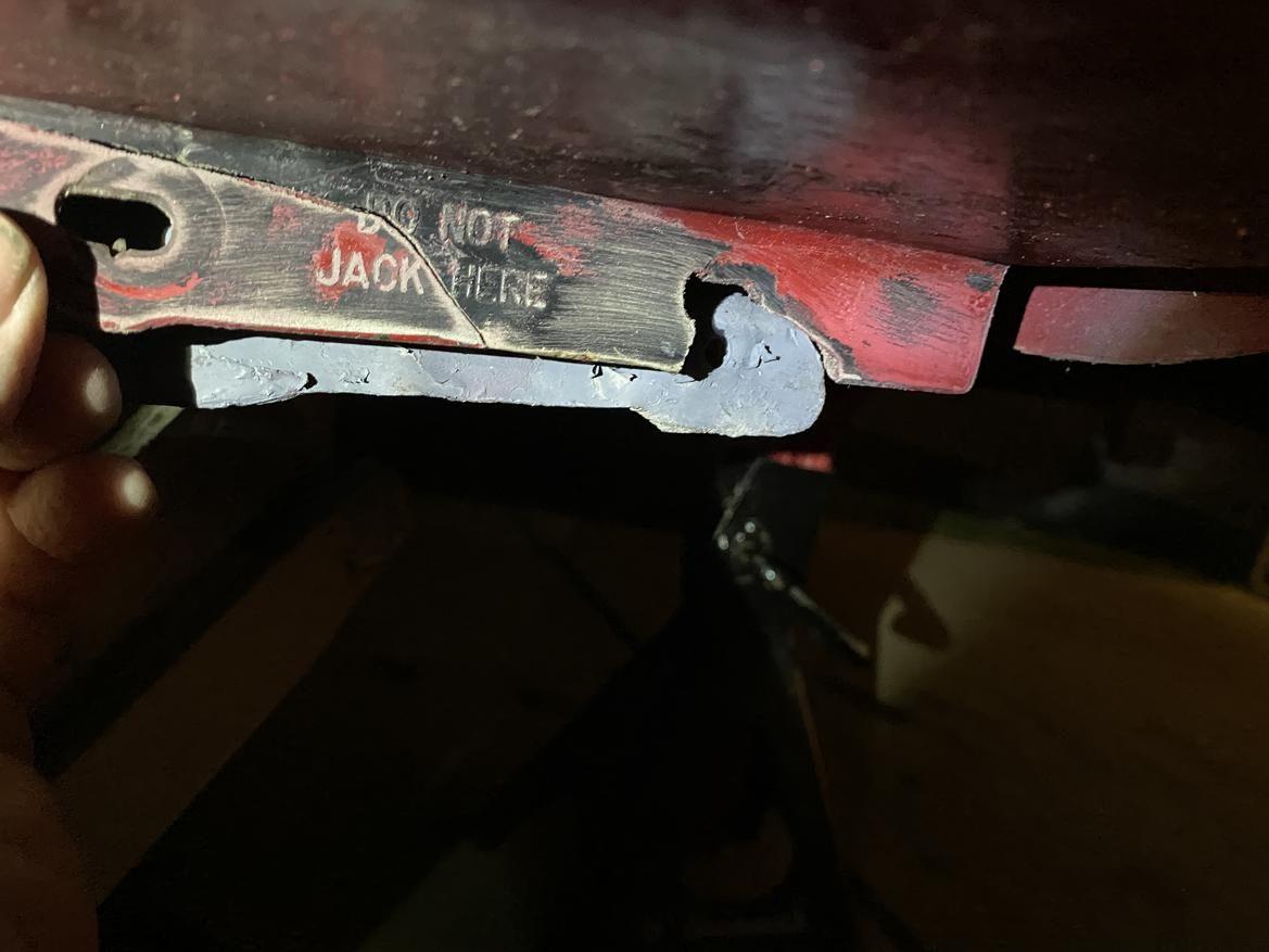

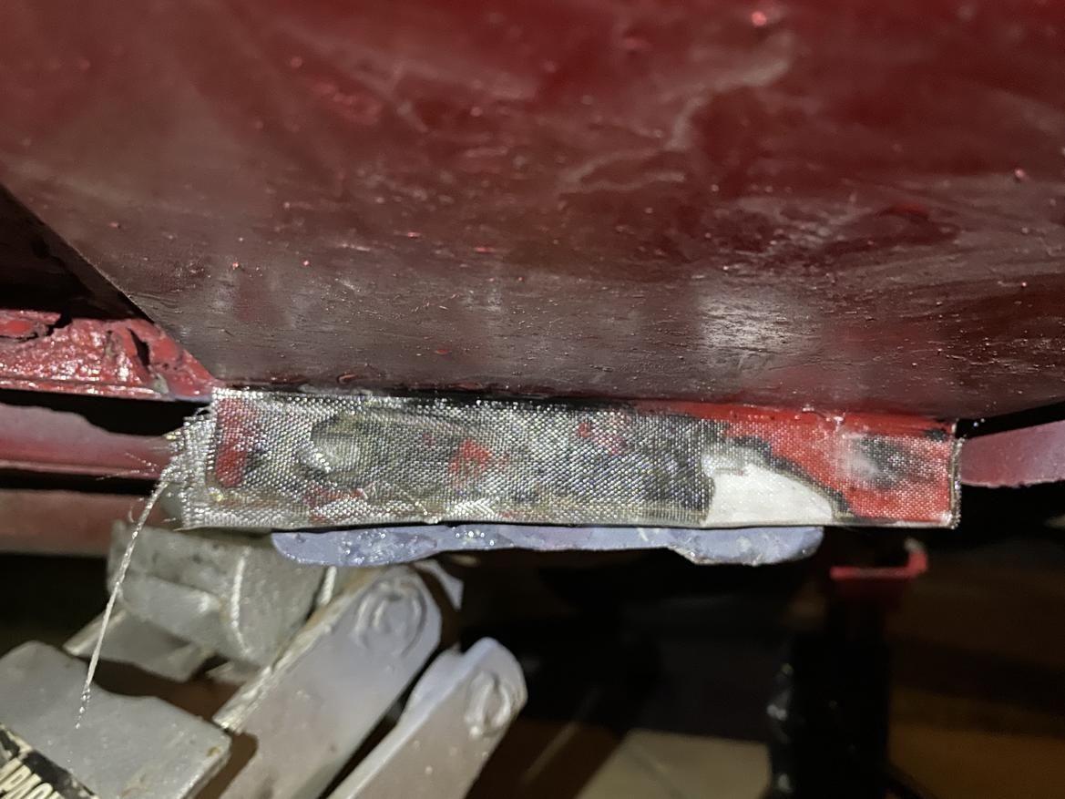

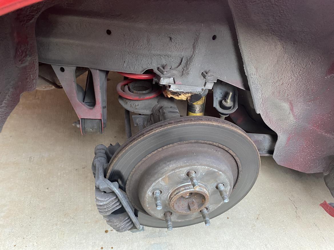

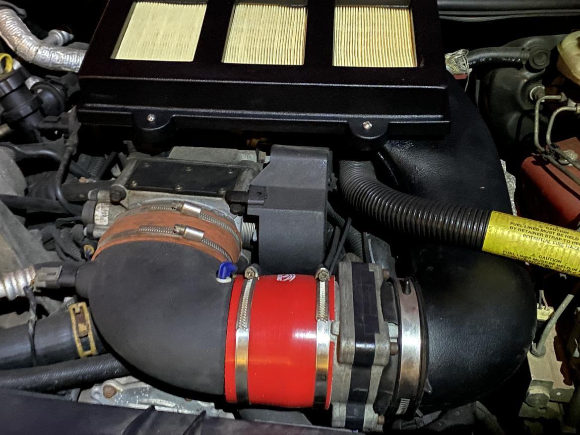

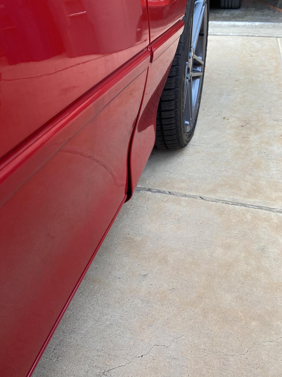

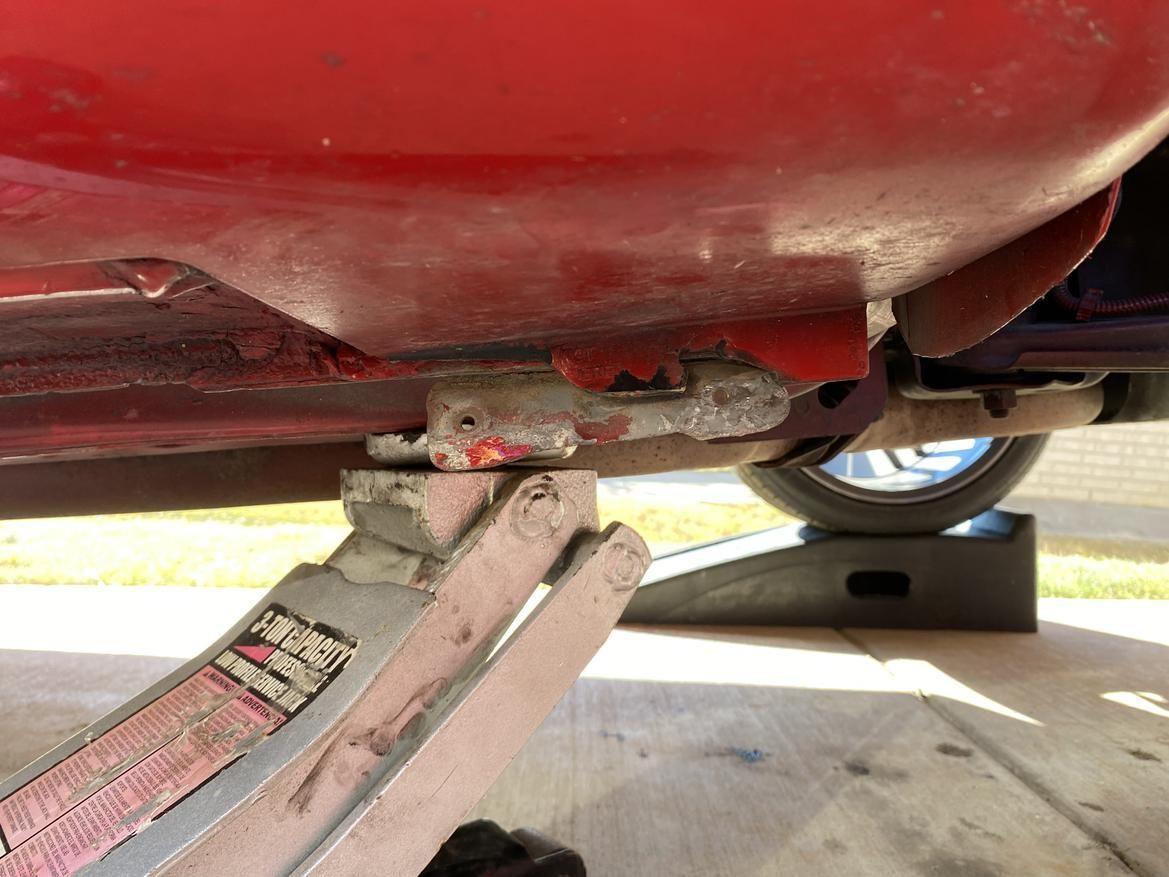

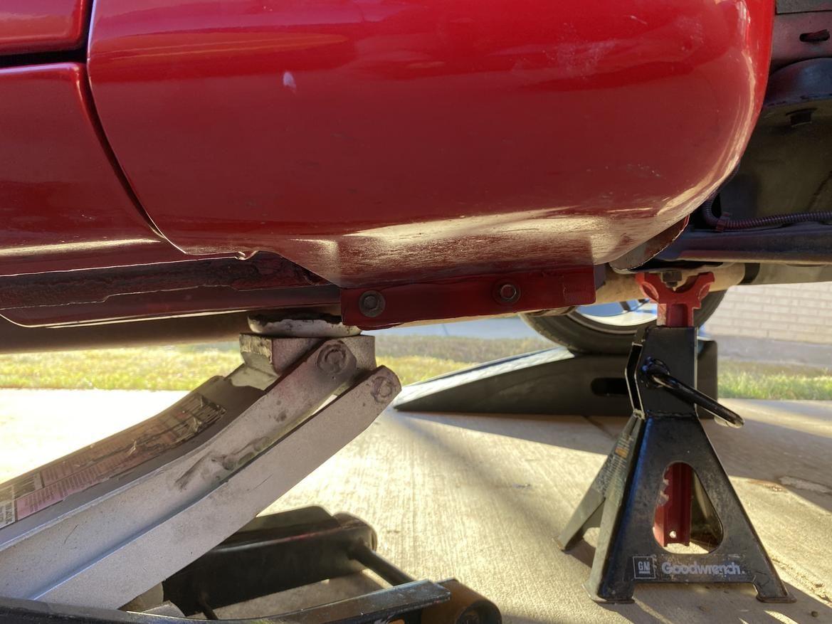

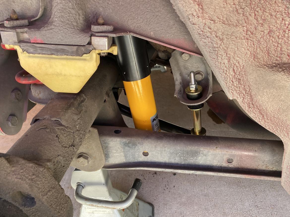

I am still enjoying this car far beyond what I paid for it. I haven't posted an update here in a long time, but a lot of little things are happening. I redid the rear suspension with new Koni's new bump stops and a Strano rear bar and removed the BMR rear bar. I also freshened up the rear brakes. I fixed my front fender pooch due to the bent mounting tab. I also found out the Detroit speed brackets will not fit our 93-97 cars due to the way the floor pans are shaped and the fuel lines run in the channel (really disappointed). I also had to install new battery cables since the old ones had very excessive voltage drop to the positive terminal that feeds the wiring harness. I'm going to put repro emblems (GM licensed) on it soon and do the front suspension. I also upgraded to an LS1 steering rack and steering shaft and it transformed the steering! If you go back to my first posts this was one of my big complaints about the car. With each upgrade / repair this car keeps getting better. I am moving this summer. I am looking for some LT1 aluminum OEM heads to send to Lloyd E too and planning on a mild engine rebuild / upgrade after the move. I may also do a 24X upgrade too. I also need to find a good factory head unit or have mine repaired. And of course the passenger power window is not functioning and I need to try and repair the headliner. Here are some photos of various things completed. I also installed an RK sport airbox since my factory airbox was all messed up. The clamps were busted and so were the mounting holes. The RK sport airbox took some work with holes needing drilled and heat gun persuasion to fit over the MAF but it's installed. When this thing is idling you can just hear all that airflow which is kinda cool.
fender bad
tab all jacked up
broken piece
fiberglass repair in progress
repair complete!
new rear susp
old junky rear suspension; check out those bump stops!
RK sport airbox
fixed!
