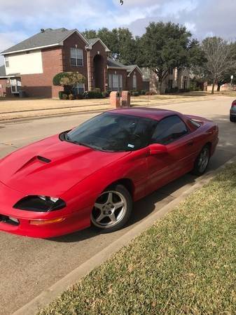

I was looking for a 4th gen F body to play on local CAM-T autocross. I was hoping to get an LS1 SS or WS6 car for about $10k ready to rock.
Today a 96 SS popped up on CL 5 miles from me. I went and looked it over, talked to the owner and took it for a short drive. The ad said $7k. The car was clean in and out. It’s a red slick top with color matching top. I knew if it was a legit SS it was pretty rare. The owner divulges it may have head gasket issues or other cooling issues. The passenger power window reg is toast. The shifter needs new centering springs or adjustment. The dash is hella cracked. She has high miles. She looks great though. She ran smooth on the test drive but the gauge would read hot then normal. I’m wondering if there is a leak and air in the system or a bad water pump too.
I checked the VIN on the SVE website. She is #775 which matches the plate inside, red slick top, M6, TOTL, Torsen, and Bilstein suspension. The car cover is gone and the mats are worn out. The spare set of wheels and R1s are long sold.
She also needs a lot of steering gear love, tons of play.
So I start telling the owner no way can I do $7k with these issues. He says straight up she may need head gaskets, so $3500. I said deal. I’m going to tie her to a friends place Monday. I need to sell another car to bring her home.
I’m going to be running a 96 SS in CAM-T soon.
Photo from the CL ad. More to follow.

Looks clean, You don't see man LS SS's around let alone a LT. Good luck w/ it!

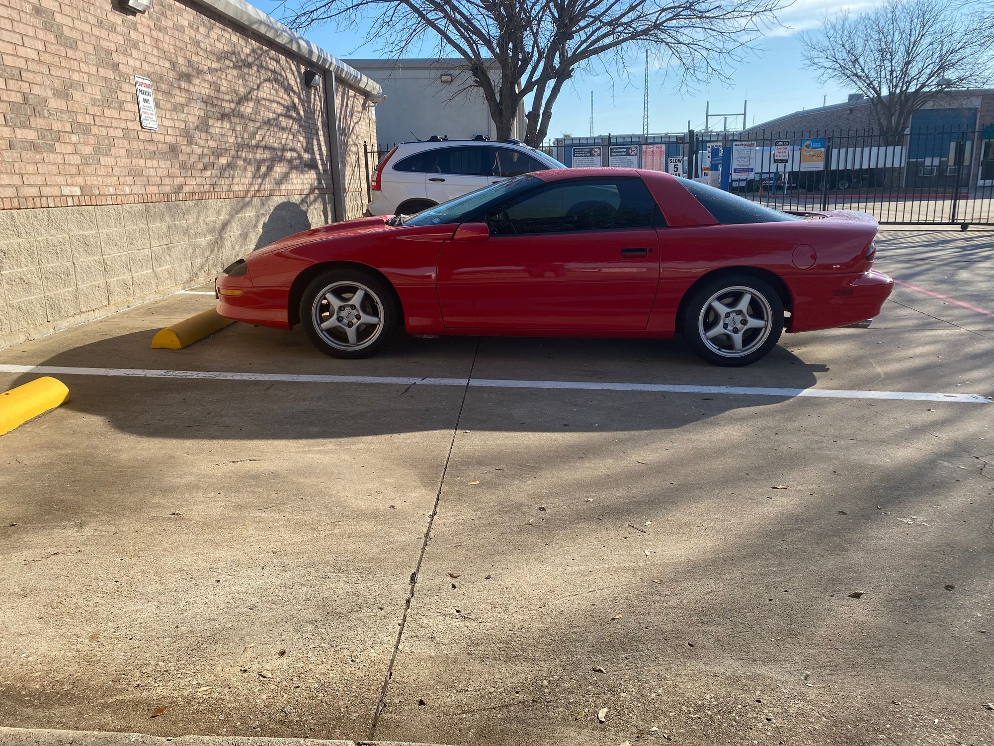

A few more pics from today. I’m keeping it at a storage place 3 mi from my house until I sell another car.
96 SS all emblems shaved.... going to need replacements.

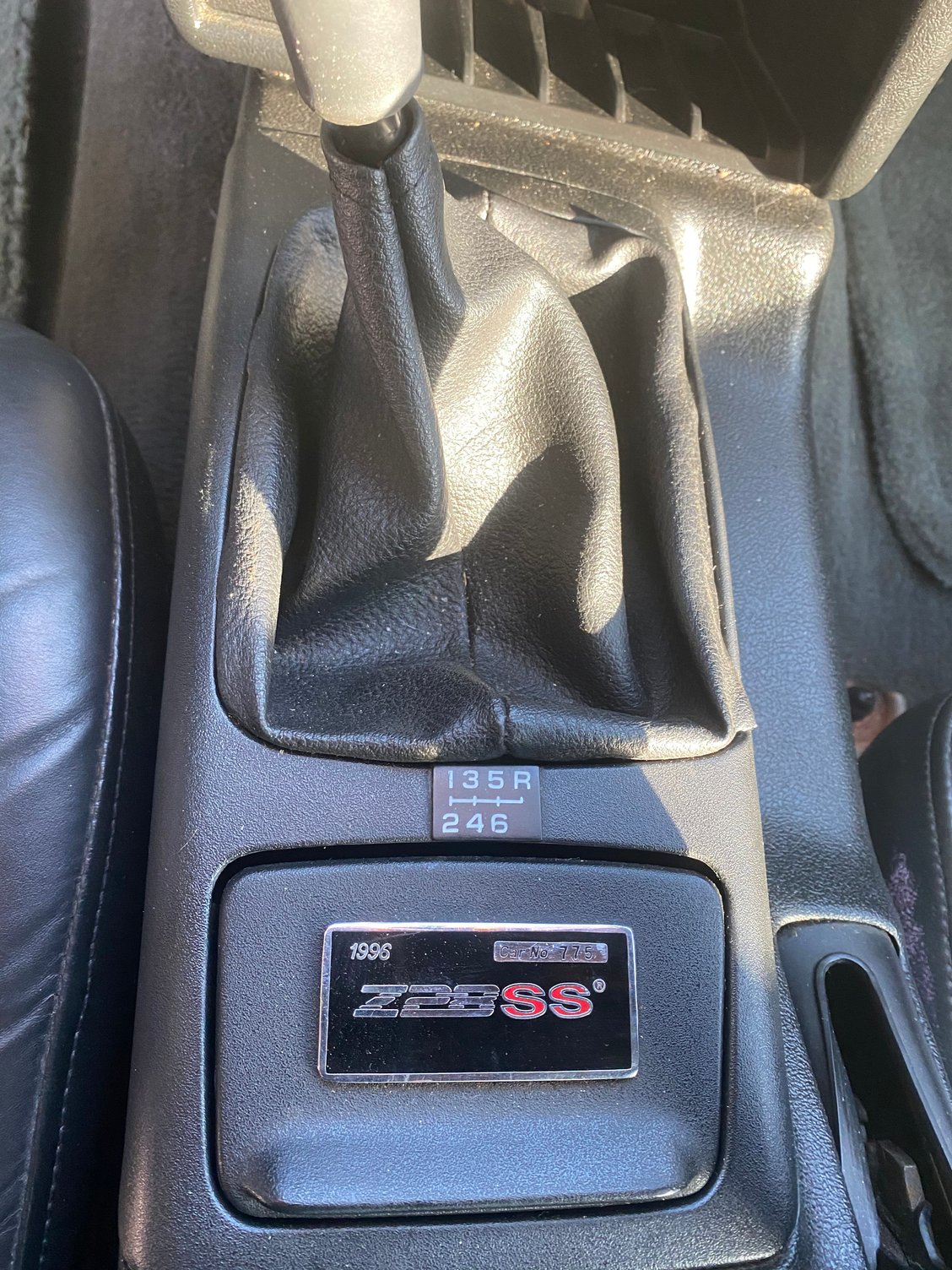

A real 96 SS which matches the info on the SVE information site. This car had every option you could get from SLP, except the oil cooler which didn’t come out until 2 months after this car was built. I need to find a car cover and new floor mats. I wouldn’t mind a 2nd set of wheels for race tires again either.

Are the wheels original? Just curious about the center caps as they look to have Corvette style center caps. Of course those can easily be changed out.
Like you I would get some SS emblems on that bad boy.

They are the original SS center caps.

Looks like the air dam is in place. Your cooling issue could be as easy as air bubbles in the system. These engines are easy as **** to introduce air bubbles, but just as easy to bleed. If you want to spend some money on the brakes there are C5 caliper adapters available.
