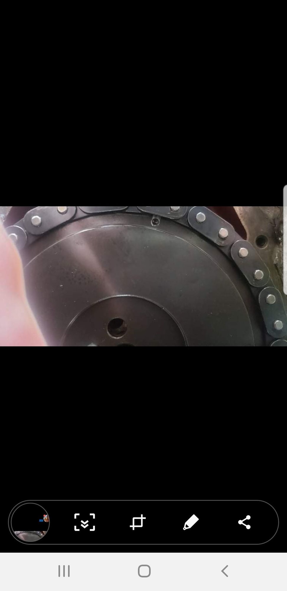

Old Jul 27, 2021 | 12:28 PM
Lsp Przy's Avatar
Joined: Jan 2018
Posts: 71
Default I paid someone to do it for me lol this is my prize
Old Jul 27, 2021 | 12:38 PM
Shownomercy's Avatar
Man-Crush Warning
Joined: Jun 2009
Posts: 3,197
Likes: 130
That picture needs the crank gear dot to be of any value.
