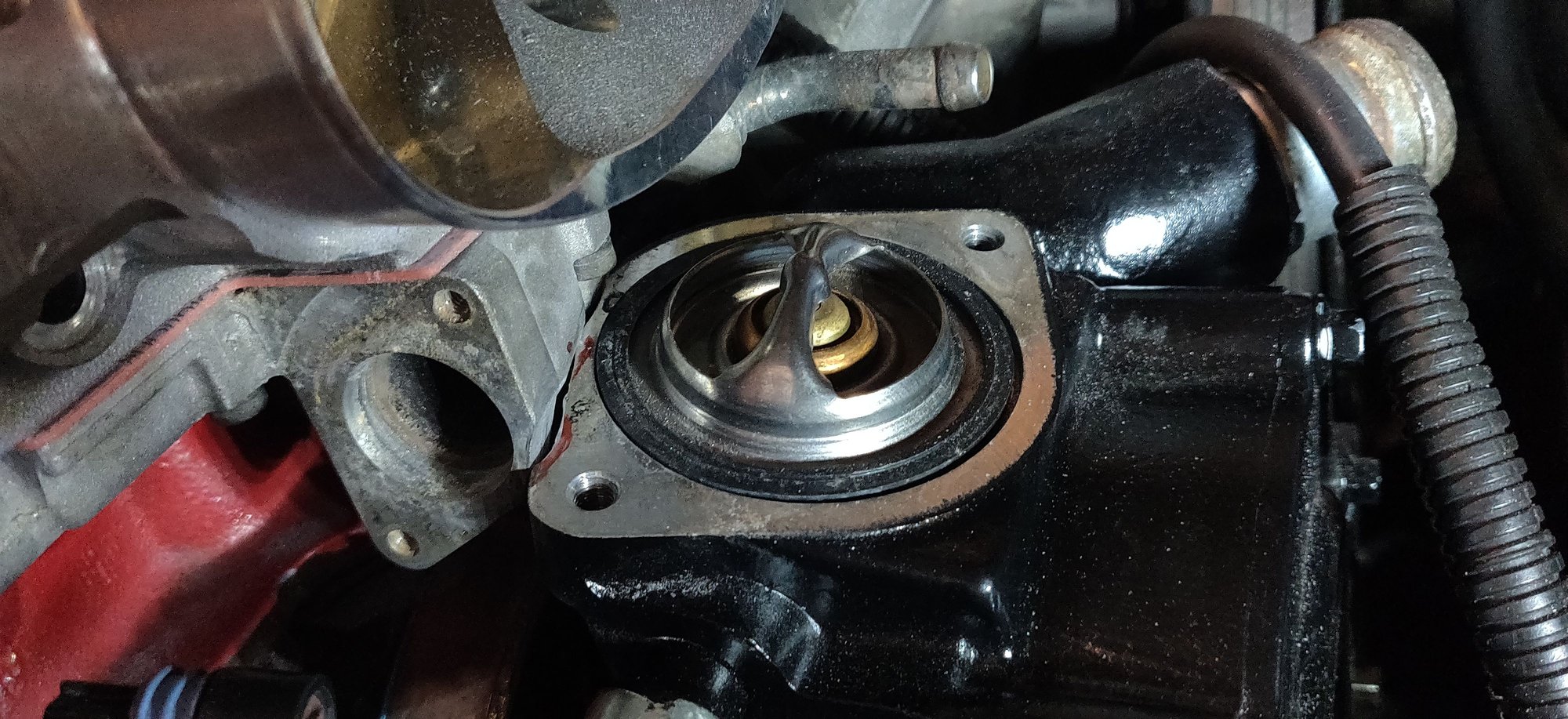

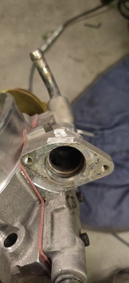

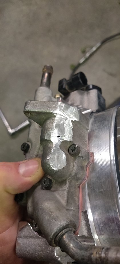

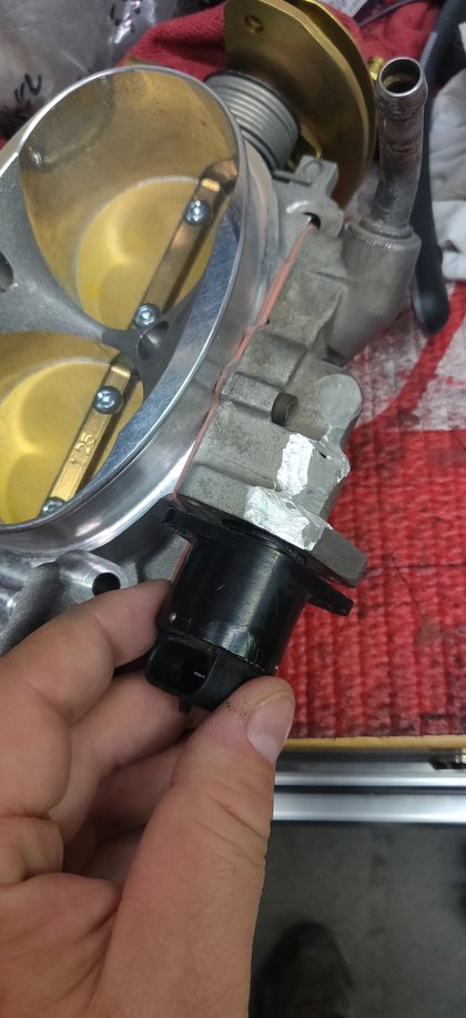

My nitrous throttle plate won't fit I trimmed the thermostat housing water pump and the housing for the sensor and still can't get it on is there some kind of bypass I can do for this? I already cut thru the housing for it. There has to be a fix.
Oops trimmed thru housing
Water pump and housing hitting after trimming

The sensor

No you kinda need that, its the IAC.

What plate and throttle body?

Bbk 58mm and nitrous outlet plate

It’s a pain In the ***. If you have aftermarket heads or decked heads/block it’s very tight. Mine was borderline not gona fit but it just barely does. Took me hrs of filing and test fitting.

AFR heads that are decked....... Great
