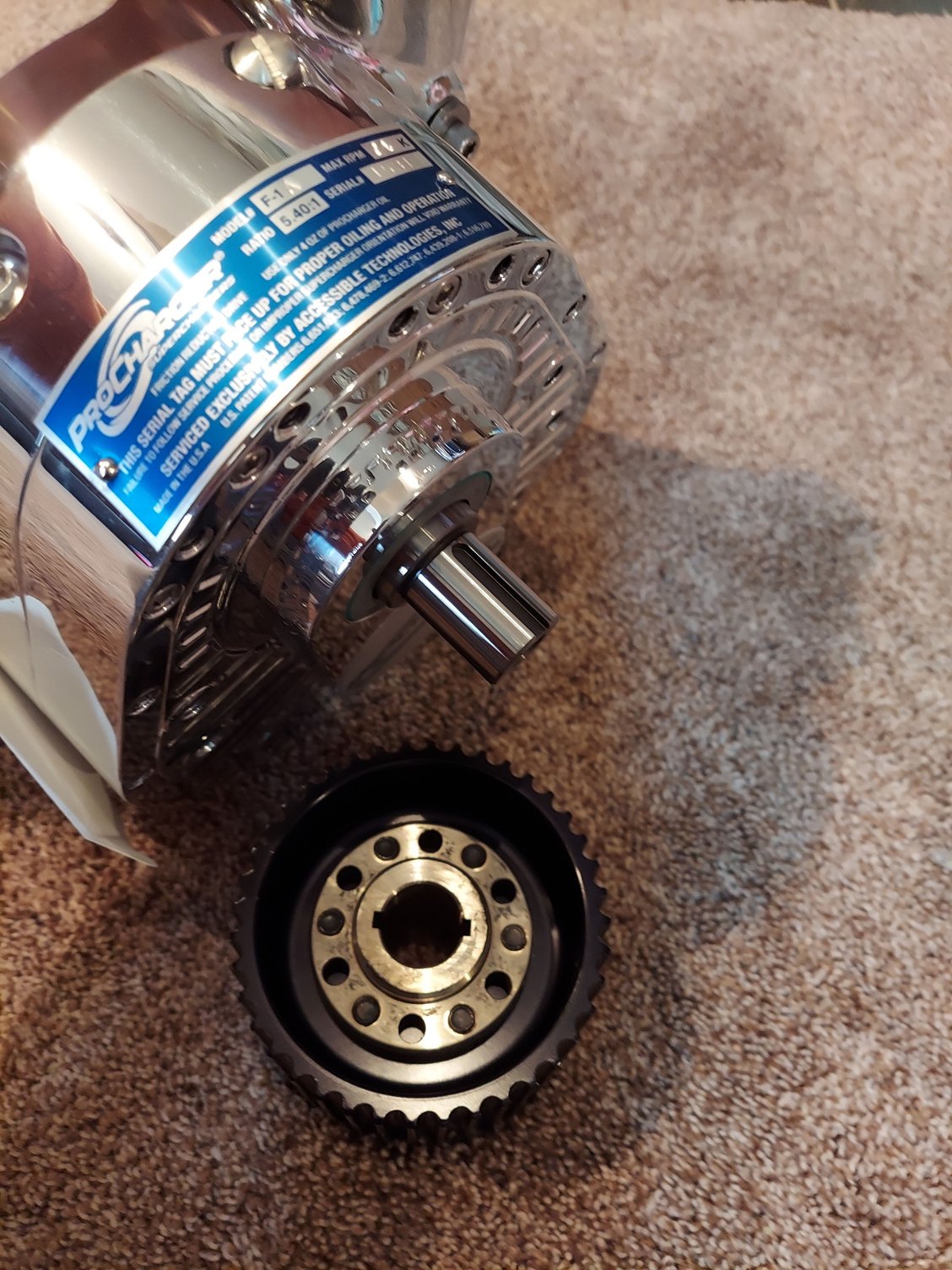

I have a F1A on my setup. Bob is very knowledgeable and who I went through for my setup. F1A runs very well. I have had it for a while now and may send it in for an upgrade to the F1A94. I don’t have any numbers to share but setup is 383, AFR 227 Heads with additional work, TH400, 237/251 .632/.614 114 cam, Holley Dominator, MagnaFuel 4303, Sump Tank, etc.
Probably be changing to a cog setup here soon and solid roller. Still considering the upgrading bracket from SDCE Concepts as well.
F1A makes plenty of power and really is a good unit. Very happy with it.

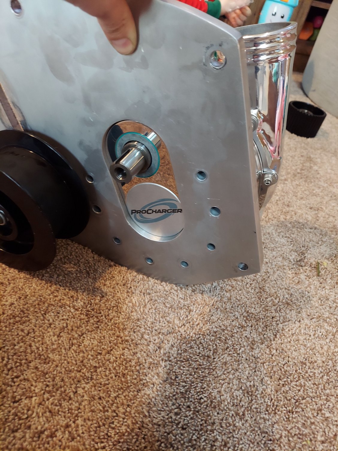

I run a House of Boost Cog setup with a proprietary bracing system a friend and I designed to eliminate flex. As thick as their bracketry is I still managed to flex it on my F1 setup. Flexed it so bad I flipped the cog belt upside down and shredded away half the thickness of the belt. LOL I also double pinned the crank pulley to the ATI damper instead of using the 3 bolts that would normally bolt into the hub of the crank. Takes the stress off the bolts. I also drilled holes into the grooves of the blower pulley and crank pulley of the Cog as Erik from HOB say the belt traps air in between the pullies and belt. Haven't had an issue since. 80/40 is what I went with, I want to step up to an F1x but the old F1 does just fine.

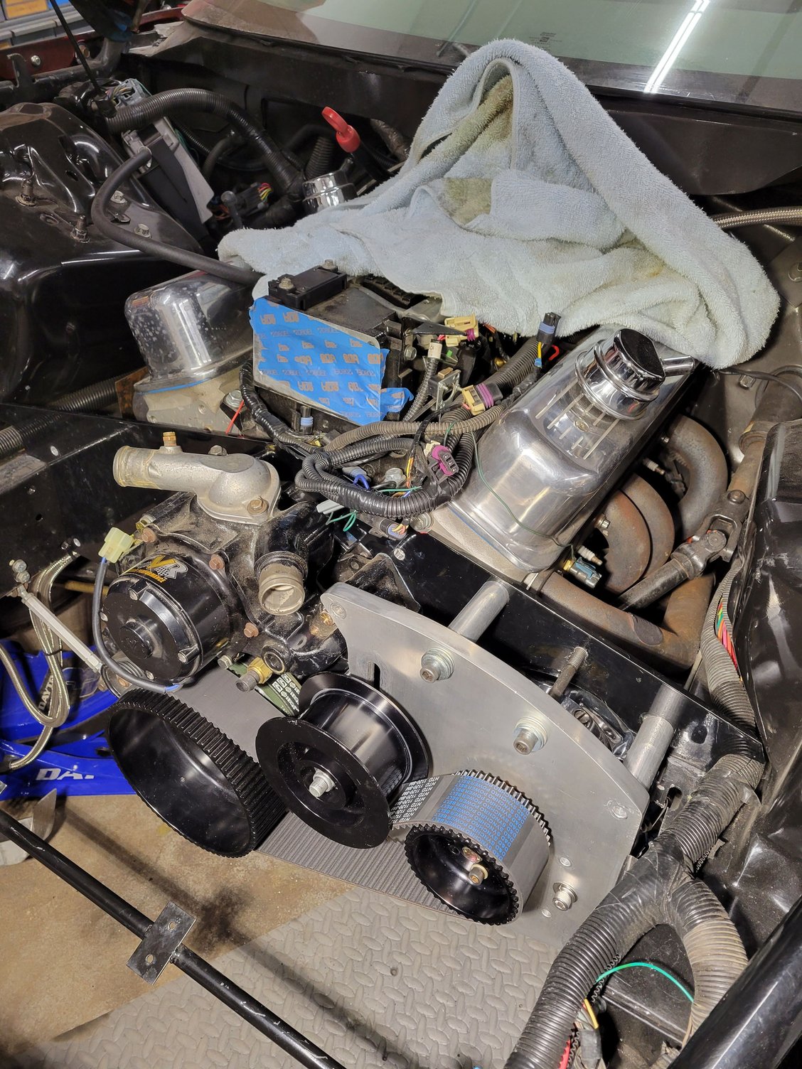

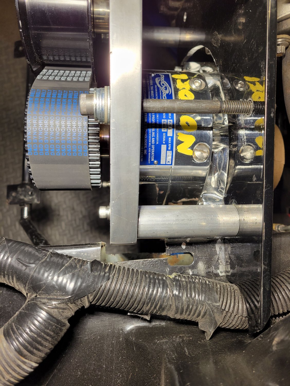

Old Feb 26, 2022 | 07:30 AM
nickp's Avatar
Joined: Mar 2007
Posts: 412
Likes: 21
From: Southern Michigan
Fits like a square peg in a round hole lol. But its starting to come together.
Old Mar 3, 2022 | 05:53 PM
SRZ's Avatar
SRZ
Joined: Nov 2002
Posts: 1,170
Likes: 12
From: FL
What's with 2nd plate attached to the head? Did you build that? Never seen that done before, interesting. Is the plate somehow attached to the frame well too?
Old Mar 3, 2022 | 06:24 PM
Shownomercy's Avatar
Man-Crush Warning
Joined: Jun 2009
Posts: 3,197
Likes: 130
Looks like a motor plate

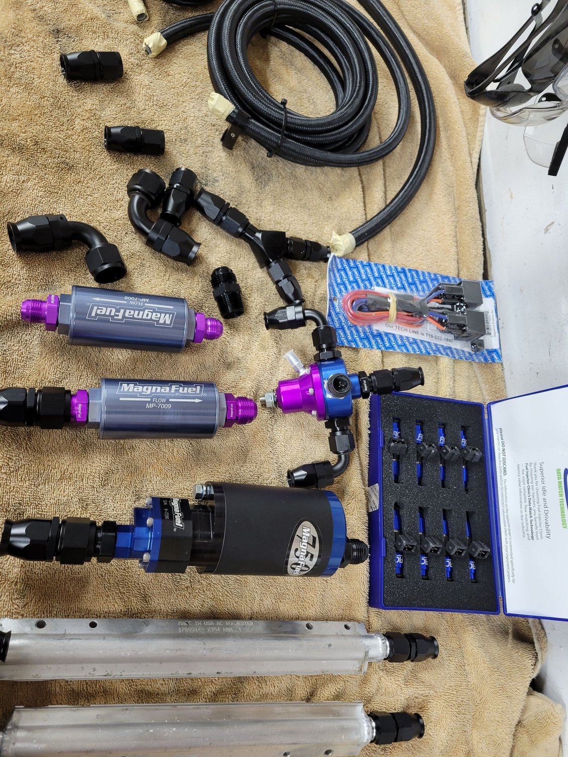

$2500 and 6 months later...
Ended up going Magna Fuel 4303, and FIC 1200's.
-12 from sumped factory tank to the pump then -10 feed and -8 return and a dual relay.
Old Oct 29, 2022 | 11:19 AM
Man-Crush Warning
Joined: Jun 2009
Posts: 3,197
Likes: 130
I have the same pump, be sure to mount it on isolators
