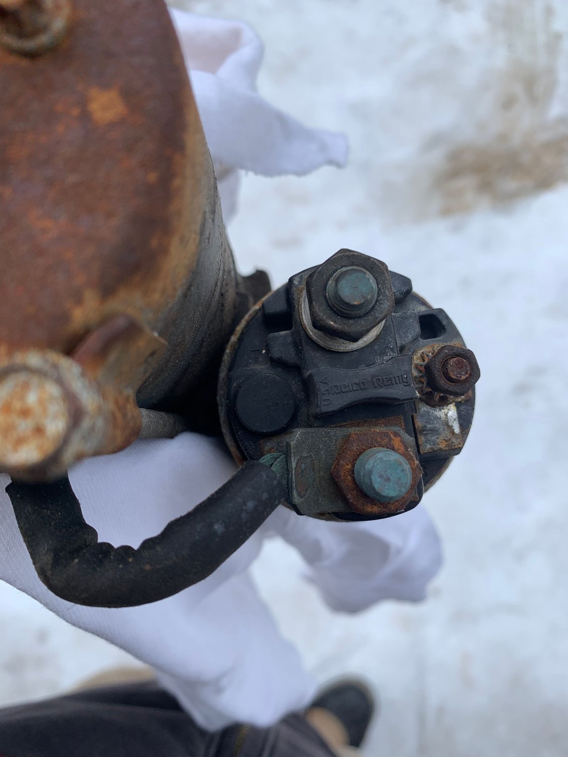

Old Jan 14, 2022 | 01:14 PM
chalou88's Avatar
Joined: Feb 2018
Posts: 163
Originally Posted by SS RRR
I also have a starter I can take a pic of that you can use for reference.
Here she is. Will prob get a new one before it is put back on the road.
Old Jan 14, 2022 | 02:20 PM
SS RRR's Avatar
Village Troll
Joined: Oct 2002
Posts: 11,111
Likes: 598
From: Jackstandican
There it is. So yeah, battery power on big post and bump start trigger on small one.
Old Jan 14, 2022 | 02:25 PM
chalou88's Avatar
Joined: Feb 2018
Posts: 163
ok i was just going to unplug the coil to dist. To prevent frying anything. Should i unplug anything else?
