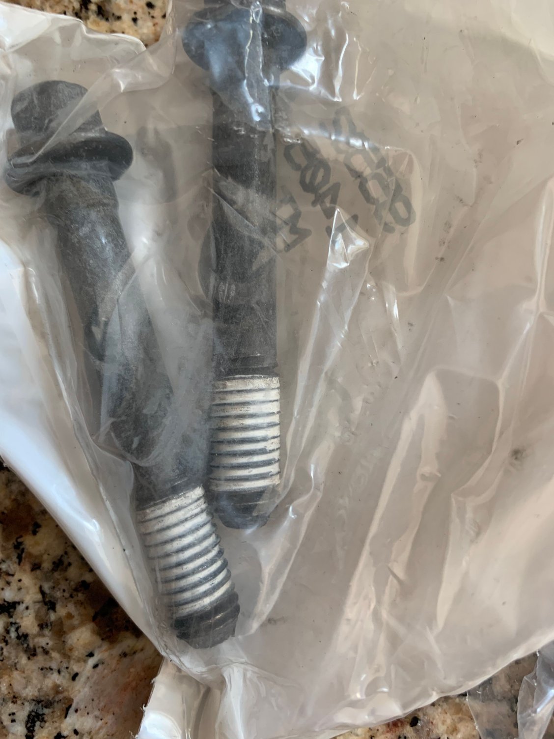

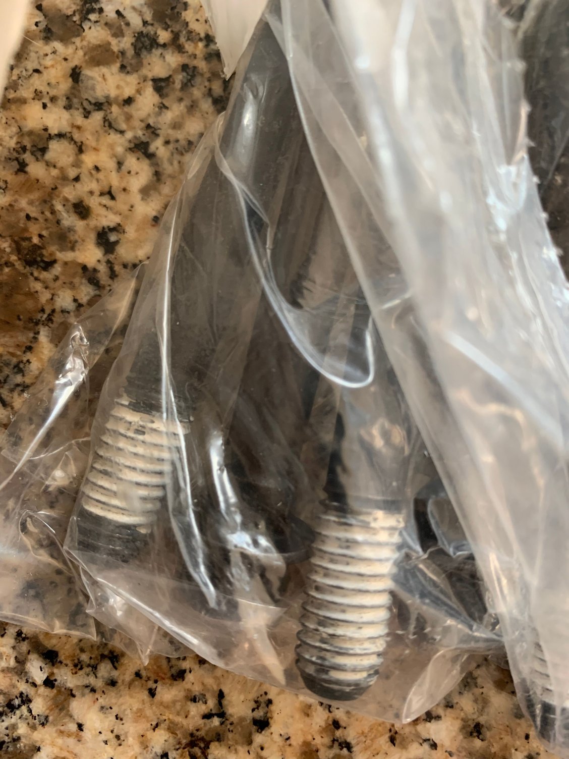

Guys dont the replacement head bolts have some type of sealer on them already? Believe it's white

OE style bolts have been working well for years for many rebuilds. No reason why they wouldn't work, either. Most of us that get deep into the mods just go for ARP bolts and worry with what to put on them, lol. Those bolts i believe are 3-stage torque to value, as opposed to the torque to yield (tighten to x lb. ft and add x * torque angle). I'm not sure if what the paper says is they can be used as TTY or not, but I'd torque as if they were pre-TTY era and go 30-50-70 o whatever final torque value the pre-1996 model year service manual calls for.
As for stainless on aluminum, thread sealer would definitely stave off any galling, though I've never personally had an issue with it.
