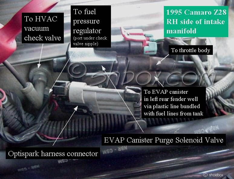

And yes, the opti connector near the fuel rail/on the intake. Unplug it and probe towards the PCM. What I'm asking you to do is to probe the BLACK (not GREY) side of this connector:
If you're getting 12v/5v/5v/ground on the black side of the connector but not at the grey side of the connector, then the connector is your problem. I've had to replace that connector a few times but only had to replace an optispark once.
