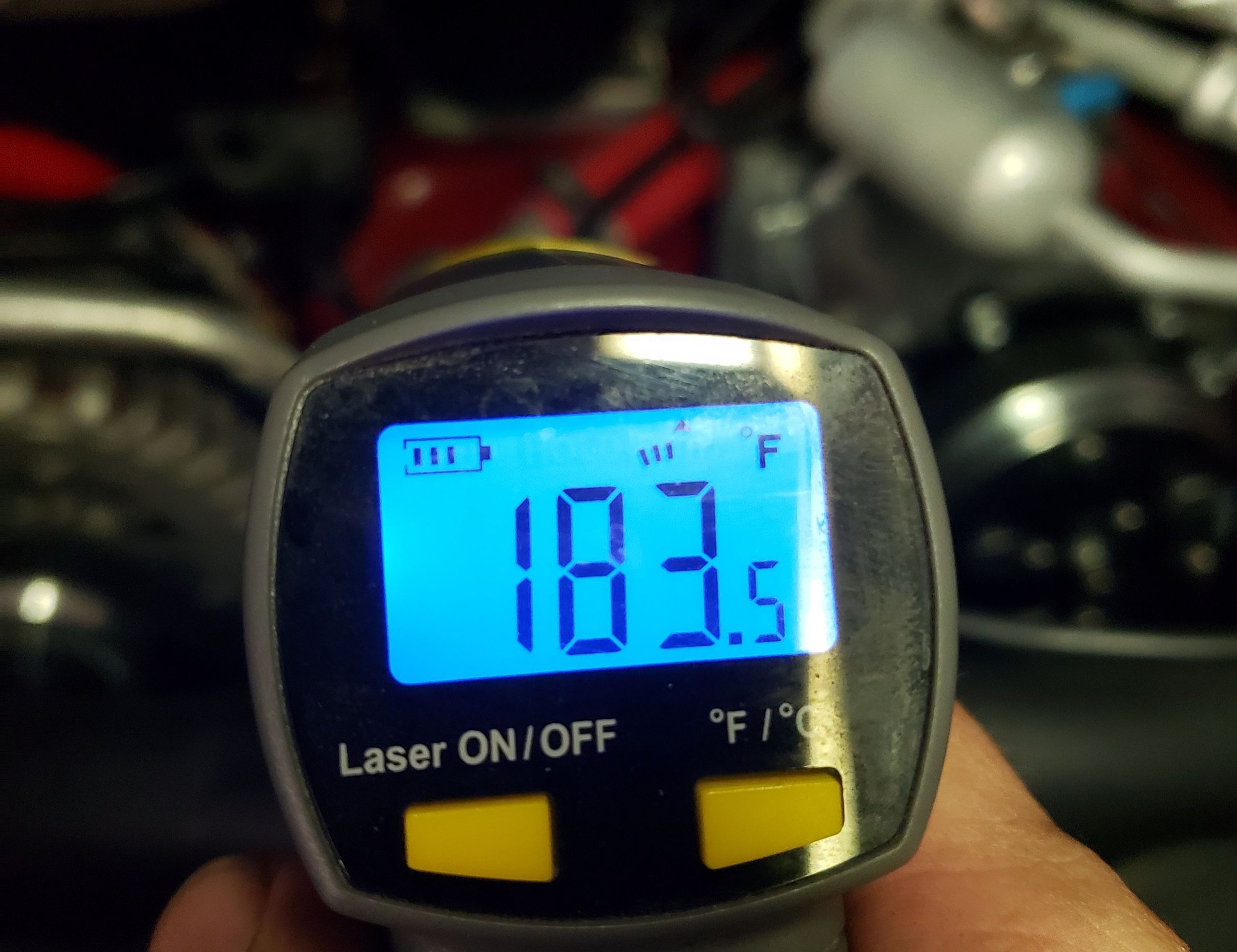

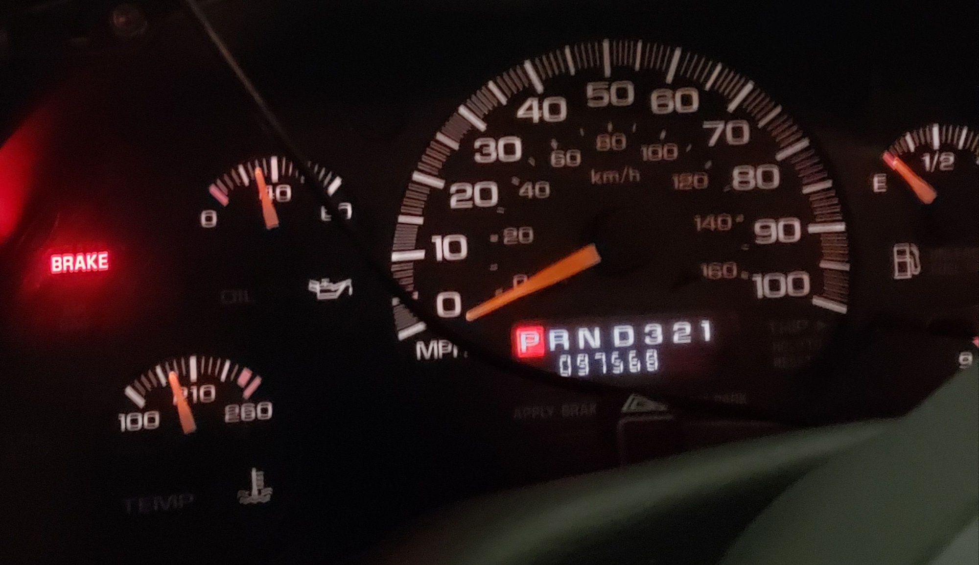

What about engine temps? I heard when upgrading to a higher rocker arm ratio, temps sometimes get cooler since there no valvetrain friction. Is that true?

Never heard of that or experienced it.

You are removing 5+ hp of friction from the stock rockers. The heat produced by the stock rockers dissapates into the oil system. I did not notice a temperature difference because I have an engine oil cooler in the radiator and a large radiator with a mechanical fan. My engine naturally runs cool. It had been idling with the AC on in 102°F temps for over an hour in when I took that picture.
