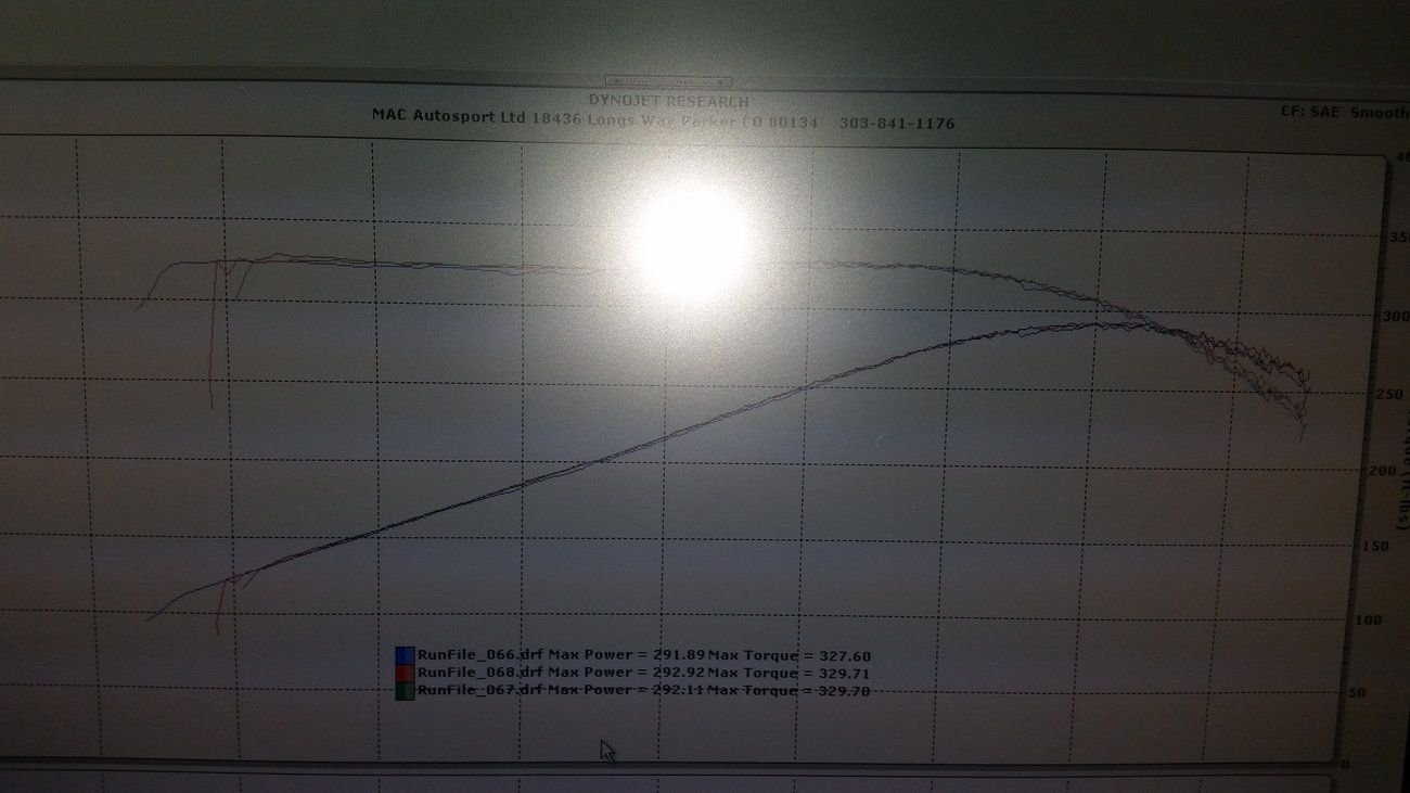

No, I put 292/329 down to the wheels. Fast put down 300. To the WHEELS. Crank HP can be speculated, but only when one has a Dyno sheet to work off of.

Mine seems like a bit of a freak, but I Dyno it annually. That unrestricted Dyno day required a 36mm plate to choke it down to 260whp, now I'm on a 35mm plate. I believe it had the cheater 50mm throttle body in for that Dyno as well. And the car is a 93 with the one year computer. Most cars in my class make 275 uncorked, but then I see folks on here with longtubes and more stuff than me making 260 and being happy about it. All my pulls are on a dynojet with smoothing set to 5. Dynojets are pretty common posts here. I've been to 2 locally and the numbers were pretty much identical. But different brands read differently, so another reason it can be dumb to attempt to speculate your crank HP. I too think the 1/4 mile slip is about the best metric you can use. I don't care if my Dyno implies I have more power than I do because at the end of the day, the rules say I need to make 260 on a dynojet.

Maybe it was a Monday or a Friday car. It still had factory cat, a factory muffler and a standard crank pulley. Your LT1 is a bit of a freak. Then again I think the 92-93 speed density LT1s are some of the strongest runners for a stock LT1.
