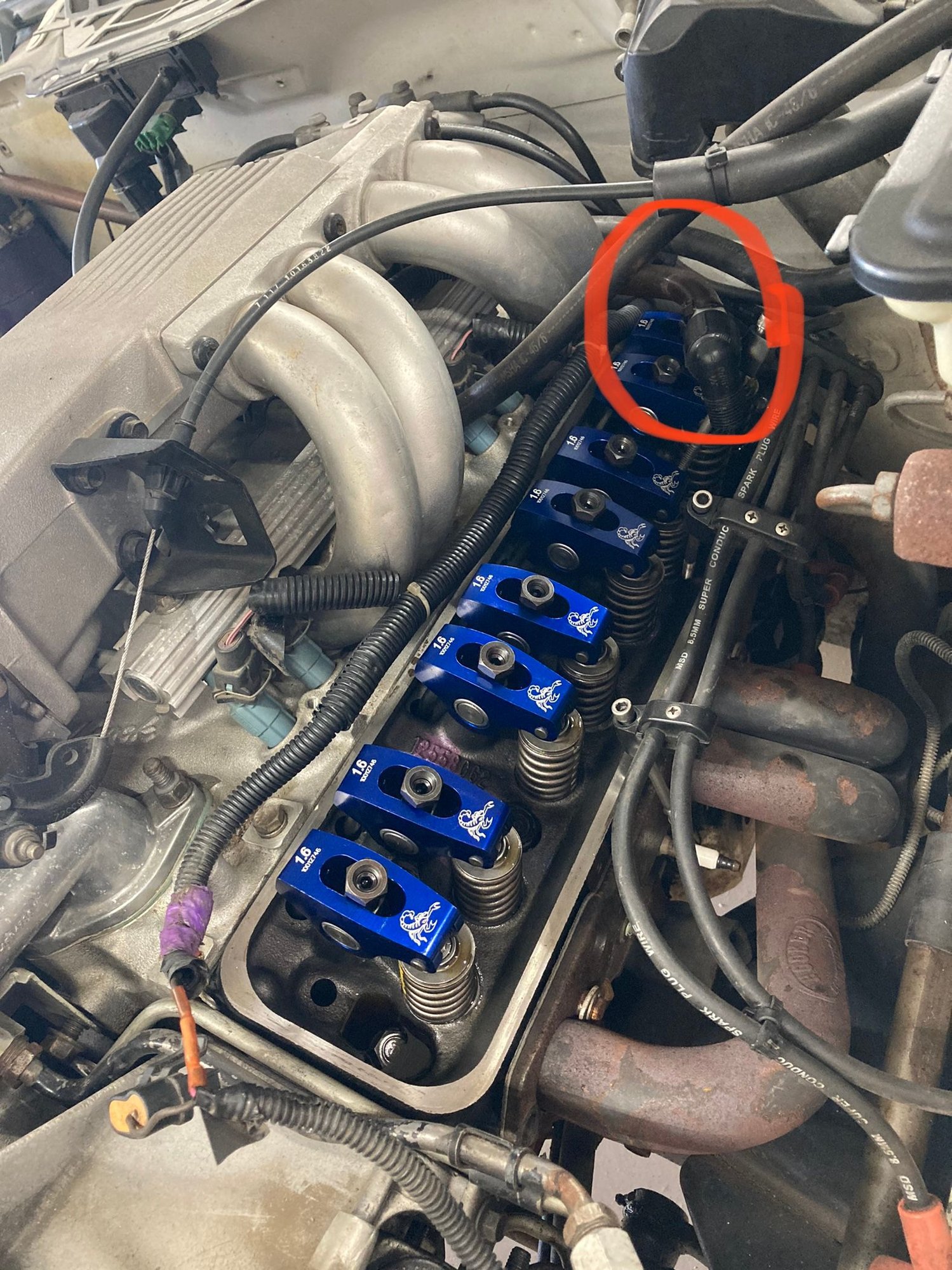

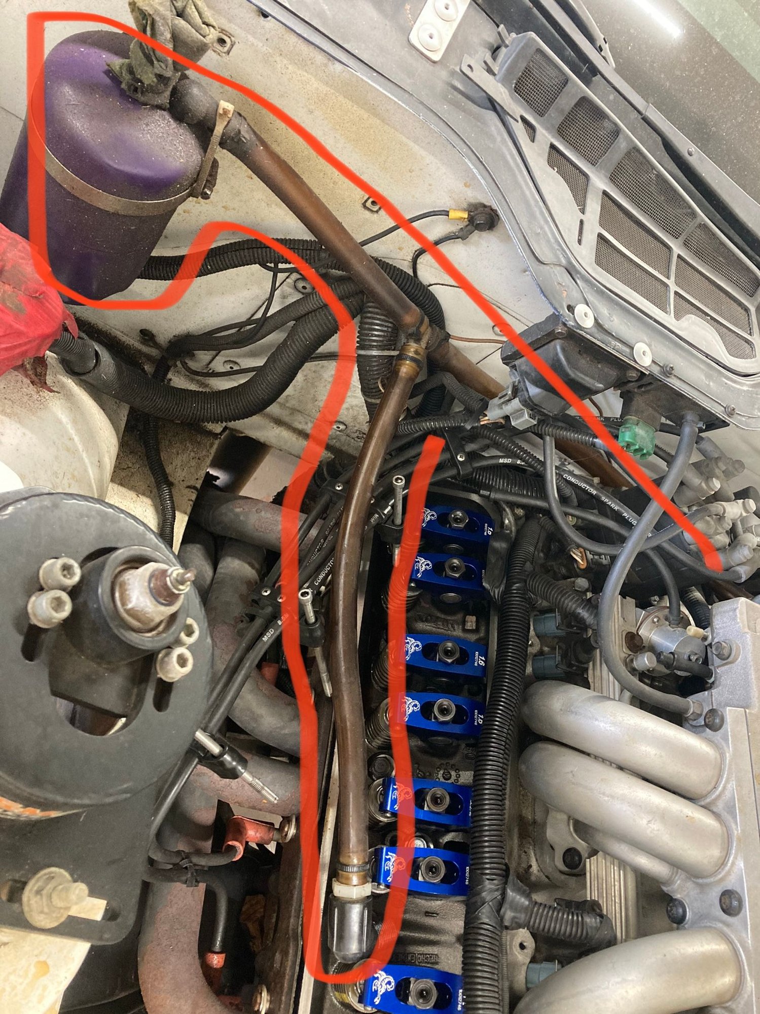

I have a dual ventilation setup from both valve covers to a catch can. These purple covers are being recycled from the TPI.
Passenger side ventilation.
Drivers side. Awe…….say goodbye to those Perty blue roller rockers 😔
I see, I did notice the one cover wasn't a LT1 cover because of the hole (normally driver's side is solid, no holes). Anyway, after posting, I noticed they weren't even bolted on yet....dual feed setup makes sense, I apologize for jumping the gun👍

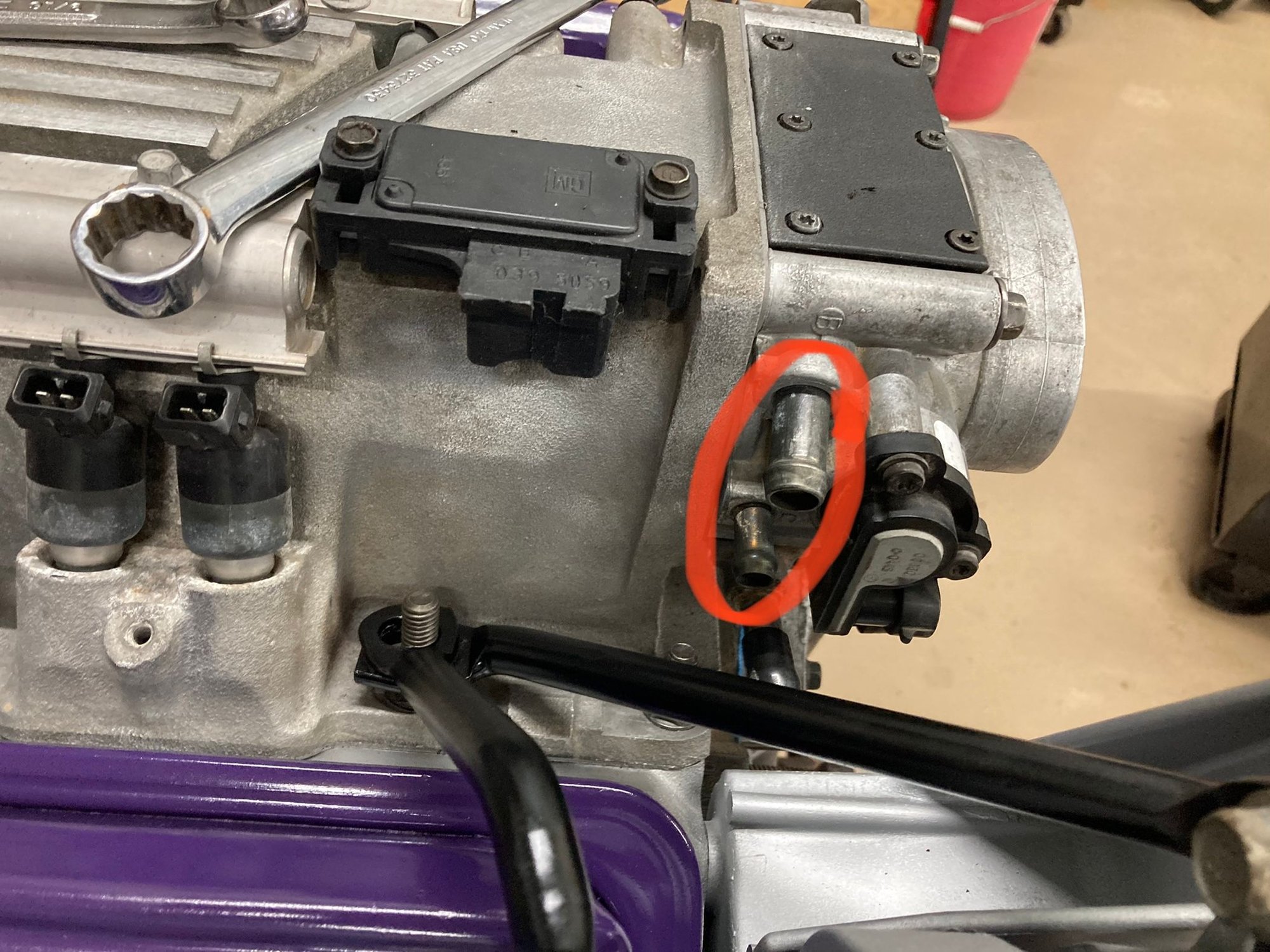

So do y’all think I should still run the PCV valve on the side of the manifold with the metal tube that wraps around and dumps back into the intake? Leave it in place?
what about theses two ports on the throttle body? Cap them off?

The bottom one doesn’t necessarily need to be capped off since it is for coolant to pass through the TB. The top one, yes since that is the neutral flowing passage for the PCV system.
I’ll just cap it all off, even the coolant passages because they are rusted and ugly.

You can just pull the TB water fittings right out, that's the cleanest look IMO. For the 3/4" fittings that snap into the valve covers, toss the pipe thread and get a pair of these. They snap right into the factory rubber grommet.
The top port on the TB is the fresh air source for the PCV, the bottom port is for the canister purge valve.
You can setup the PCV valve like the Vettes, it cleans it up a bit. Switch the opti vent port with the PCV port.

That reminds me, forgot to say you need to keep a functioning PCV valve. It flows under vacuum and the valve cover vents let out blowby. They flow in opposite directions.

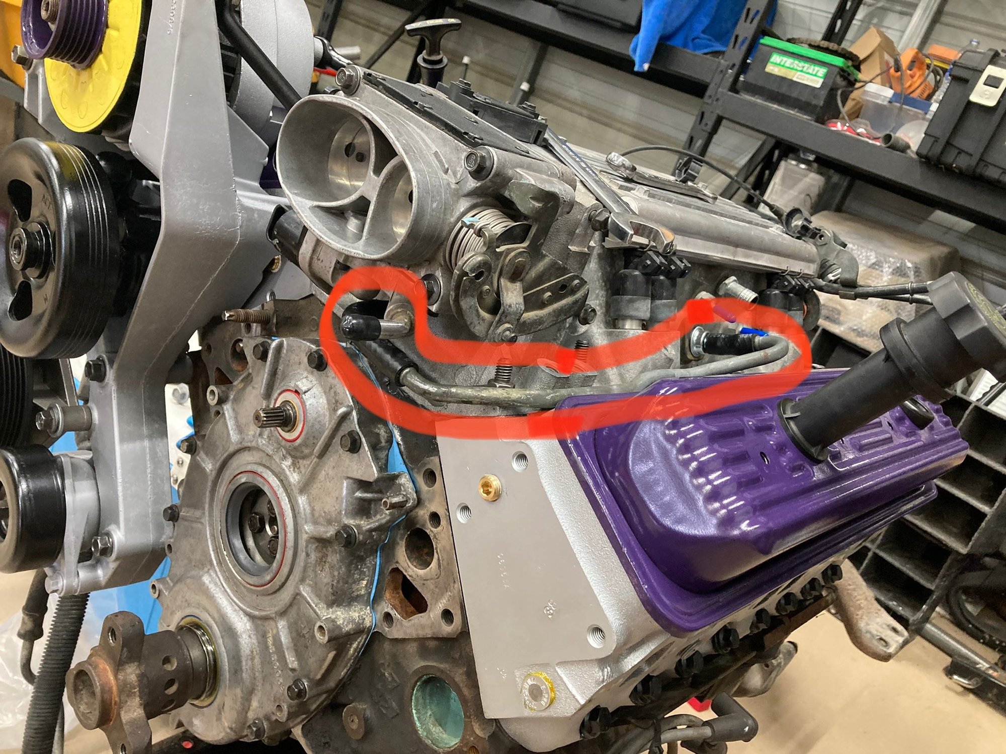

That has me wondering, OP. How is this system of yours ventilated? I see oil residue on the canister. Is it able to breathe? If so, why. Not keep it simple and put breathers on each valve cover?
That is the worst idea I think I have heard. I absolutely hate those breathers. Nothibg like a nice oil film spray to coat everything under your hood. Catch can then into a header evac system on one side. Factory PCV valve on the other. Keeps oil spray out of your intake at WOT and the crankcase under a vacuum at all times.
I know, but looking at the pic of that canister, it appears it's doing that anyway. Yes, when having breathers one must be vigilant in cleaning the surrounding areas from oil spray. Aren't you the one who has the engine bay so immaculate you could use it as a clean room? If so, I understand your point. May not be so important for those of us who are dirty girls!
Embarrassed to say I have not touched that catch can since I have owned the car. It could be completely full for all I know. So, I’ll give some attention and clean it up and see if it’s ventilating.

Running a vacuum/PCV can benefit in keeping some vapors internal, but for his system it isn't necessary. The tube(s) coming out of the VC is a breather tube and is neutral flowing.

Cleaned up the catch can. It is vented but used a shop towel as a breather. Maybe I’ll vent it out through my exhaust using an evac port near the manifolds. Too easy. It had about a 1/2 pint of oil in it.

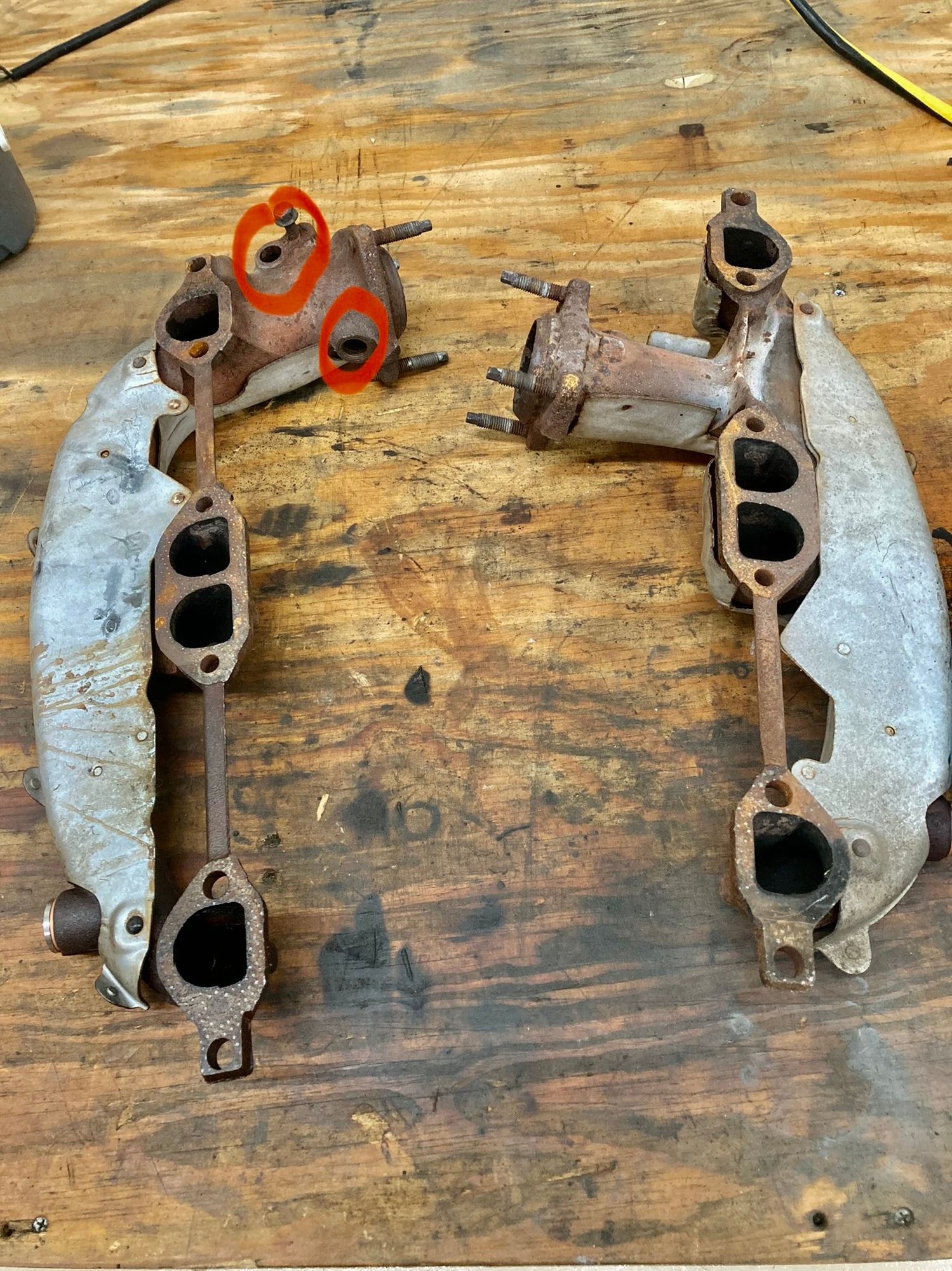

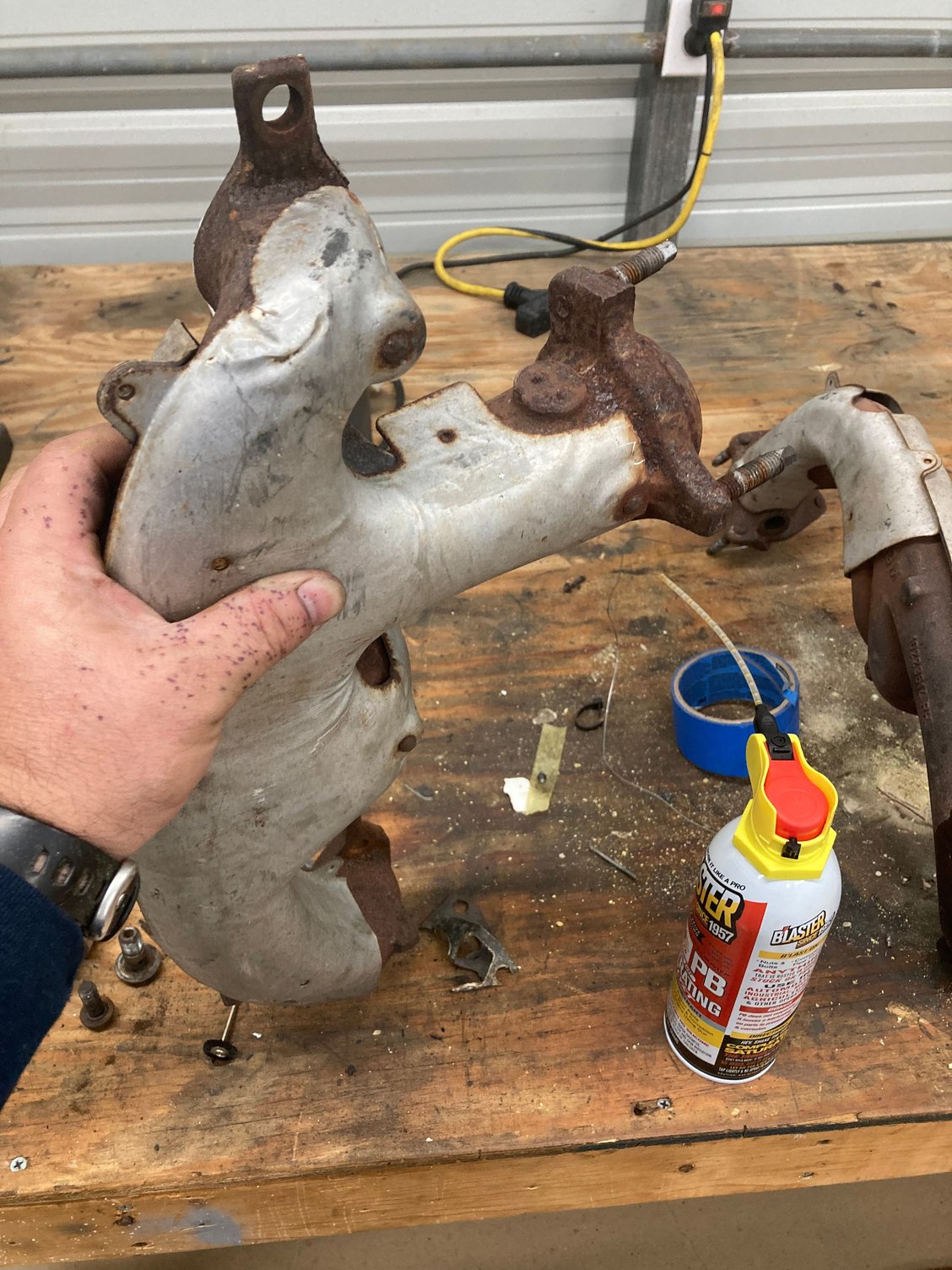

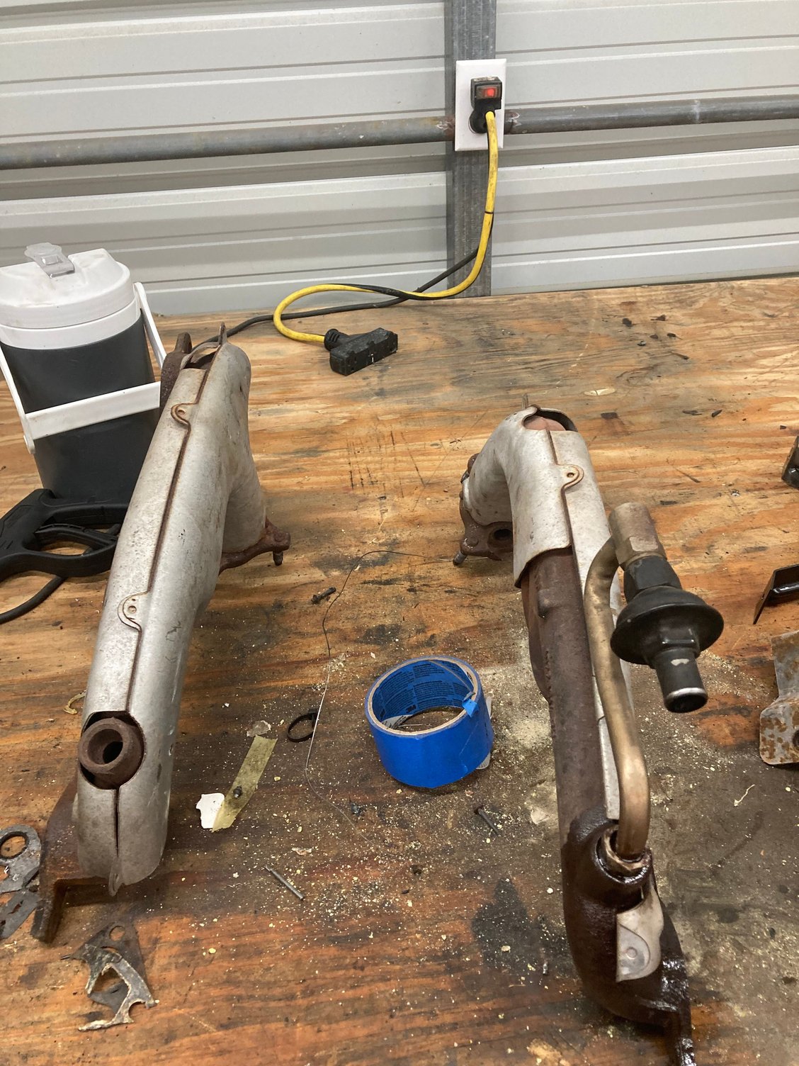

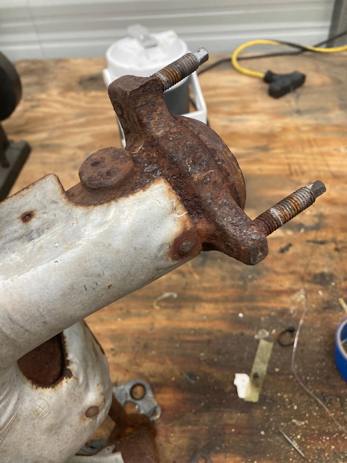

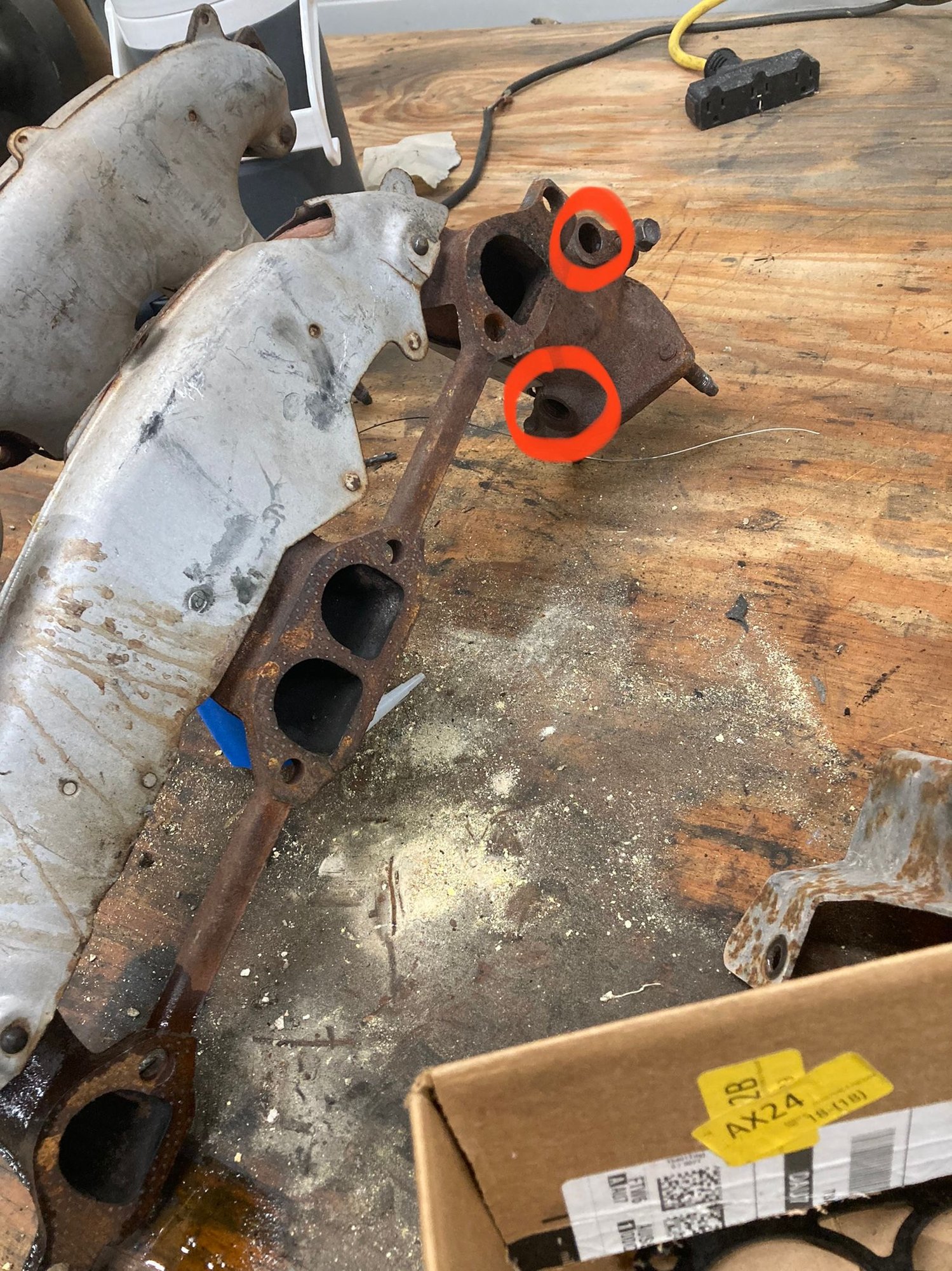

Default O2 sensor locations
My passenger side exhaust manifold has a place for an O2 sensor but the drivers side manifold does not. Is this normal? Am I gonna have to weld in a bung in my exhaust? My TPI only has one O2 sensor in the drivers side. I’ve searched and have only found that the 1995 has three O2 sensors (2 that actually used for air/fuel ratio).
Passenger side O2 bung and EGR port.
Drivers side no O2 bung
Drivers side

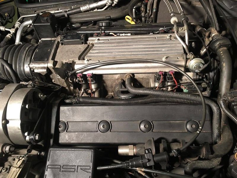

If you post some detailed pics of your setup with the 45 degree ports and whatnot I’d love to see it. Hey Supercharged, is this legal?
Wish I had some good pictures of it. Being in a van its a complete PITA to get clean pictures. This is the basic idea. It just has two check valves, one in each exhaust pipe. My catch can is on the frame rail.
have you tried just 1 bank only? or was there a stronger signal with 1 in each bank?

Yes you'll need to weld a bung in, but you should have some exhaust from the donor for this no?
