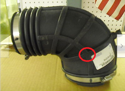

Looks like the ones with the opti intake hole are harder to find. Drilling a small hole where the ribs cross each other on the top of the elbow might be a good work around to install the opti intake hose. Just don't drill it too big....start real small and go up. Below is where I would put the hole. Also make sure the opti hose does not stress the intake hole. Don't want it to tear the intake. I think the ribs will be the strongest location for it...so hopefully won't tear easy.
I do see the dorman one....none of the freaking pictures of it show the top of the thing.
