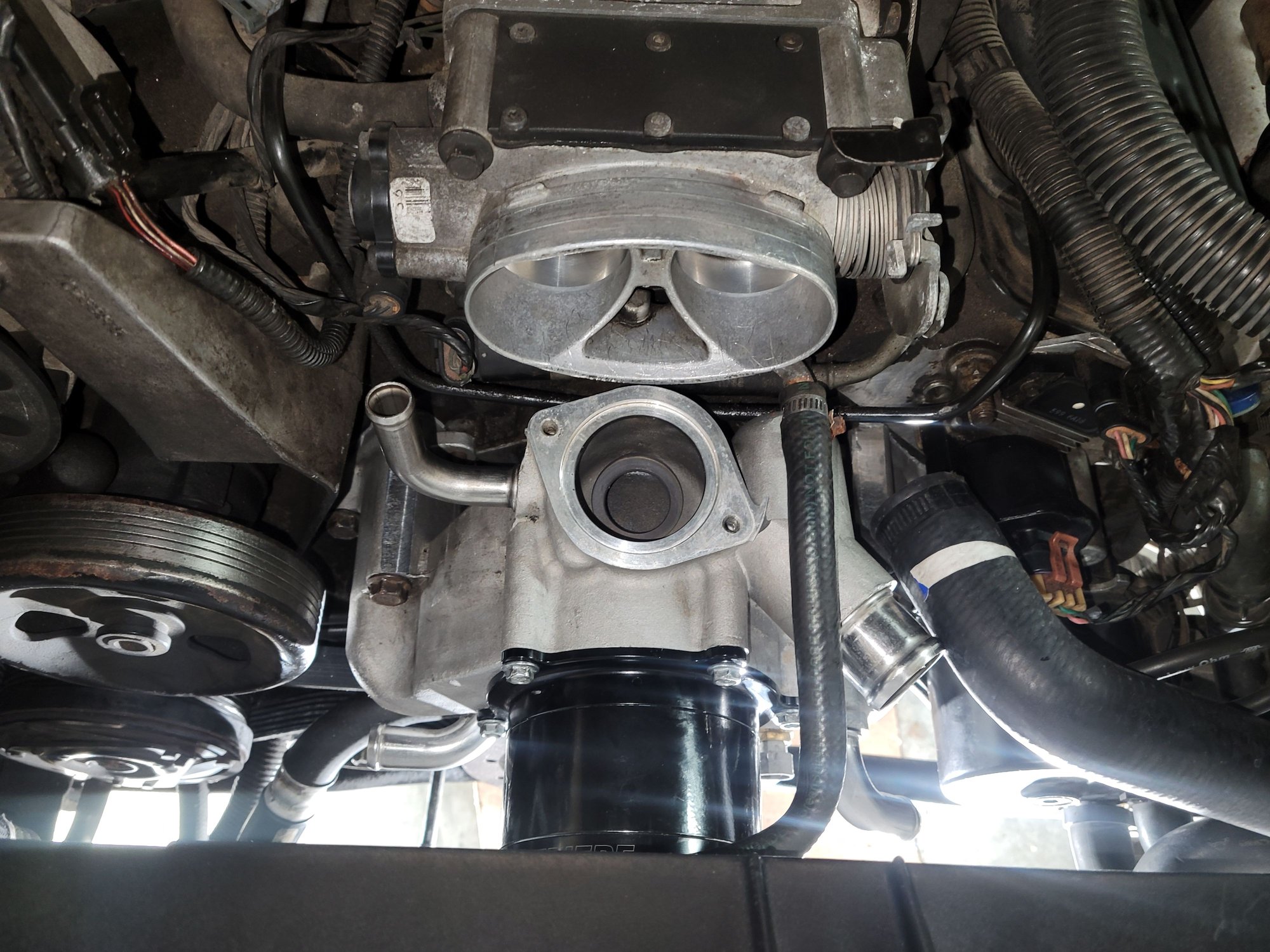

I got everything buttoned up and running. Just have to get more coolant and bleed the air but the fan was running strong. I wish I could have hid the wires a bit more but I'm not complaining! Had to trim the fan shroud a decent amount but its not noticable unless I tell someone is did. I appreciate everyone who helped me with this process! Hopefully I don't have to worry about my water pump failing for a while. If I remember I will reply with how the first cruise goes! Thanks again!
