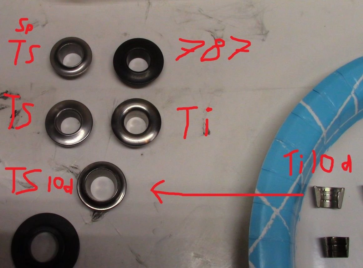

Some examples from a vid clip that I may someday finish for my channel. TS = Tool Steel

Years ago, I ordered 787-16 retainers and Comp accidentally packaged 10 degree versions. I still have them on a shelf somewhere.
Tool steel is the way to go these days. It is only a slight weight penalty over titanium, but has the wear characteristics of a standard steel retainer.
