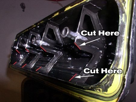

You will need to make a minor valve cover mod by trimming the intake side of the X brace.

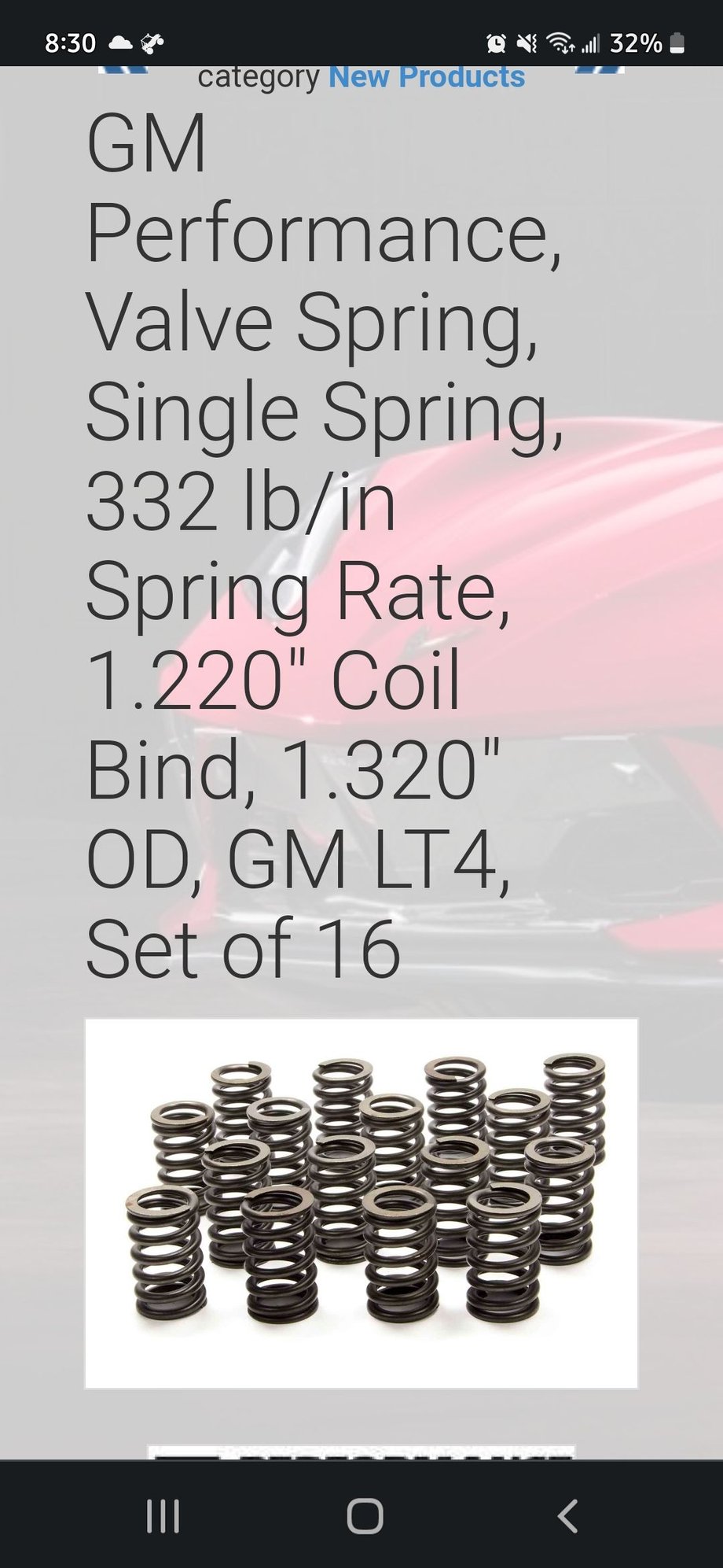

Found a set of LT4 springs online. All specs appear correct except for spring rate of 332 lb/inch? From what I've read it should be in the 130ish range?

New or used, where'd you find them? New LT4 springs are around $500 now. Ridiculous.

Found them new on a vette site for $62 plus $40 shipping. So you're saying that's a good deal then?
