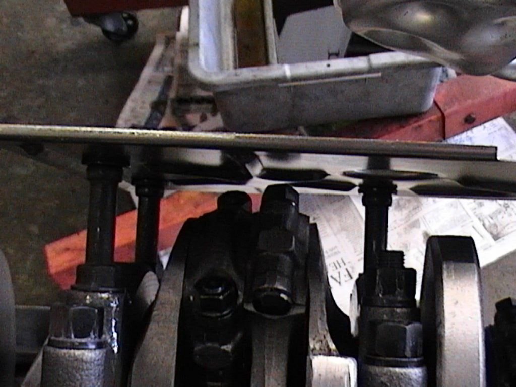

BALLSS's Avatar
Joined: Apr 2008
Posts: 4,985
Likes: 112
OP
I have the Scat forged 1 piece RMS using Scat 6" rods, SRP pistons. It's in a Golen 383 shortblock. Chad replaced my initial 383 when the Eagle cast crank became a 2-piece crank. He replaced the block also. Have had it about 15 years now with over 45k mi on it.
Have the rotating assembly neutral (aka internal) balanced. Then just use a stock neutral balance damper...or I chose the ATI. Get a neutral balanced flexplate BUT absolutely have it checked that it is in fact zero balanced.
I had no cam clearance issues with my Comp XFI. You will need to clearance the block for rod bolts in a few places. Locations will identify themselves on mockup rotating motor by hand. I did use my stock windage tray by using 1/8" washers on the 3 main cap long studs and one on the oil pump bolt to stand it away from the crank. I also use stock pan. Audition it without gasket and rotate engine by hand with ear to the pan. You will likely need to clearance near #2 rod. There was just a slight scratch on inside of pan when I did (rod bolt) it which would have likely cleared with the thickness of the FelPro pan gasket, but I gave a little more clearance by using the big end of a wood baseball bat pushing on inside of pan that I put on folded towel. Worked perfect.
