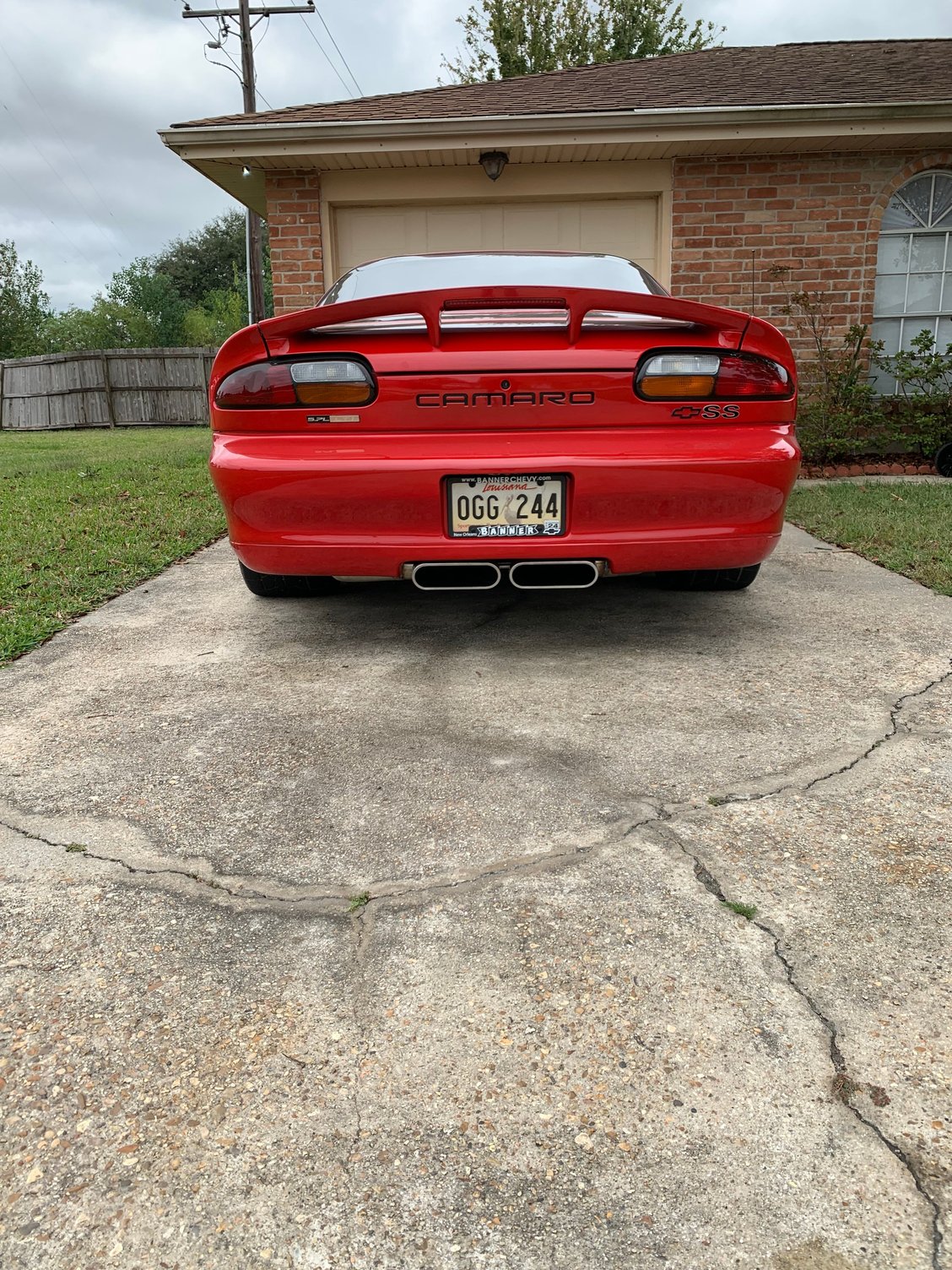

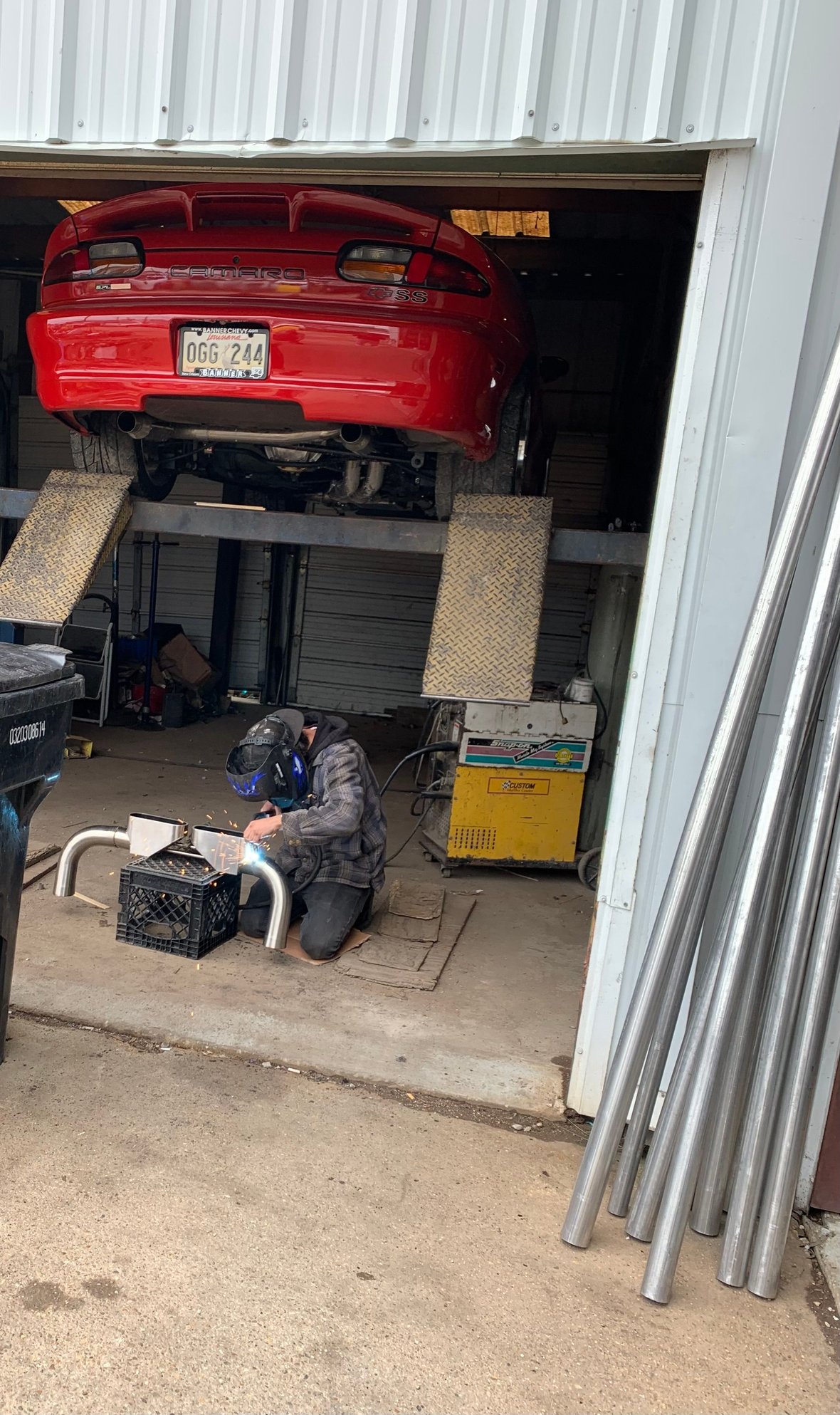

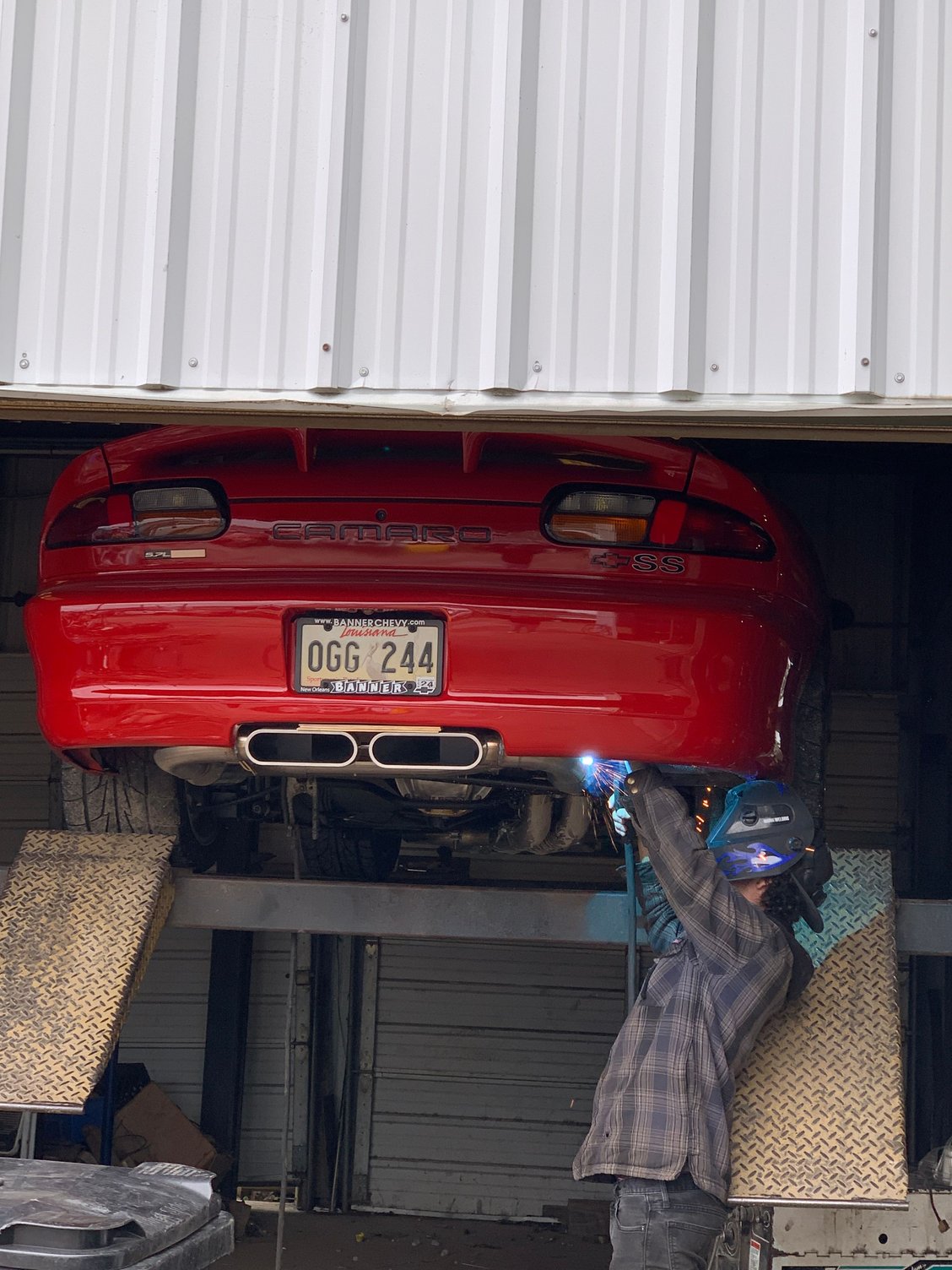

Modified Speed Engineering true duals on my ‘94 with CME

Does anyone have a picture of a camaro with corvette style tips?
Old May 1, 2023 | 02:26 PM
Rob94hawk's Avatar
Joined: Aug 2010
Posts: 1,664
Likes: 28
How's the ground clearance?
Old May 1, 2023 | 06:20 PM
cino's Avatar
iTrader: (28)
Joined: Dec 2005
Posts: 281
Likes: 110
Blackheart system ground clearance is better than stock system.
