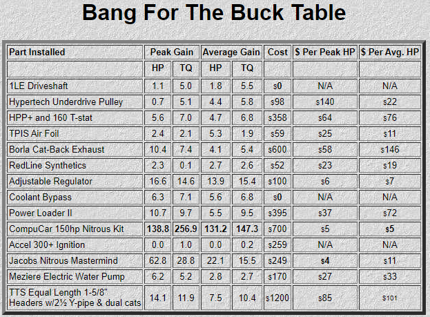

That is a very respectable build. Though for stock heads that sounds like thats pretty limiting with a cam, even with the cc503. A quick google search brings me to some other forums saying that similar builds like yours net around 330 to 350 whp. I would recommend finding a way on deleting the Opti spark eventually as acdelco isnt making them anymore and youre left in the hands of questionable aftermarket companies. Though if you're not going through them every month then it wouldnt hurt to hold off for a while.
Here are some nice dyno proven numbers that should give you an idea on how much those other little mods such as the air foil and the throttle body coolant bypass did
