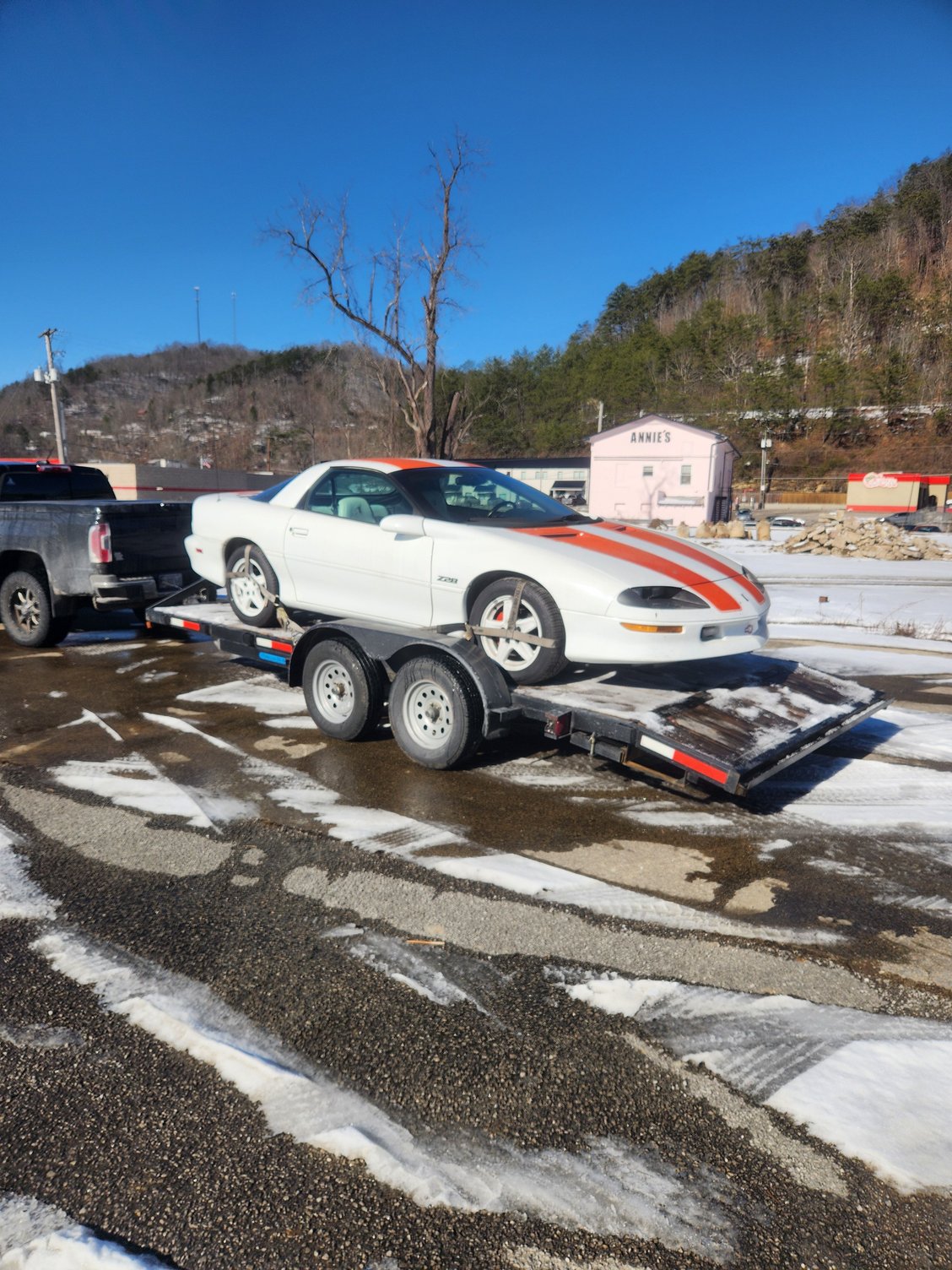

I just bought this beauty with a spun bearing. Got another engine, put new opti in before installing. Mistake #1 I didn't know I should only use ac opti. I did all diagnostics shown on here. I have no signal going from opti to ecm. Mistake #2 I broke the retaining clip on opti harness at opti plug. Also have no high res signal. Any chance a new harness might be the answer?
