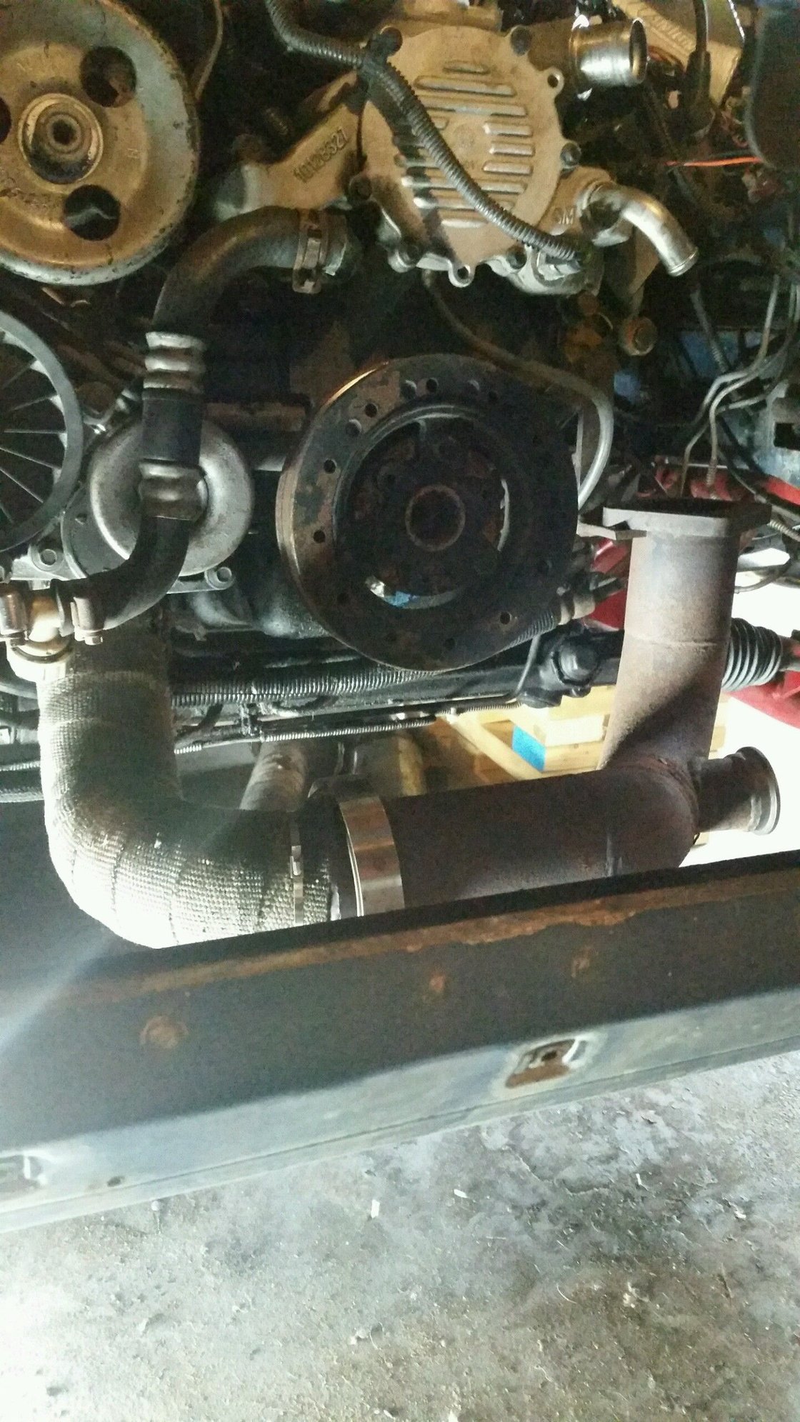

I can see that drainage tube... great idea!
This is an oil leak, minor, but annoying none the less.
It will be the first task come spring, along with new AC overhaul.
