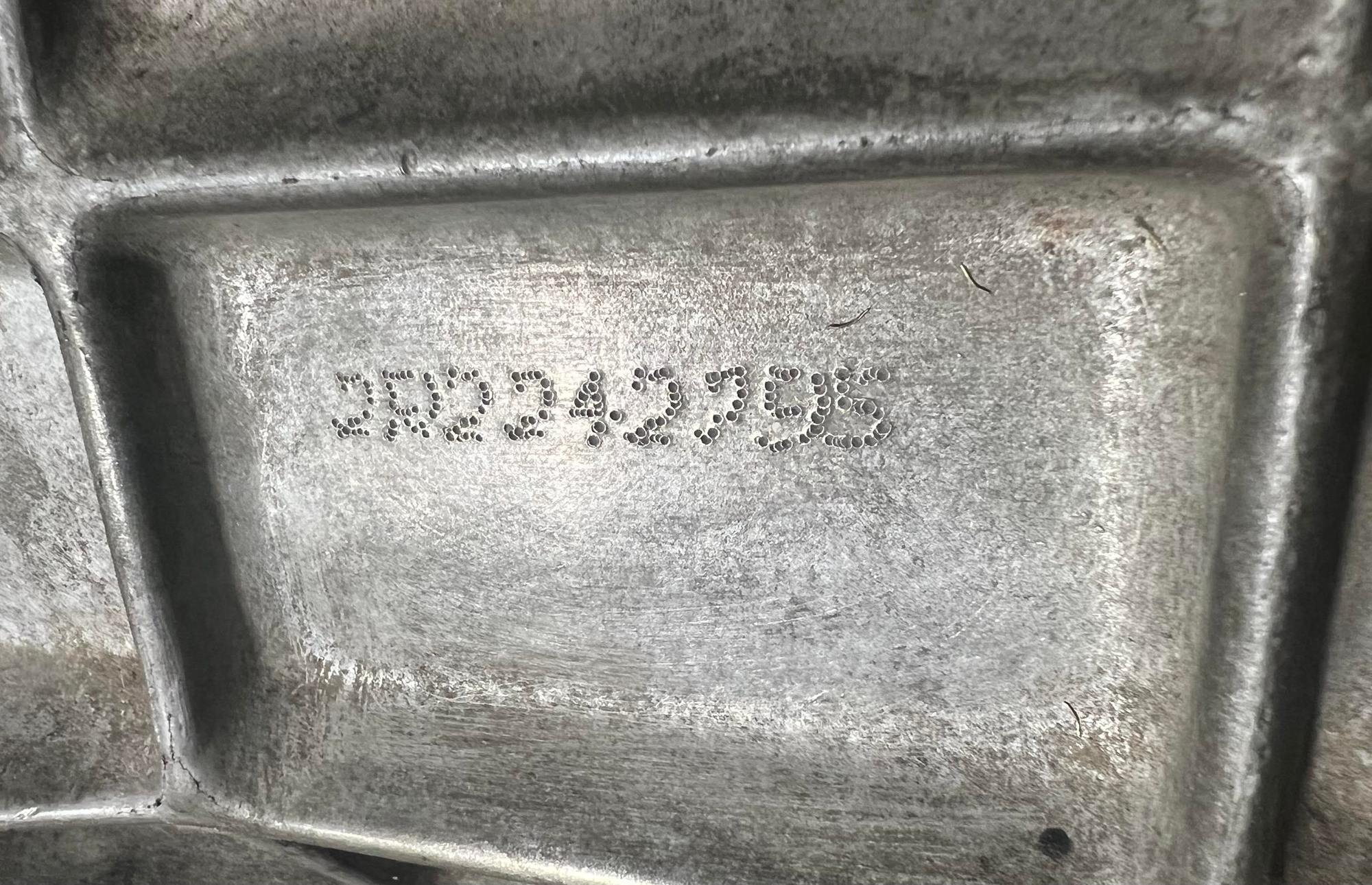

Thanks to everyone who helped
I finally found the VIN.
It was where many people suggested.
It was on the transmission housing where it bolts to the motor, just above/next to the oil filter.
I had looked there and felt for it and nothing.
I used a degreaser and there it was.....stamper with the dotted pattern stamping.
Thank you everyone!!!
