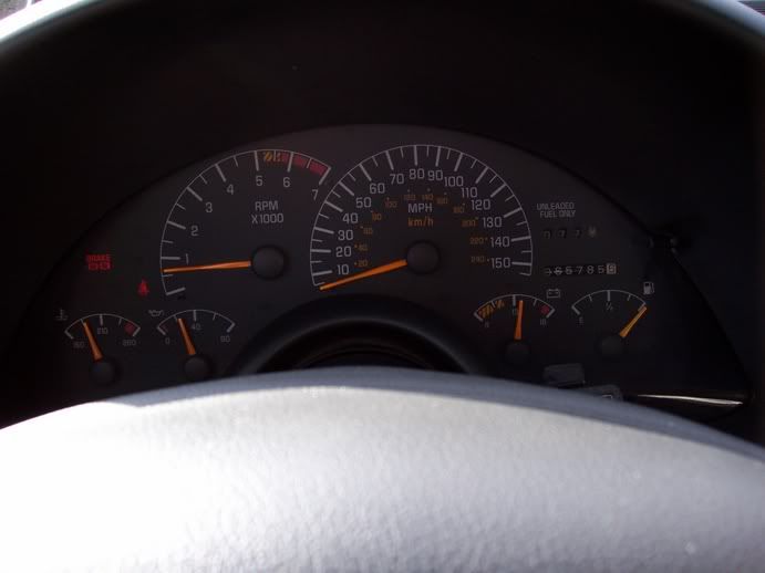

Here's my '95 dash. The '97 would have the digital odometer like zlover said. Both interiors are great tho unlike '93's which IMO look nasty.
